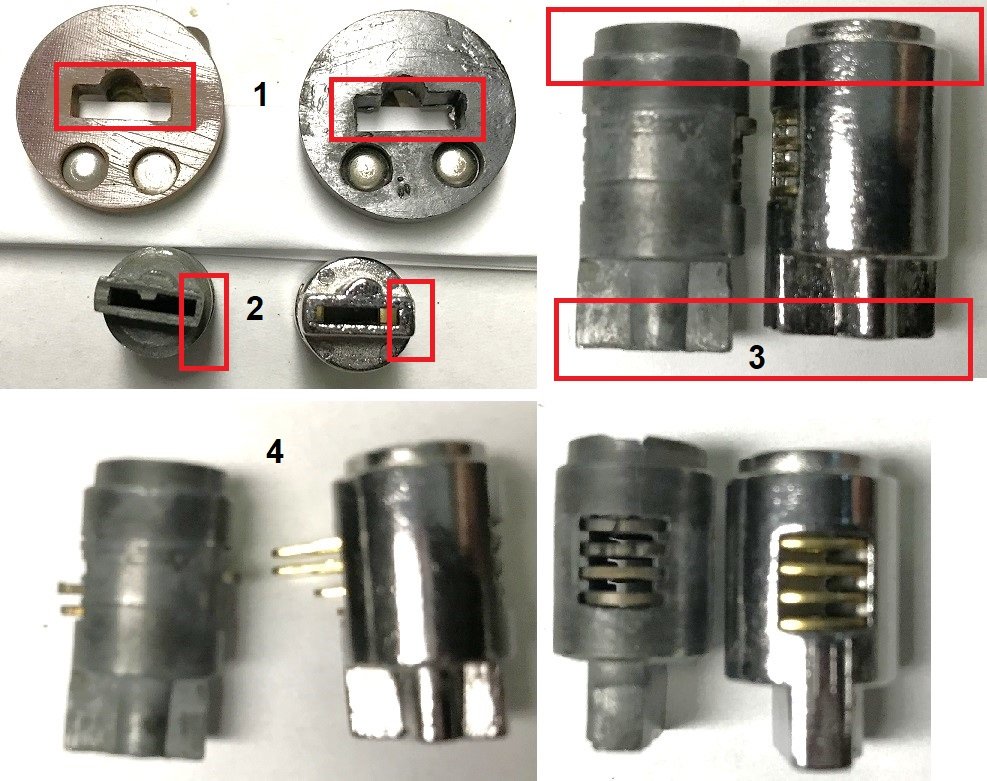

Here are some differences in the tumblers
1 the end of the repro that goes into the small contact ring for selecting MAG or BAT is slight wider & thicker
2 one edge needs to be trimmed to allow it to rotate from side to side to get to the stops.
3 the lengths & diameter are different. The diameter prevents it from fitting into the cage
4 the design of the switch does not hold the wafers in place when the key is removed. As a result if the key is removed & the tumbler is turned upside down the wafers will fall out. A specific cage is designed for this
There are two types of cages. One type (two variations) is for tumblers that would have wafers fall out if the switch was turned upside down and catch the wafers. The other is for tumblers that were constructed to not allow the wafers to fall out
The one on the left is the catch type. Note that each is orientated properly: Tumbler in cage and cage in cup with respect the the cup
