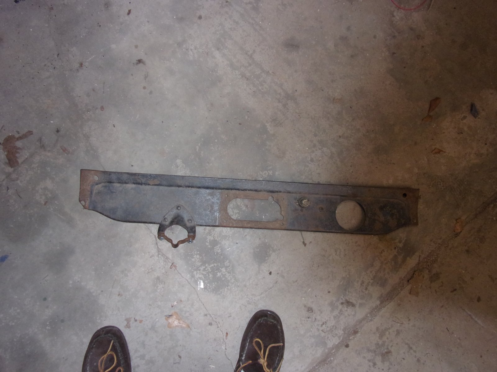

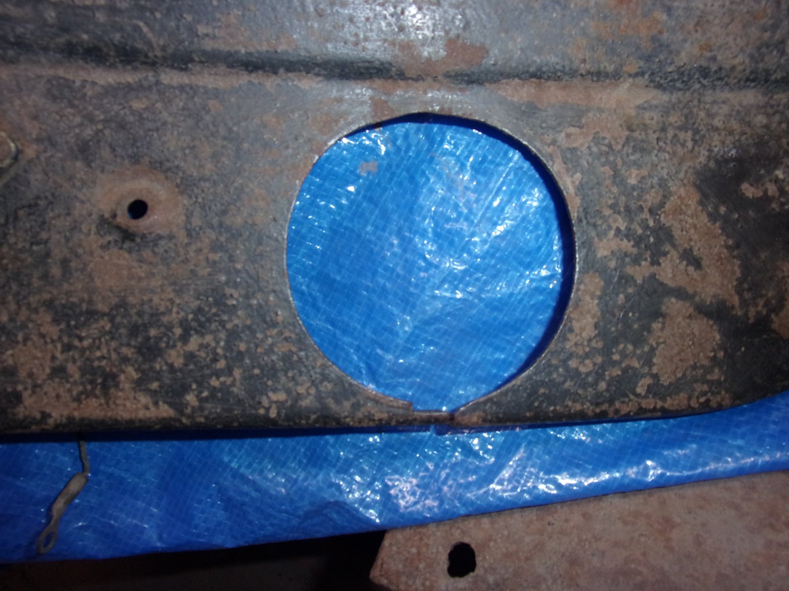

I'm sorry, I thought I mentioned the hole size and a pic and realized that that information was supplied on the "Help ID " thread on the GD board. My bad. The hole size is 3 1/2" in diameter with a small rectangular tab slot at the six oclock position where there is a small split in the panel that will get welded up if I end up using it.
This is a metal panel that will be attached to a wooden cowl that I need to create to transition from my wood firewall/hood former to replicate a metal cowl appearance. Another story on another thread. So, I can attach this panel to my wooden cowl frame in any fashion such as wood screws. The steering column blamp will be mostly cosmetic and s my 27 steering column is attached to my wood firewall/hoood former with the angled welded on bracket and carriage bolts.
Hope this helps. I do not feel any mounting screw holes for a former speedo installation.

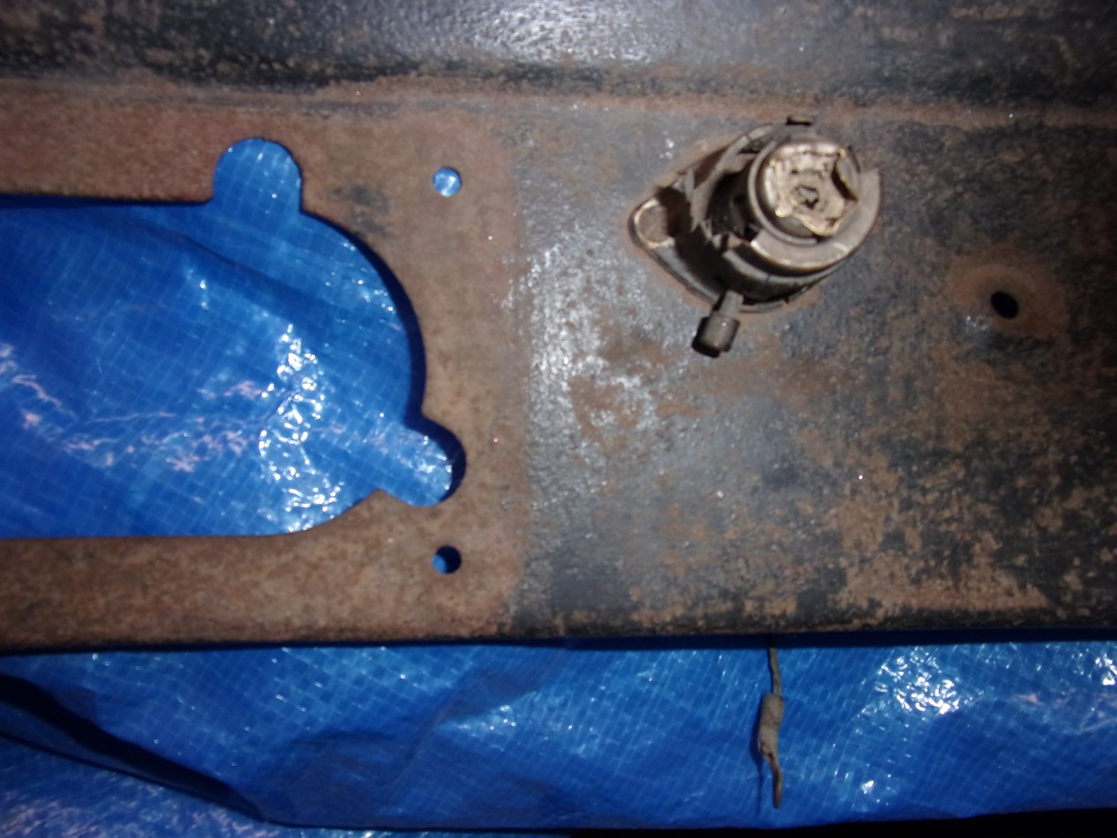

- Posts: 5581
Re: WTB hole filler speedo and accessory dash light.
Most likely an AC speedometer head was in the hole - they have 2 studs on the rear & a bar type holder. The dash lamp appears to be an original Ford accessory lamp - measure the "minor" diameter- I have some assorted covers.

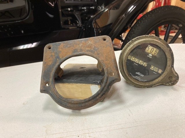

I'm baaaaaack....
Trying to figure out how to mount square speedo into round hole. Well, not exactly, received a Stewart speedo with a mounting plate and would like to install it for appearance only. Round hole in metal dash has no drilled holes, so I know some drilling is in my future. But, speedo has offset odometer reset knob that needs to be accounted four. There is a faceplate/bezel that may come off the speedo and than reinstalled after passing the sppedo through the back of the metal panel. But I'm just not picturing how this speedo gets sandwiched with the mounting plate and the detal dash panel and in what order do items get installed?
I can remove the dash panel from the firewall and mount on the bench and it will not be functional. But I don't want to start prying apart glass and bezels that should not be pryed apart.
Any guideance appreciated . I can take a pick of the speedo and mounting plate, but this dash panel in this thread is what I am using.
Thanks in advance. I realize I am probably using speedo salad and Frankendash, but I'm using what I have, not what I can purchase.

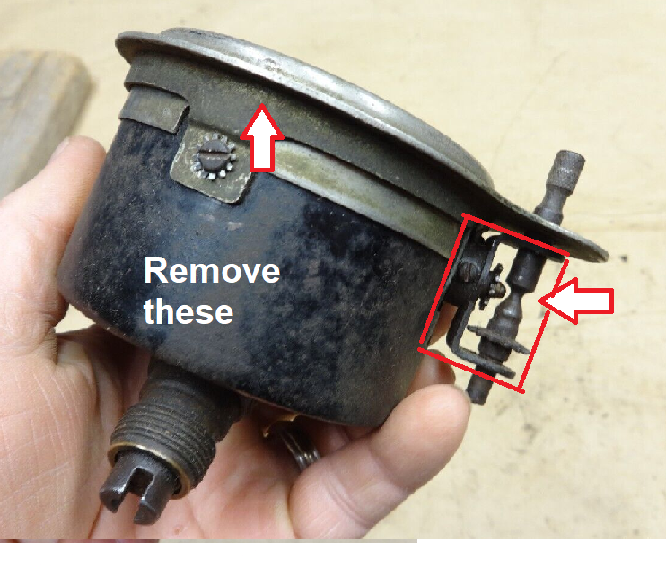

- Posts: 6577
Remove the the nickle bezel & the trip odometer external parts (don't need since speedo is for looks) to see how things will fit in the bracket or the dash. You can make an L shaped bracket to hold the speedo to the dash or bracket using the screw positions that were for the nickle bezel
