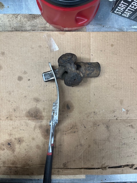

I repurposed a broken channel locks

That’s a good idea! That’s better than tying up the joint with a piece of string that I used!

I set a jack stand under the driveshaft tube prior to pulling the engine so it's pretty much lined up for the re-install..then I help hold the U-joint in place for the final "slip in" with a simple coat hanger...the curved part that hands on the closet rod. Works great!John kuehn wrote: ↑Sun Mar 03, 2024 6:06 pmThat’s a good idea! That’s better than tying up the joint with a piece of string that I used!

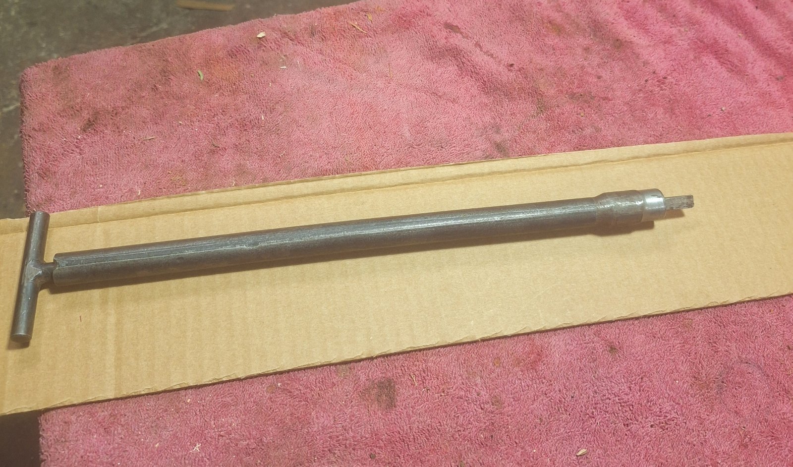

We recently reinstalled our rebuild motor in our T. The rebuilder told me that if you turn the universal so there is a corner at the top, it would be easier. It was a good suggestion, and worked well.
The pictured tool would keep your fingers our of harms way and may be better solution.
Nick
Nick
