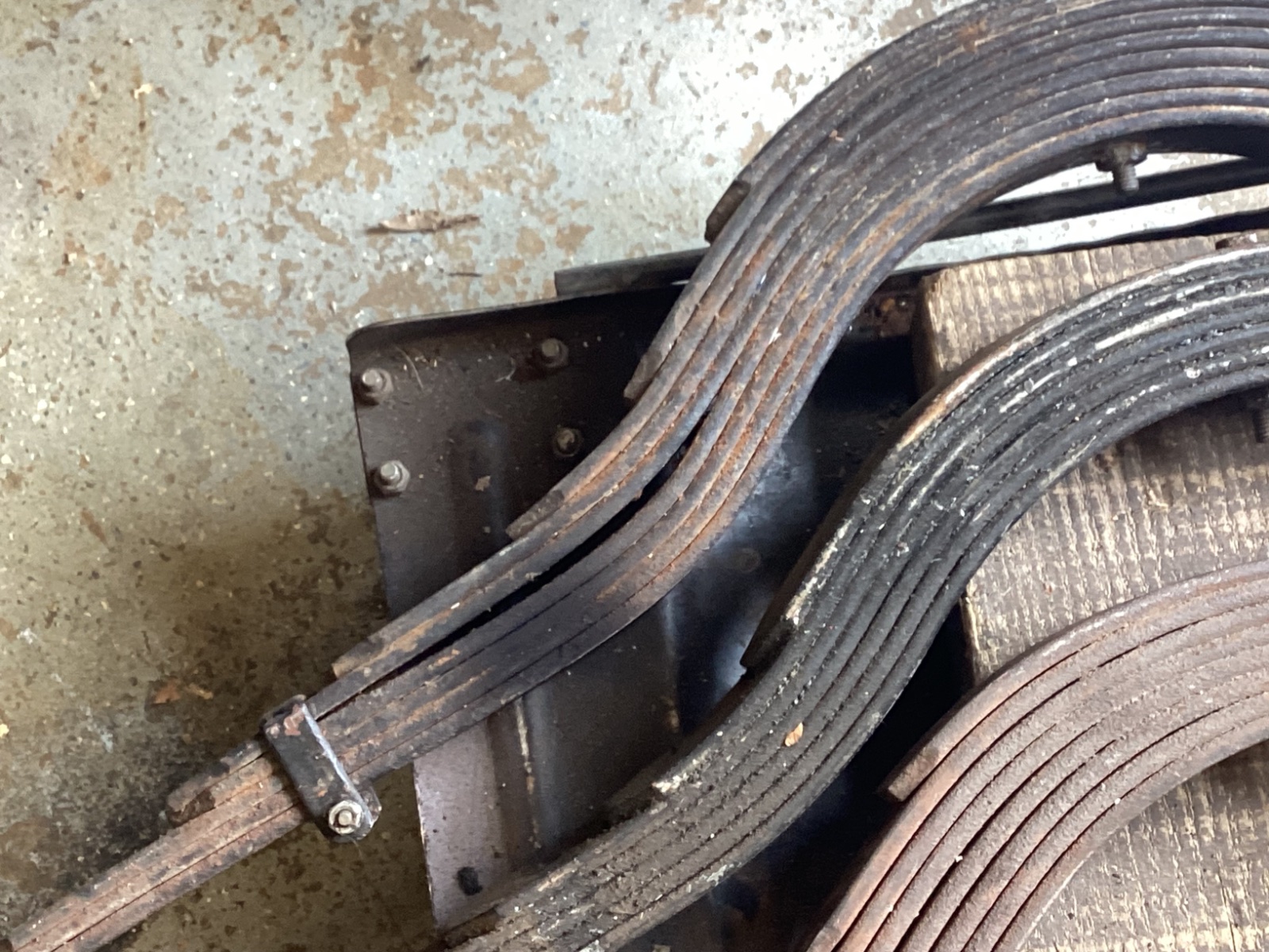

I have a 9 leaf rear spring pack that appears to have just had another of the third spring from the bottom snuck in there. The clips are longer and go around 5 of them so it’s hard to tell when where or who did it. The clamps to the crossmember are longer as well. Perhaps you could add one in there and another of the almost flat ones at the top to accomplish the rating you need? Nothing looks worse than a truck that’s higher in the front, to me anyway. Could add pics of the 9 leaf if you like. Good luck, big bus sounds like a fun model T! -Chris, in Boulder

Please post a pic!

Just adding extra leaves is not the entire solution. There are three curves in a long rear spring leaf. As soon as you try to add another, it upsets the stack and they will not necessarily fit together well. Each leaf needs to be worked on so that it properly fits. Adding an extra no 3 leaf means all the ones above need to be re-arched for correct fit.
Front springs are a different matter. You can add to that stack as you wish.

Re-Arching the springs above an added one wouldn’t be that time consuming or difficult, but left unchanged, it would result in an unsafe situation where the spring are slapping when un loaded and could shift or break. For a car that beefy, ( and valuable) I’d probably have a new spring pack made from scratch by Eaton. Or at least a new main and then make a stack of ten that fits nice. Sure hope you find something that works, it’s an iconic vehicle to say take least!
Allan is right though, the stacked up spring does have a gap where they do not fit together correctly. I had forgotten about that actually, but it did close up with the weight of the car on it. The little r.p.u. was sure bouncy with that in there. I figured “ it’s a truck, so I should jack it up, right?”- it only stayed half a day!Re-Arching the springs above an added one wouldn’t be that time consuming or difficult, but left unchanged, it would result in an unsafe situation where the spring are slapping when un loaded and could shift or break. For a car that beefy, ( and valuable) I’d probably have a new spring pack made from scratch by Eaton. Or at least a new main and then make a stack of ten that fits nice. Sure hope you find something that works, it’s an iconic vehicle to say take least!
