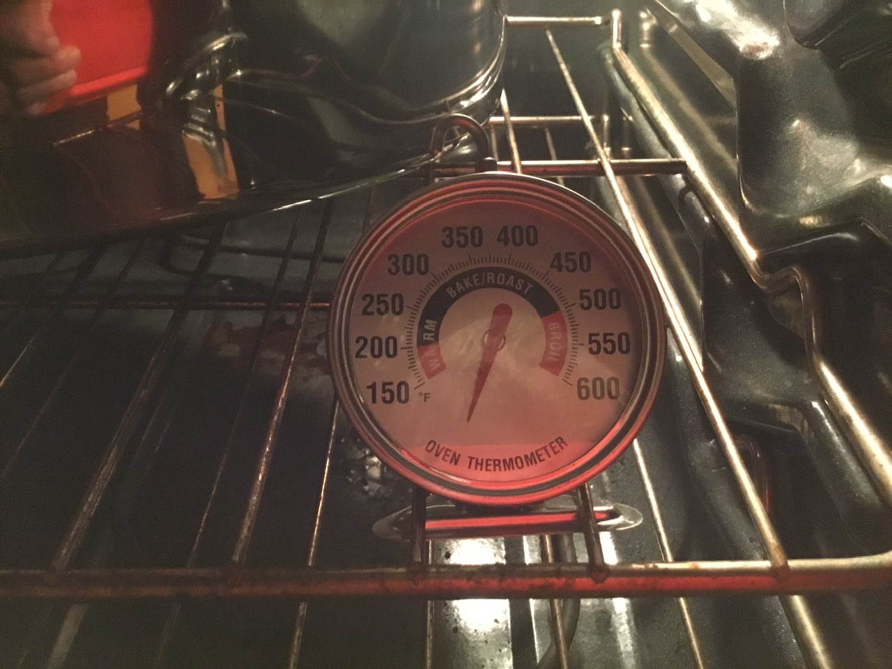

I think trying to chip it out will break something. What is the melting point of the tar? Since it was poured in at one time without damaging the components, you should be able to melt it out using the same degree of heat. Set your oven for the minimum melting temperature of the tar, set the box on wooden blocks at a tilt in an old bowl and allow it to melt out into the bowl. That way, when you have repaired it, you can reheat it and pour the same amount back in. If you don’t know what temperature to use, start at 150 degrees F. If it doesn’t melt at that, go up in 5 degree increments until it starts to melt. It would help to have a visual thermometer in the oven to monitor. Jim Patrick

Tried the Bar-B-Q idea @ 150 degrees no movement was noticed. I kept increasing the heat a little at a time. The tar started to move @ 500
degrees. but did not melt all of the tar out. It did how ever destroy the wood, the connections & the bake-a-lite parts & melt out all of the
solder leaving the coil a complete loss. Good news is I have 1lb 10 OZs of high temp tar/bitumem for sale if you rebuild coils. :lol: & the high
tension coil wire cover that I didn't leave on the coil for a Atwater Kent model K 2 coil. & can know show others where everything in the coil
box is if you want to dig the tar out with a screwdriver. :( Somedays this hobby is not as much fun as others.
