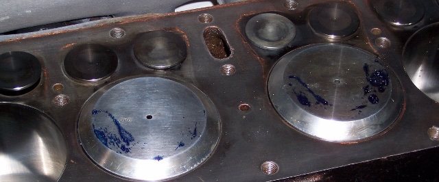

Anyone interested in finding out what the compression of a new 8:1 Prus head is in PSI?
If you didn't see the multiple times I used bluing to check for interference with the pistons - run through the playlist.
I believe there are two videos where the pistons hit the head (Z head was worse "bang" just to be fair).

I wonder how many other Prus head users have encountered clearance problems ? Its strange that I haven't seen or read any other posts to that effect on the Forum. Since there are replacement pistons made by more than one manufacturer and different head gaskets available, both New manufacture and New Old Stock, as well as USED, I can see where there could be enough clearance issues to cause a problem; its just odd this comes up so rarely, if ever, before. The other clearance problem is the one that John mentioned in the post after mine; a block having been previously decked. since the block in question was not a N.O.S. block, there's no telling whether, or how many times it might have been decked.

I have not had any fit issues with Prus heads. I have not tried one on a block decked 1/8"
I have had interference issues with every Z head. Thats from inconsistent combustion chamber castings.

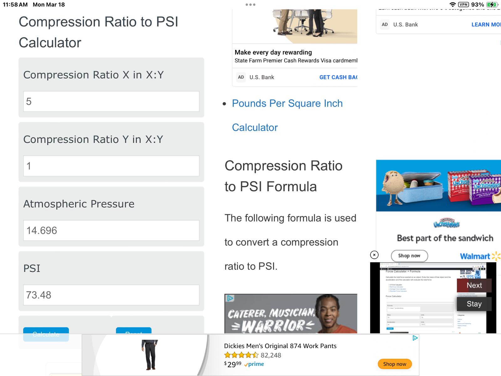

Based on an online compression ratio vs PSI calculator you should get around 115 PSI for an 8:1 ratio
75 PSI is more likely to result from a 5 to 1 ratio

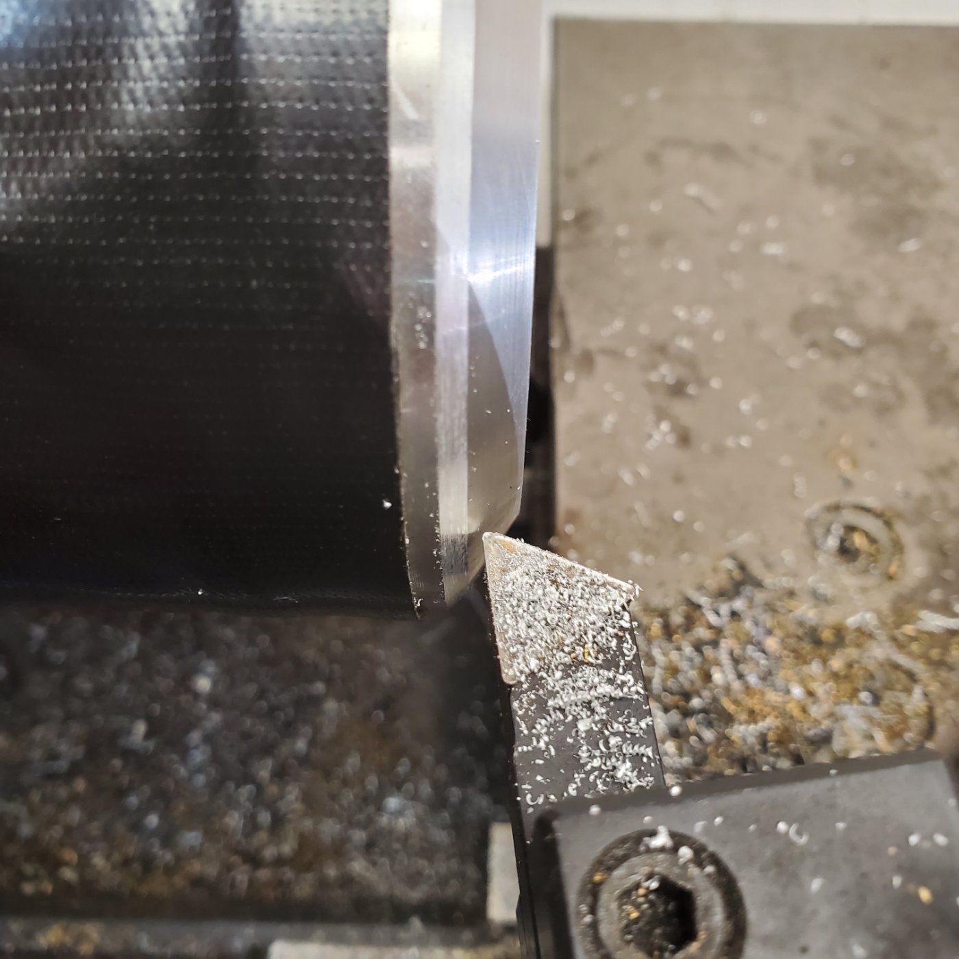

Speaking of pistons hitting the head, I had that problem fitting .080" OS pistons to a Ricardo head. Rather than machine the head, I turned down the top edges of the pistons. Solved the problem.

I'll second John K's observations. Z heads do vary in combustion chamber casting. I always fit them dry with no gasket first, and hand crank them to see if there are any issues to be worked around. The Prus heads I have seen have been trouble free, but I have had to put my own "Made in Canada" and Ford script on mine.

Compression ratio is a mathematical equation and not a measured pressure. Simples form, swept volume + chamber volume divided by chamber volume. There are other factors such as gasket volume and pistobpn dome/dish. Compression ratio is not measured by cylinder pressure.

Am new to playing around with different heads but after i found my transmission filled with radiator fluid i realized i may have a head problem
Removed the head which was an aluminum high compression [ according to seller ] found out corrosion between the water ports and cyl 1 and 4, which prevented the head gasket from providing a good seal
So this led to me purchasing a replacement head, based on comments on this forum i selected the Prus head.
Head arrived yesterday and decided to do a fitment test today before bolting it up, good thing because could hear the interference
Piston looked like standard one and piston head shape and size appears match to indentation in head.
Looking to figure out amount of interference I doubled up the gaskets, 1 new 1 old, head laying loose on top. Interference went away and head allowed some lateral movement with piston all the way up.
So question to you experts is where to go from here, ask for replacement head, or take head to local machine shop and mill a larger piston cavity and then the question is by how much. Other options ?
Thanks for your input in advance.

Expert certificate lacking, but have fitted alum high compression "Z' and the Prus heads.
The Prus head made no interference on 2 motors, both had block surfacing and new stock pistons, .030" over.
The "Z" fit didn't work as there were piston knocks after install (had not learned to fit with loose head bolts first). So took off the "Z" and painted the chambers with Prussian Blue paste. Fitted back with a few bolts and cranked over, that showed on the top of a couple of pistons where the piston hit the chamber dome.
100_0381 (640x427) (500x334).jpeg (117.24 KiB) Viewed 8659 times
So maybe do the same, also measure how much height you pistons rise, and if the pistons are .060" or more like .080 as there maybe contact on the edges of the chamber. There can be variations of how high pistons rise at TDC, like the one below:
100_0377 (590x289) copy.jpeg (102.43 KiB) Viewed 8659 times
This engine shows piston height at TDC much lower, and fit of a Prus head wasn't compromised, and worked great.
IMG_2510 (1280x960) (530x398).jpg (104.12 KiB) Viewed 8659 times
By using blue paste, you would see the issue. Maybe only one or two chambers are affected. Use judgement to see if alum has to be removed from the chamber(s).

Compression ratio and compression pressure are not the same thing, as was pointed out
Compression pressure is measured with a pressure gauge, and is subject to many variables besides head chamber volume.
Compression ratio is fixed for any given engine, as assembled, and it is calculated mathematically.
You need to calculate the swept volume of an engine cylinder, then calculate the volume of any dome or recess in the piston head, then measure the volume of the combustion chamber in the head, and allow for the head gasket installed thickness. If you have a flat head piston that TDCs level with the block deck, the ratio between the actual combustion chamber volume at TDC and the swept volume, plus the installed head gasket thickness, less any intrusion of the valve heads or spark plug into the chamber is the compression ratio. You cannot measure that with a compression gauge.
If you calculate the volume of any part of the T piston that is above the deck at TDC, and subtract that from the combustion chamber volume, and calculate the ratio of that volume to the swept volume of the cylinder, that ought to get you fairly close to the compression ratio.

Thanks for supporting me on the compression calculation. I thought about explaining how the heat of compression increases the pressure, but just didn't feel like arguing with others.
Under ideal conditions the ratio would be raised to a power of 1.4 for air. Under realistic conditions, some of the heat that is generated from the compression escapes to the surfaces of the combustion chamber and to the piston. Empirical data ahows a factor of 1.1 to be fairly accurate.
I have thought checking the compression with a cold engine versus with a hot engine. I have not yet woke up my car from it's winter nap to try this. I am wondering if anyone has made this comparison.
