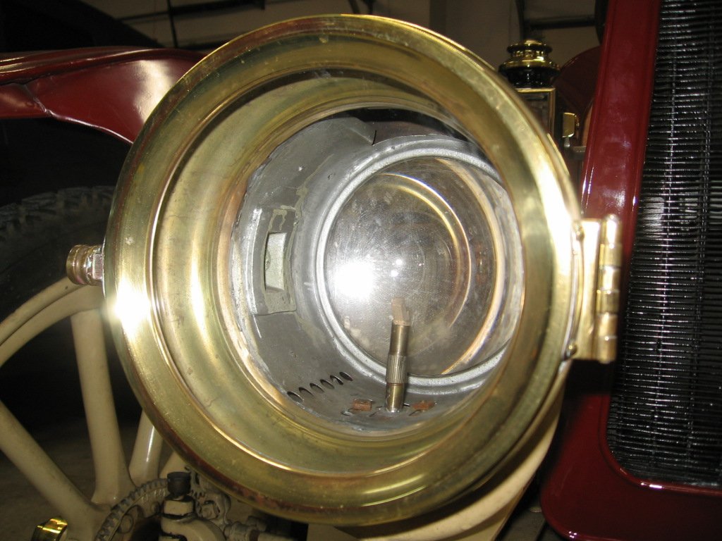

I managed to crack the flat glass lens on one of the E&J 333 acetylene headlights on my 1912 Flanders 20. I plan to take it to my local glass shop to have a new one made. Should I ask them to make the new one out of plain flat glass like the original, or would laminated glass work? I wonder how well laminated glass would hold up to the heat (I do light my headlights occasionally, but only for a few minutes for demonstrations).

Update - my local glass company called and said they had the plate glass lens ready for pickup, they had a scrap piece of 1/8 inch thick plate glass that was large enough to make one lens. Price, including polishing the edges, was eight dollars, a bargain IMO! It fit perfectly.
I asked them to obtain another piece of glass and make two more lenses for spares at their convenience. The headlights are E&J 366, BTW. :)
