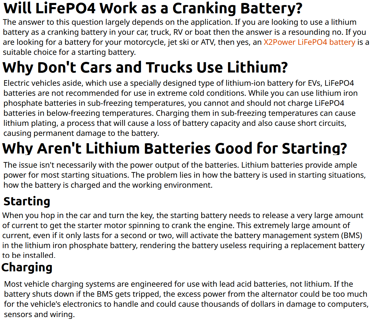

FROM Batteries+ web site
If you are looking to use a lithium battery as a cranking battery in your car, truck, RV or boat then the answer is a resounding NO. If you are looking for a battery for your motorcycle, jet ski or ATV, then yes, an X2Power LiFePO4 battery is a suitable choice for a starting battery.
Too many people choose a Model T battery on CCA (Cold Cranking Amps) which is the amount of amperage a battery can supply at zero degrees (-17.8 C) for 30 seconds while sustaining a voltage of at least 7.2 volts. CA (Cranking Amps) gauges power at 32 F for general starting in moderate climates. So as stated above
Charging is another factor to consider in selecting one the type battery as well some like a slow charge. Voltage Regulators are available again for a Model T and highly recommended over a Cut-Out. Magneto charging voltage is unregulated. Voltage is what charges the battery & amperage regulates how long it will take.
My choice is a cranking battery's cost/years (warranty and years of service)
6-Year (2yr free replacement) 6v Lead Acid Automotive Battery $114.99 $114.99/2yr about $57/yr $114.99/6yr about $19/yr
Optima Red Top 6V (3yr free replacement) $249.99 $249.99/3yr about $83/yr $248.99/6yr about $41/yr
Also those lead acid batteries sitting on the shelf at the Auto parts store... been there a long tie without being charged.

We all have our opinions & I had posted one from the Battery Plus website that seems to have been ignored. Just to reinforce what Jeff has said here it is Battery Plus againLuke wrote: ↑Fri Apr 05, 2024 5:32 pmNot all lithium-based batteries are the same and should not be confused for each other. I suggest that, when looking for replacement lithium vehicle batteries, you consider LiFePO4.
LiFePO4 do not exhibit some of the more alarming characteristics of LiPo, they have a similar charging regime to Pb, are happy taking a deep discharge to 80%-90% of capacity, and are typically rated 2000-3000 cycles to 80% capacity. They have extremely low self-discharge so do not typically require topping up between off-seasons and are usually a very long lasting product.
FWIW my house batteries are LiFePO4, I have them inside the house and they're now 10years old with no discernible loss in capacity. IOW I put my money where my mouth is, and am happy to recommend them - and of course, being me, I did significant due diligence before going down this route so the recommendation I make includes thorough research, not solely my own experience.
Luke.
https://www.batteriesplus.com/blog/powe ... m-starting
Here is what they say
Lithium iron phosphate (LiFePO4) batteries have been becoming increasingly popular over the past few years. We recommend our X2Power lithium batteries for many deep cycle applications from RVs to boats but can these batteries be used as a replacement for your starting battery? --
The "application" is in reference is to the amount of amps needed to turn over the starter. Small engines (Motorcycles, ATV's & jet ski's) only need about 80 amps (best as I determine) while a "good" 6v Model T starter needs 160 amps upwards. Remember if the battery fails the warranty will not be honored. User be aware
