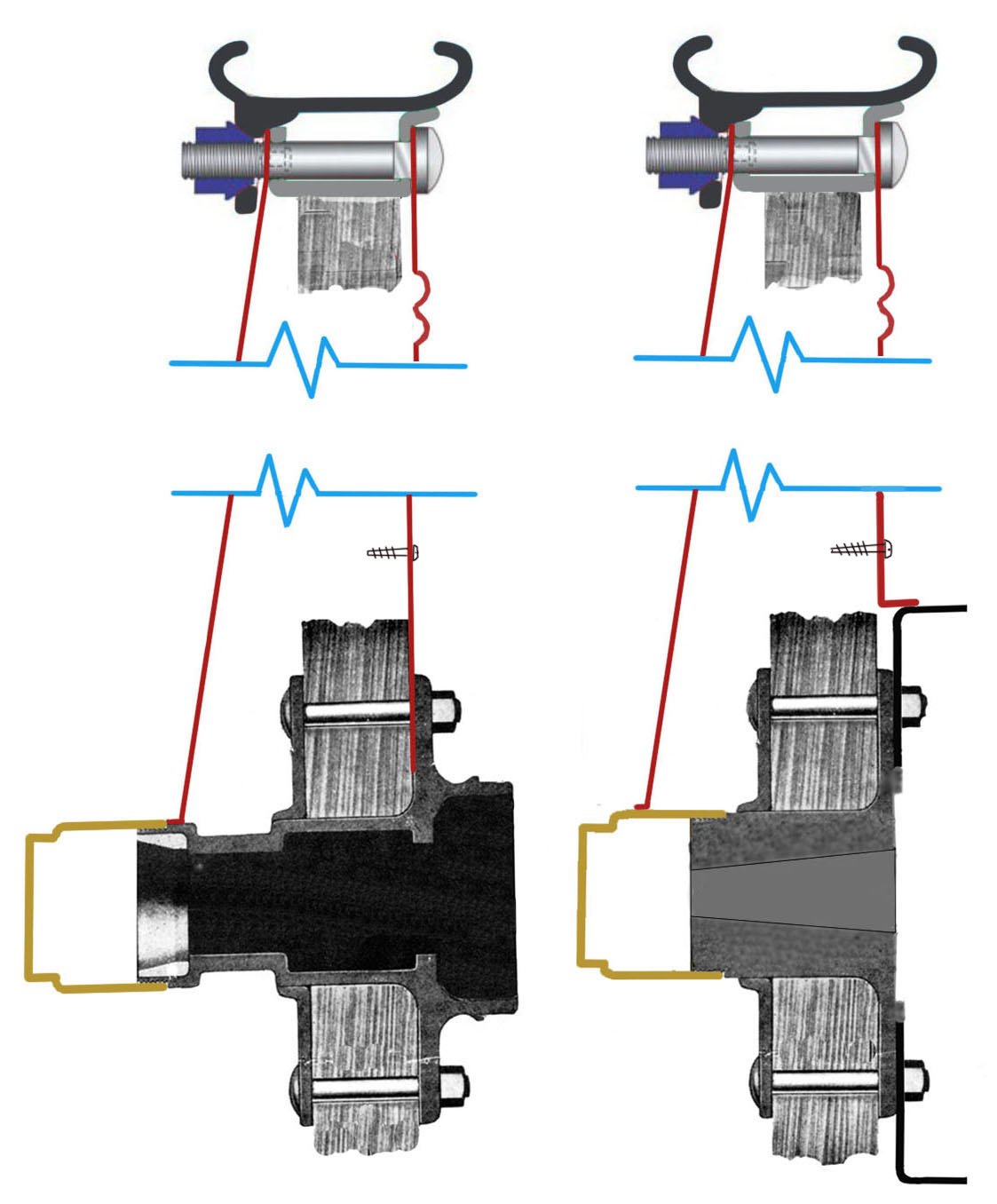

These are early discs as has been pointed out. So attaching them to the spokes or wood felloe was the easy way to do it.
When demountable wheels came along disc covers were available which went front and back of the wooden spokes.
The Universal Body Company supplied such disc covers and in Australia a Ford rebadged as a "Renown" also had disc covers, being a lot cheaper than the real deal of solid discs.
Front outside discs were attached with the wheel rim bolts and just went over the hub behind the hub cap. The back discs were attached the same way but had a flange which went over the brake drum.
The inside discs of the front wheels were fastened between the hubs and the spokes. as well as the rim bolts. A small door which swung sideways opened an area around the valve so the valve could be reached.
Not a really popular accessory especially if the roads were muddy as the wheels got out of balance easily as they had plenty of gaps to let in mud/dirt.

Allan - I have Motor Utilities 23" disc wheels on my '25 Racer that utilizes a stock Ford hubcap as did my 23" Michelin discs - both are demountables.
