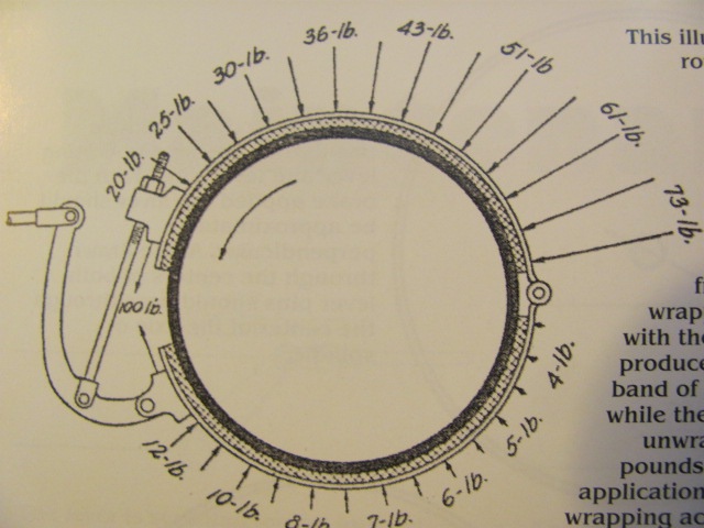

Rocky Mountain brakes are BAND brakes around the parking brake drum. IF the band is mounted one way, it will grab hard in one direction, let's say forward. If it's mounted the opposite way, it will grab in Reverse. If it's mounted half way, you'll get half braking in both directions. The originals were more like the half way mounting. The new Rocky Mountain brakes are more like the first mounting for forward mostly. This is all due to: Self Energizing. As the drum turns inside the band, when the band is tightened the drum rotation direction adds/pulls the band tighter. When the direction is reversed, the drum has the opposite effect tending to loosen the band. Thus, the 3 mount/action results above.

Thanks Terry, you explained it well. 'Self-energising' is a cool term, but is just jargon for new comers to the hobby.
I remember it bandied about without knowing what it actually meant for a long time, so it was good to have an explanation of what that means:
So 'self-energising' just means that due to its rotation the drum grabs the band as the band is tightened so increasing the braking force. As Terry said, the opposite is true for reverse as in that case the drum is pushing the band away instead of grabbing it.
AC brakes always have half the bad 'grabbing' and half 'pushing' whichever direction you are going, so has good reversing brakes compared to RM but not as good in the forward direction.

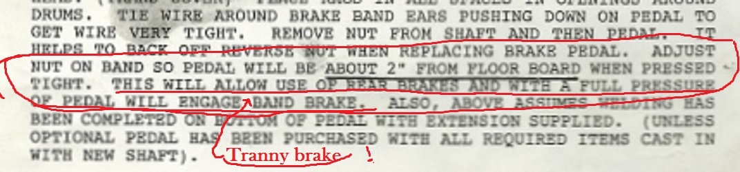

Kelly Jons, I for a long time have been an opposing view on the "Rocky Mountain" brake issue. In my opinion, they are seriously flawed in their design and those flaws should have been corrected a couple decades ago.
A point of fact, the original 1920s design was very good, and they were nicely reproduced in the 1960s. At some point, someone decided to improve the braking efficiency on them, and instead of making minor modifications in the original design instead used another competing era accessory brake (the large drum AC brand) and with some simple changes made them 100 percent self energizing in one direction only. And dangerously useless in reverse!
There are several often recommended ways to install them and actuate them. Most people seem to want to set the service brake pedal to actuate the RM brakes, and a kit is available to do this.
It is possible to separate the pedal brake from the hand brake, but a lot of people do not go to the trouble. I think that is a HUGE mistake! Every car, especially a model T, should have two fully functioning independent braking systems! Other than the wheel itself (which if it falls off, the car is grinding to a halt anyway?), there should NOT be any single shaft, bushing, rod, pedal or anything that if it somehow fails could cause both the service and the emergency brake to fail!
I have had two model Ts with the modern RM brakes on them. Both of them, I set up so that the service brake remained as Ford factory made it, and the emergency brake operated the RM brakes. The brake handle (if you learn to use it appropriately) has better leverage and better control than does the foot pedal. Personally, I find the Ford service brake to be adequate for most routine stops. And if I need a little extra, I use the brake handle.
That works for me.
A lot of people really want the RMs on their brake pedal. And for most stops, that works very well. Until you get into that situation having to stop going uphill, and not being able to hold it. If your pedal and hand brake are integrated? You run into serious maintenance issues trying to balance them so that both work at all times. A lot of people claim that is not any trouble. A few found out the hard way that they were wrong.
There are several ways that the RMs can be applied by the pedal, and an independent inside shoe brake can be operated by the brake handle. For those that want the RMs on the pedal? That is what I recommend.
A few enterprising and creative folks have put the RMs onto a modified mounted pedal, and then through a modified shaft connected the brake handle to the transmission brake! Sound complicated, is a bit, but not all that hard to do. I however, do not like that idea either. If one also uses an auxiliary transmission of some sort? Having the auxiliary transmission in neutral for any reason (deliberate or accidental?) (like when starting the engine?) prevents the parking brake from holding the car in any way at all. Think about it.
I have said these things before, several times. But still, most people do what they do.

The instructions for R-M brakes state to also set the Ford tranny brake to work in conjunction when needed.
These external brakes, like the R-M with the larger 12" drum give extra stopping power as they give over 130 sq.in of friction surface compared the 8" tranny brake drum. These accessory brakes for the Ford, either R-M or AC, are just that, accessory assistance for stopping.
These external brakes work the same way, forward is the pressure made to the rotating durm to slow and stop it. Note the diagram, all the lbs. of force are applied at the leading edge of the forward drum by the design of the lever arm. That is the purpose of the accessory external brake, to add more stopping force.
With solely the Ford tranny brake, stopping distance is further, with the added accessory external brakes, stopping distance is reduced by a large margin.
However, the Ford tranny brake needs to be utilized in backing down on a grade, slowly, as you need that advantage of the tranny brake grabbing on the drive line. If you only have the external system hooked up, you can have only minimal rear stopping power.

So, in summary, a proper setting of the R-M or other external brakes, requires too the proper setting of the std. Ford tranny brake.
And, important is the Ford internal rear hub or emergency brake shoes need to also be in proper setting. That is for parking, or starting the Ford to keep it from running away.
Best of all, with the R-M equalizer set up, when the emergency brake lever is pulled back, to engage the rear internal hub brake, it also applies the R-M external brakes, so you have very powerful parking on a grade too.
Have these R-M brakes on my Fords, and never any issues, as they are set to also use the Ford tranny brake too. Plus the internal hub shoes are the modern lined shoes also, very effective.
