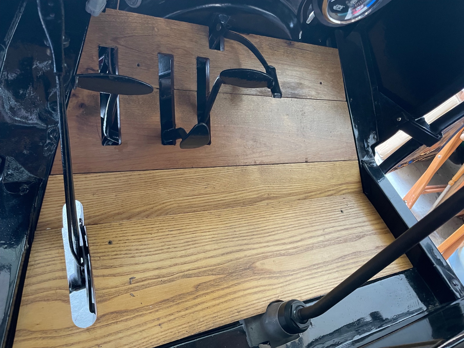

Here's some photo's & measurements from my 24 C Cab floorboards. Ordered from Lang's a few yrs ago. Waited over a year for their vendor to deliver, opted for hardwood but got 2 different types of oak. As you can see I added a foot throttle notch. The hinge in the middle helps installation. Hope this helps.
John M
Oscoda, Mich
John M
Oscoda, Mich

More photo's

Great photos but it might be a '24 BUT you have '26-'27 transmission pedals so the slots are not in the same position.
Nunsio1
- Posts: 115
- Joined: Sun Jan 06, 2019 4:43 pm
- Last Name: Monticciolo
- * REQUIRED* Type and Year of Model Ts owned: 1924 C Cab truck
- Location: Oscoda,Michigan
Re: Source for C Cab TT FLOORBOARDS
Yes, I installed the 1924 cab on a 26-27 chassis, and lowered] the roof so it will fit in a standard garage. All original running gear with some modern upgrades for safety & convenience. Tried to use up surplus T parts before they end up in the scrap heap.
