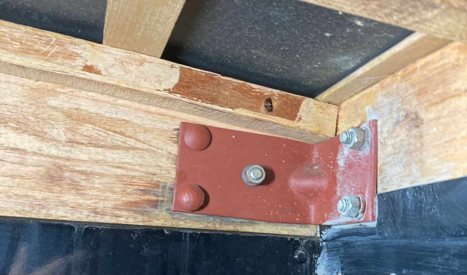

Post by George House » Wed May 01, 2024 12:51 pm
….specifically for TT C Cab top wood metal corner brackets. Each of the 2 rear corner brackets have 5 bolt holes for 5 carriage bolts - 3 with nuts on the inside and 2 with nuts on outside in the rear. Of course I’m removing the zinc finish from the carriage bolts and painting them black…… but are the nuts square or hex ?? Any original C Cabs with brackets out there ?

Looks like the original nut is square on mine.

Thank you Jason and Jeff. Then square nuts it’ll be! A long time ago a seemingly knowledgeable man said “Ford used square nuts on any bolt that passed thru wood”. So I used square nuts on the inside of my ‘14 firewall until a more knowledgeable man said “ they should be brass plated steel hex nuts”. So, in my ever increasing vigilance to be more correct, I changed them out. This C Cab wood roof thing is just another iteration of my attempts to be more like Original Smith 😂😜
