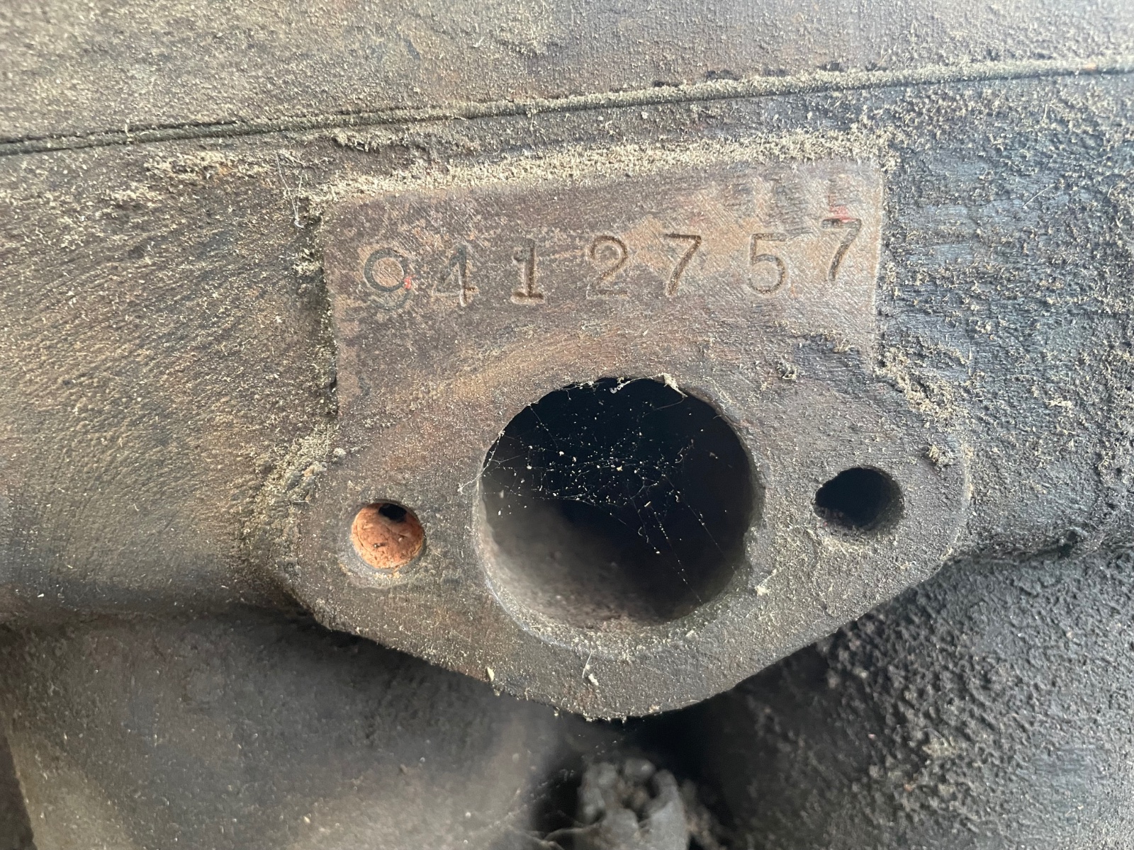

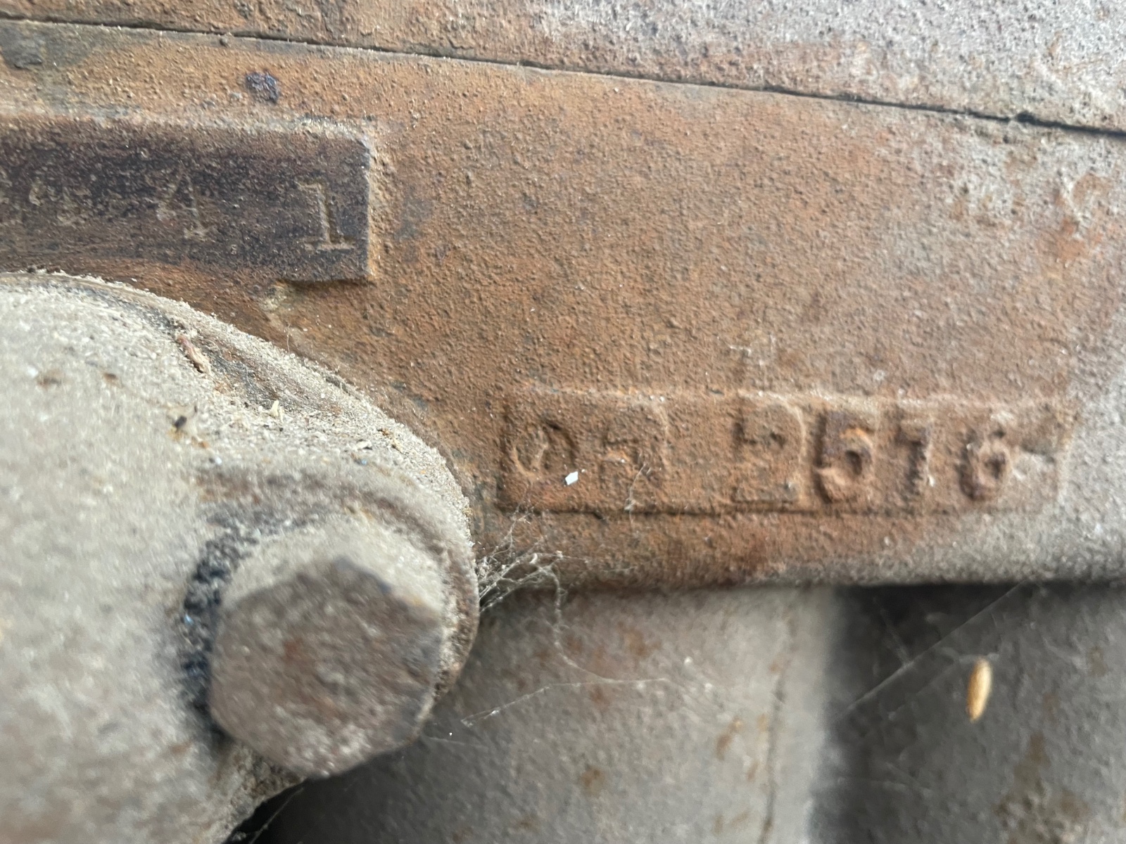

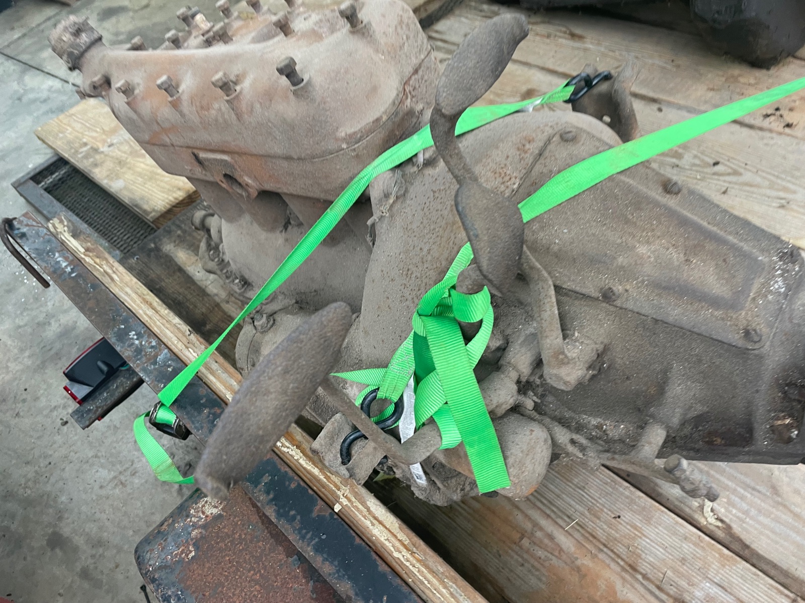

I have 3 engines I am trying to sell, any idea what a fair price is?
I tried to post some pics, I don’t know if they will come through, they all spin, and are mostly complete but don’t run

The 16 if it has the low head, that is worth 100-150 for the head, the narrow nose pan is worth 100, the block is 100, the 25 engine would be the best gamble not knowing, the 26-7 engine could be cracked in the cylinder or in the oil galley, not knowing I do not like to pay more than 150. for a complete since some of the parts will go right to the scrap pile, just my imput.
- Posts: 4529
Re: What is this worth?
The price for the 3 engines and not knowing about any cracks, cracked transmission drums, scored crankshafts, and etc 300.00 for all 3 would be a reasonable price for buying unknown condition engines. That’s taking into consideration the engine pans, transmission covers, cylinder heads and the other parts. The engine blocks would be a toss up if they are cracked or not. It’s kind of like saying one man’s trash, junk might be another man’s treasure.

If those are local to you, odds are they have freeze cracks. Check them close.

Removing the hogsheads might give potential buyers a chance to look over the drums for obvious cracks or other problems. Of course, if there are obvious issues, that idea could make them worth less.

Looking at the 26 engine it looks like the head has been off of it and then stuck back on with the head bolts holding the head on just enough. What does that mean? There again the unknown is the deciding factor for that paticular engine. Opening them up may help in the value and what condition they are in will tell the story. With the transmission covers off and finding scored drums isn’t a good sign for some people. But for others who knows.
- Posts: 4236
Re: What are engines worth?
When trying to sell them, I'd remove the heads so people can have a look at the bores & seats and also determine how much oversize the bores are. Standard size bores would be nice! If the 26/27 block has no cracks from the valve seats to the bores it would make it better than most out there. I'd try for $125 each or $300 for all 3. You can always offer them for less when the perspective buyer starts to walk away.
