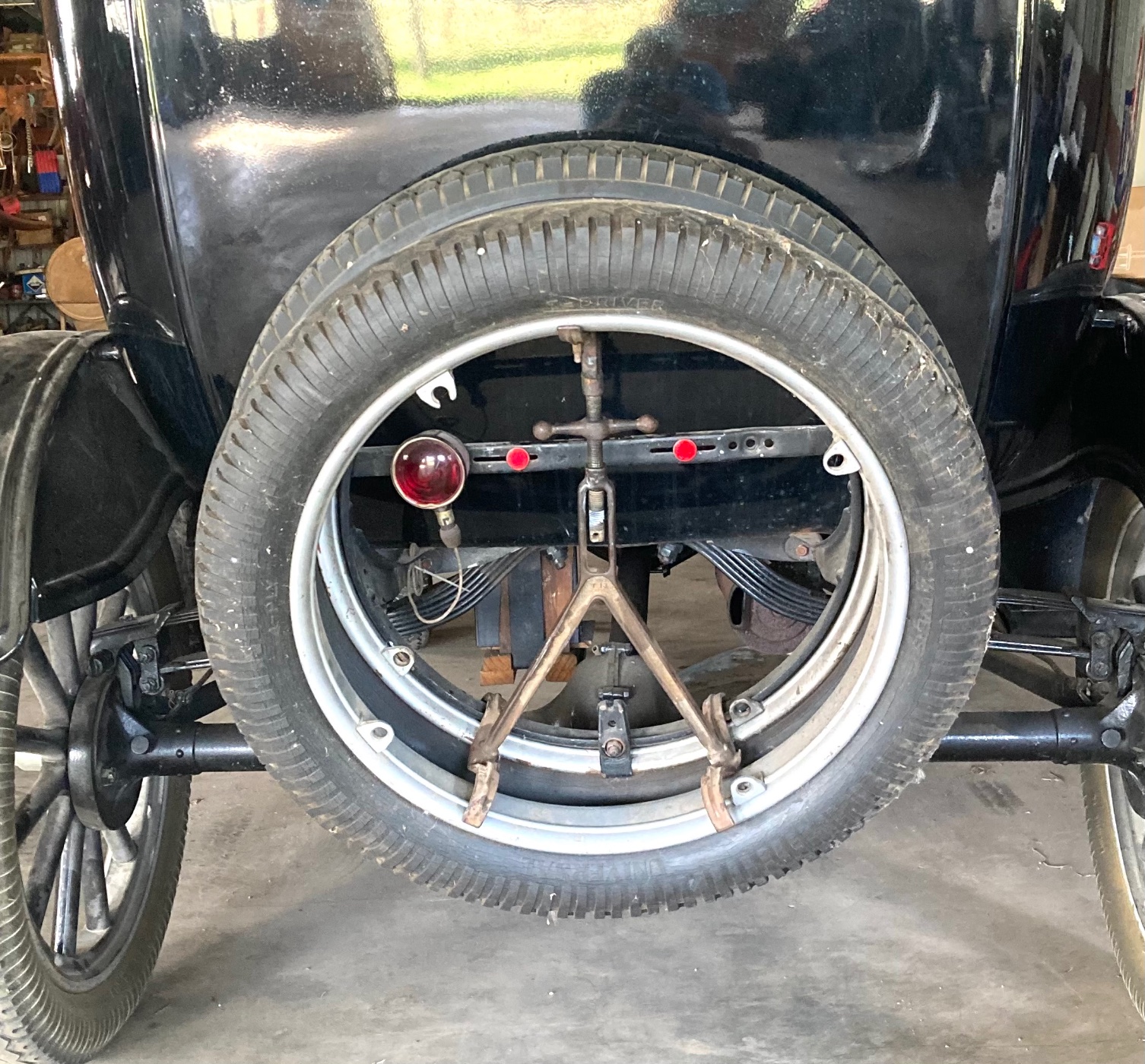

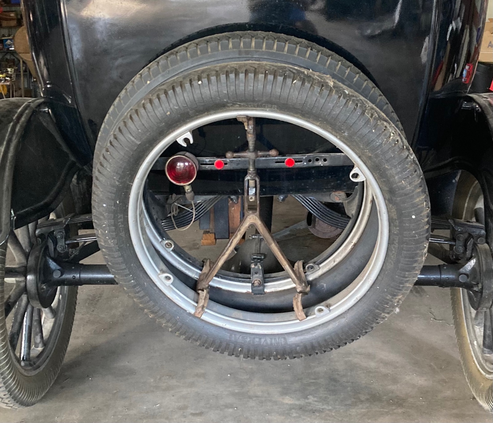

Unfortunately I can’t include a video. It seems the more I run the screw out without stabilizing the bottom right leg, the more I MIGHT be stretching the OEM tire carrier. See the bottom right leg position change from 1st to 2nd picture. Is there another curved piece that should go above the bottom of the additional rim ? The first picture has the 2nd spare tire taped to the 1st. The second is without the tape and the 2nd spare fairly wobbles incorrectly…… Ideas??

I'd first try flipping it. I'd also add, I used one of these on a long trip. I modified it to clamp on the outside, so not to scratch nice plated rims

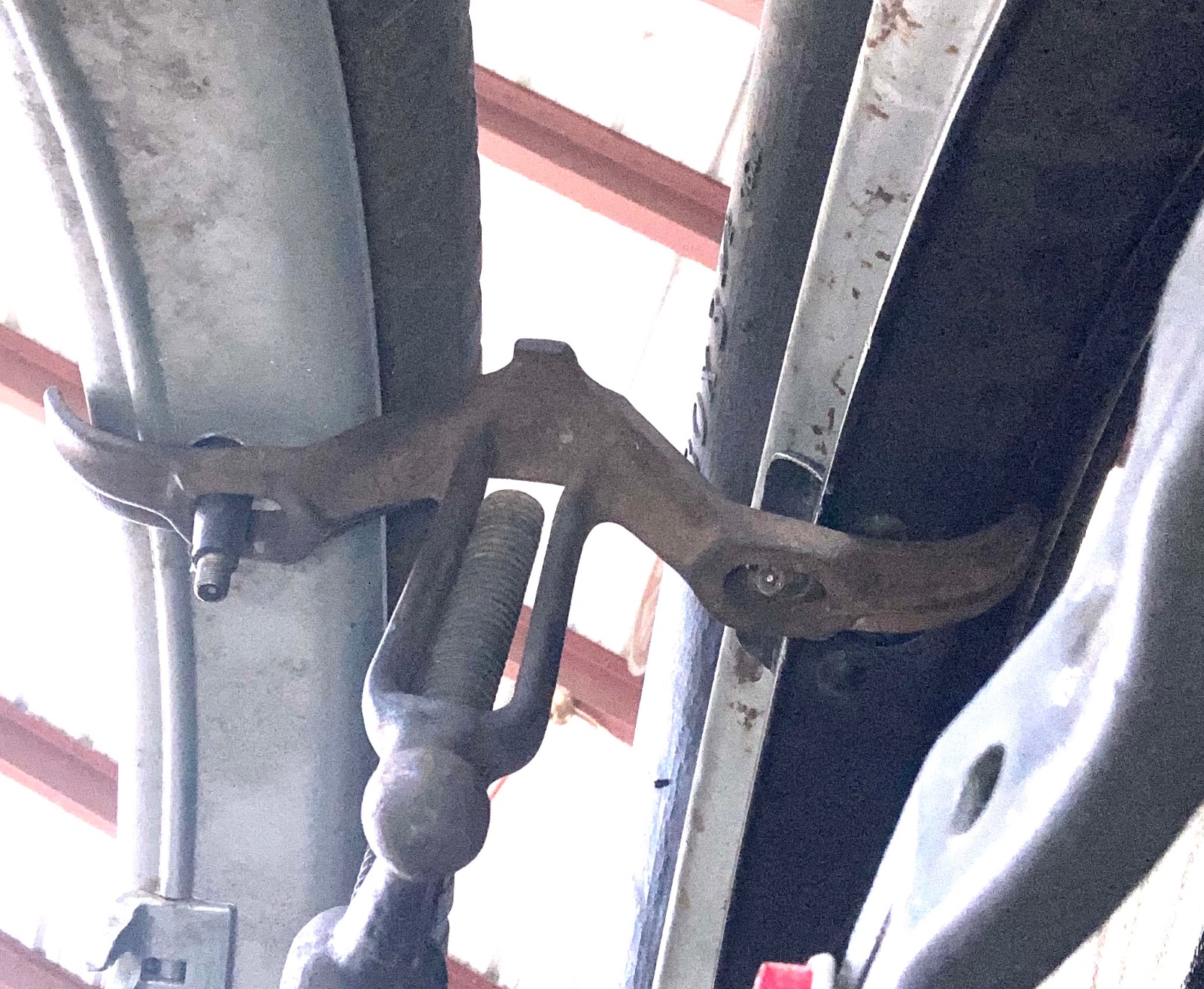

Maybe this’ll help. I took a selfi from bottom up of the upper bracket. I thought the oval holes were for the 2 valve stems
. Original Smith won’t like my valve stems

I am not sure that Duplex is intended for model T clincher rims, but it might actually be for a model T? The saddles look a little large for the model T clincher rims.
Regardless, I am not sure what the holes are for that your valve stems are poking through? But you do not want to do that. The holes do not line up with the rim's valve stem positioning. I suspect most of your trouble is because the valve stems are not allowing the rims to sit properly in the saddles.
When I used my Duplex carrier on my coupe, I had to let it lean sideways a little bit to clear all the valve stems and fixed lugs as well as the car's spare tire carrier's brackets.
Unfortunately I had to sell the coupe. But I still have the Duplex.
Also, one of your rims, with the notched out fixed lug looks like it might be a Chevrolet rim. It may or may not fit the model T's wheels.

I two tires and rims is a lot of weight on the Ford spare tire carrier, I would advise against it. Also, constraining the stems is looking for trouble.
