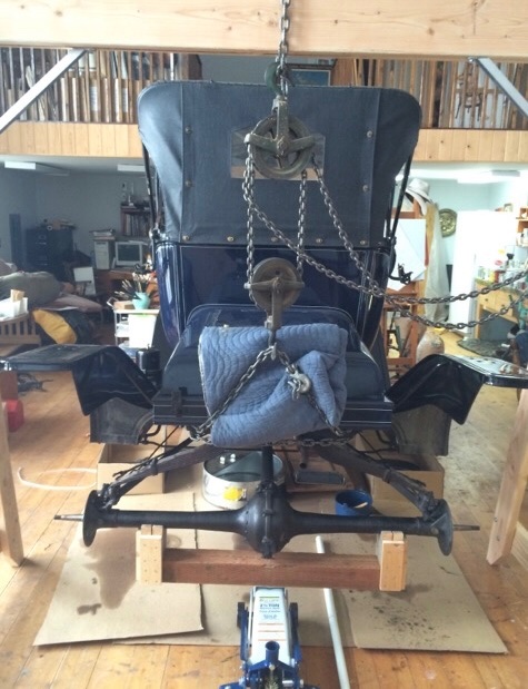

Thanks for mentioning this, Craig !! VERY IMPORTANT !!Craig Leach wrote: ↑Sat Jun 22, 2024 12:13 amDid you replace the u/joint with a new one? Some of the new u/joints are a little on the big side & hard to get in the trans output . . .
Making a difficult assembly impossible !! Be sure to check how individual parts fit up before assembling anything !!
When I rebuilt my axle/drive shaft, I replaced the two-piece drive shaft ball end with a new reproduction part, and a new repro U-joint. The U-joint was a bit more robust than the original, and the ball housing opening a wee bit smaller than original. The combination required some whittling to make it all fit, though either one would have been okay with the corresponding original part !
I slung the fame from a chain-fall, and found a floor jack with a cross piece handy for positioning the assembly.
Get a horse !
