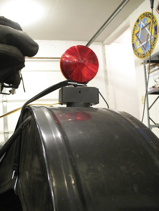

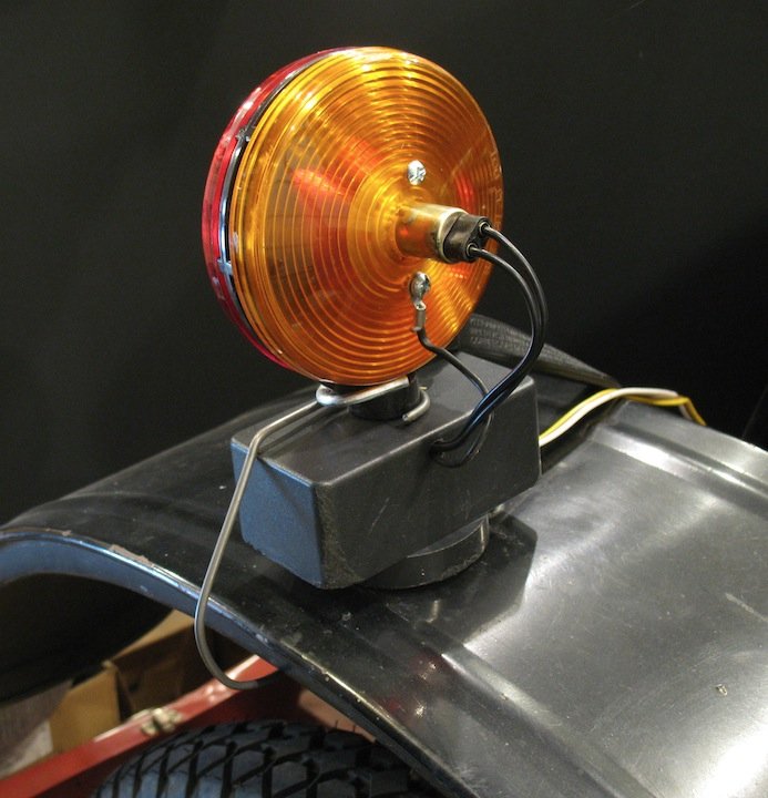

Most car batteries are twelve volt, but that doesn't mean you can't get six volt. The same goes for LED bulbs. I bought some HF trailer lights and converted them to six volt LED for my runabout. They ride in a box in the trunk until I need to use them. LED bulbs are directional, so I did have to alter the lights to aim the bulbs rearwards.
A welding rod hook and a rubber bungee keep the light from bouncing off.

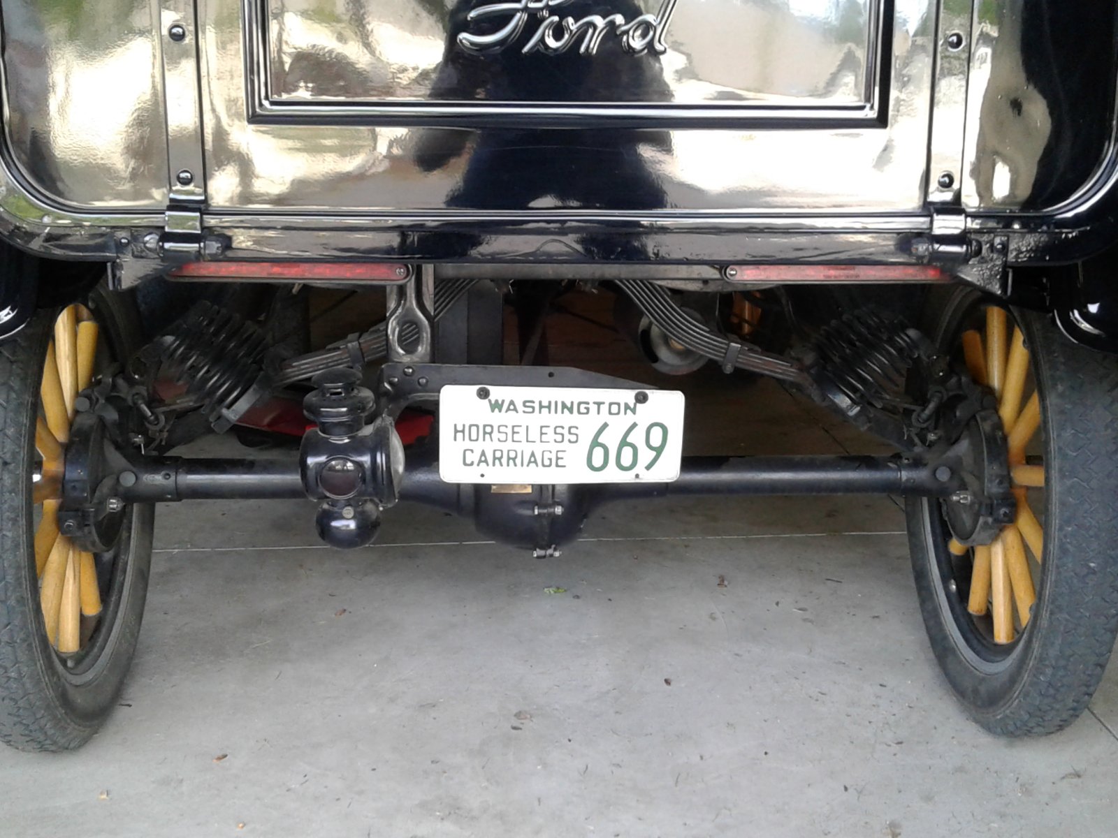

I have this type on a 25 roadster pickup and a 14 run about. The one's on the pickup are 9 inches long and mounted about 2 inches back from the end of the bed. Very discrete when not light but really get your attention when you apply the brakes. Found them at a led vendor at a swap meet. They are also wired for signals and tail lights on the pickup.[image][/image]

Jelen, I love those lights and when they're not on they don't look like something that got stuck on and don't belong on a T.
I put some bike lights about the same place on my Torpedo for additional tail lights. During the day you can't see them but they work well at night. Great Job!!
