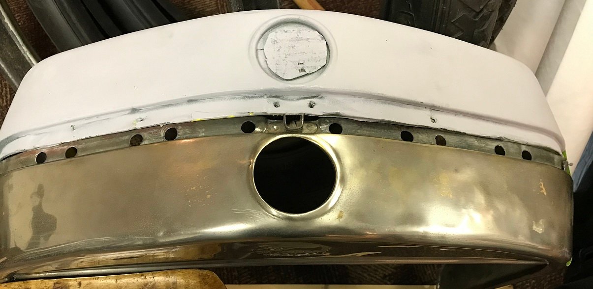

Post by rickd » Sat Jul 06, 2024 4:59 pm
This is a July 25 Touring I am restoring. The nickel rad shell has rectangular holes and the sides are clearly slanted. From my read in the Encyclopedia the nickel rad shell and headlight rims became available as dealer accessories in April, 1925 and were subsequently available as options on some 26 cars. Not to pull this discussion away from the shape of the rad cover but I would appreciate an opinion on whether the use of the nickel rad cover and headlight rims would be correct on my late July 25 Touring. Hope so, they sure match the hubcaps and steering case nicely.
This is a July 25 Touring I am restoring. The nickel rad shell has rectangular holes and the sides are clearly slanted. From my read in the Encyclopedia the nickel rad shell and headlight rims became available as dealer accessories in April, 1925 and were subsequently available as options on some 26 cars. Not to pull this discussion away from the shape of the rad cover but I would appreciate an opinion on whether the use of the nickel rad cover and headlight rims would be correct on my late July 25 Touring. Hope so, they sure match the hubcaps and steering case nicely. Rad.jpgRad11.jpg
How correct do you want to be? For judging, for self..
Repro headlight rims are a bit narrower than original (need closeup of yours). Some plated steel shells, so have you confirmed its brass plated shell?
