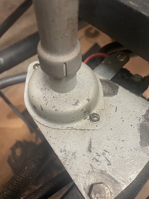

Post by DanTreace » Fri Jul 19, 2024 2:36 pm
Using a solenoid will take the load off the foot switch.
On this install refurbished an original screw cover T switch, drilled hole under the cover to fasten one arm of the solenoid. That gave the 6v solenoid a good ground to function as the foot switch plate is fastened to the frame anyway, but be sure the bolts to plate and frame are clear of rust or paint for ground return.
The heavy battery and starter cables mount to the solenoid.
Then run little wires to power the solenoid, works great!
Sometimes a modern upgrade IS the right answer. Why do you think every single modern gas powered car now uses a modern solenoid on all starters? Because this the ONLY way you reliably and safely deliver 200+ DC amps to a starter and not burn up your foot switch after a year. It's the ONLY proven way to solve this problem over the long term if you drive your car more than a couple of times a year. The moment I realized this fatal flaw on my T years ago, I ordered a 6v solenoid and installed it - problem solved. The best part? I didn't even need to use my EE degree to figure this out!
Dan's excellent pics show exactly how to solve it. Purists need to get over it and install a solenoid or stop complaining about the problem and just realize that continued use will require periodic rebuilding/replacement of the T foot switch. It's an inherent design flaw that cannot be corrected in the original foot switch design with copper contacts.
