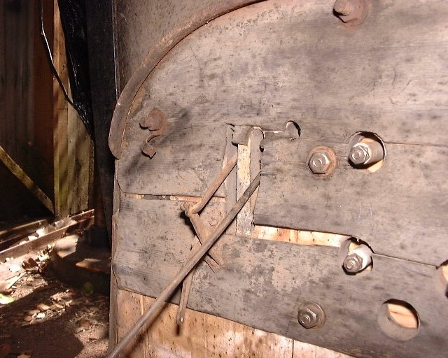

Maybe these will help. My as found 1920 coupe. It is hard to see but there is a slot behind the steel plate the rod sticks through and had the fork type end. Pretty sure, it has been a while that the plate was put on like installing the one on the steel firewall, then the plate is screwed to the firewall but it could also have been the slot in the plate was big enough that it could have been mounted separately.

Thanks for the information and photos, Mark. Most helpful. The Centerdoor's owner called in the order yesterday and was going to ask the vendor which adjusting rod is correct for his model and year. Either one will work, so we'll rely on their expertise. I like the simplicity of your arrangement. We'll see what the vendor recommended when the parts arrive.

Here are a couple of more shots with a tape measure that might show the holes from engine side. In the 2ed shot you can see the slot that matches the angle of the adjusting rod.
