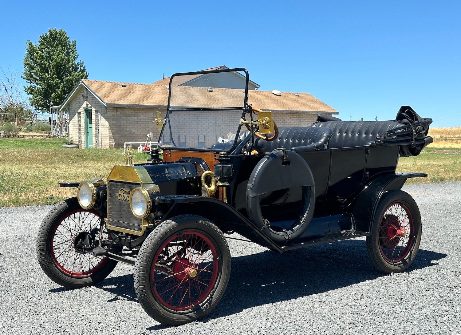

For those of us who have Hayes wires on our cars and not heard of issues with them, what problems do they have? I have never had them off or noticed any trouble. How do you tell if they need attention?
Paul

Looks like you may already know about the typical failures of the Hayes wire wheels, as your car is equipped with front wheels adapted to rears. All wood and wire wheels suffer from the same typical hub failures, spun bearing races up front and wallowed out keyways in rear. The Hayes hubs are integral to the wheel and so a worn hub typically means a scrap wheel. This would be an opportunity to salvage any extra rims or drums and turn them into wheels

Post by Allan » Fri Jul 26, 2024 8:54 pm
Paul, your rear wheels are front wheels adapted to Ford hubs with large brake drums, so I cannot comment on them. I do not know how the adaption was made, but yours would not be the only ones. The good thing in your case is any repairs may be easy to make using standard T parts.

Post by Hudson29 » Mon Jul 29, 2024 5:12 pm
I had no idea about this. These wheels were on the car when I bought it and I thought it was supposed to look that way. I know that it has an original set of Rockies, the ones that work in reverse and that the hand brake lever makes no discernable reduction in speed or holding the car when parked.

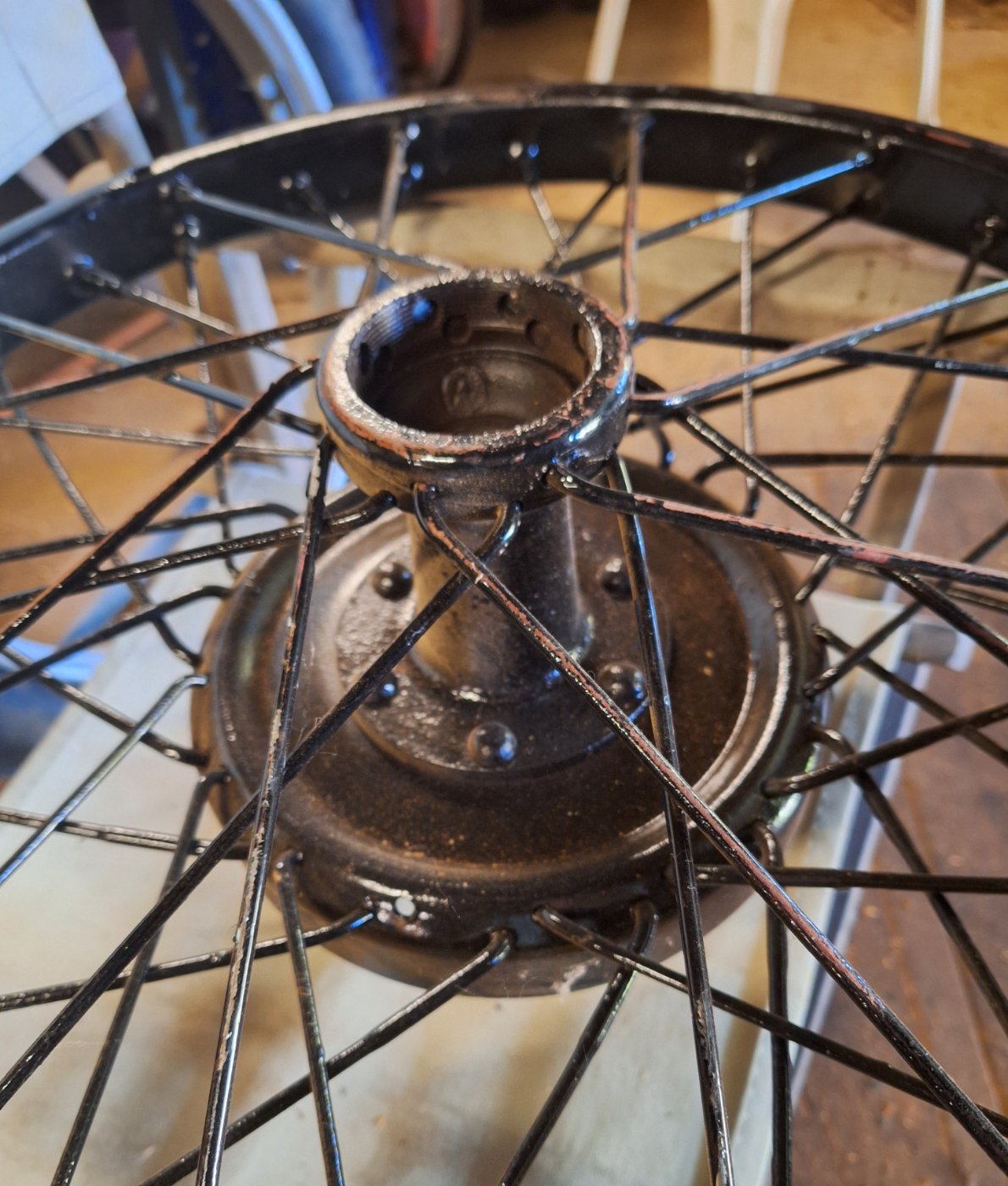

There were 30x3-1/2” and 21” rim variations of Hayes wire wheels. Both had the rear hub made up of the outer “snout”, and the inner drum. The snout did most of the work, but the drum is drilled to accept the inner row of spokes, making it a structural part of the rear hub. This drum doubles as the emergency brake drum and so the spokes interfere with most (maybe all) accessory brakes

Thanks for that, I had no idea that the rear wheels were made that way. The ones on my car do allow the Rockies but I'm not sure if it is a later large drum or the earlier small drum setup. I would love to see a picture of the Hayes rear wheel to see what was different.

Post by Allan » Wed Jul 31, 2024 12:31 am
Here you go Paul.

Post by Hudson29 » Wed Jul 31, 2024 3:10 pm
Thanks, now that I see these pictures I can see that mine are different and the earlier discussion about brake drums makes sense. I'll save the pics for future reference.
