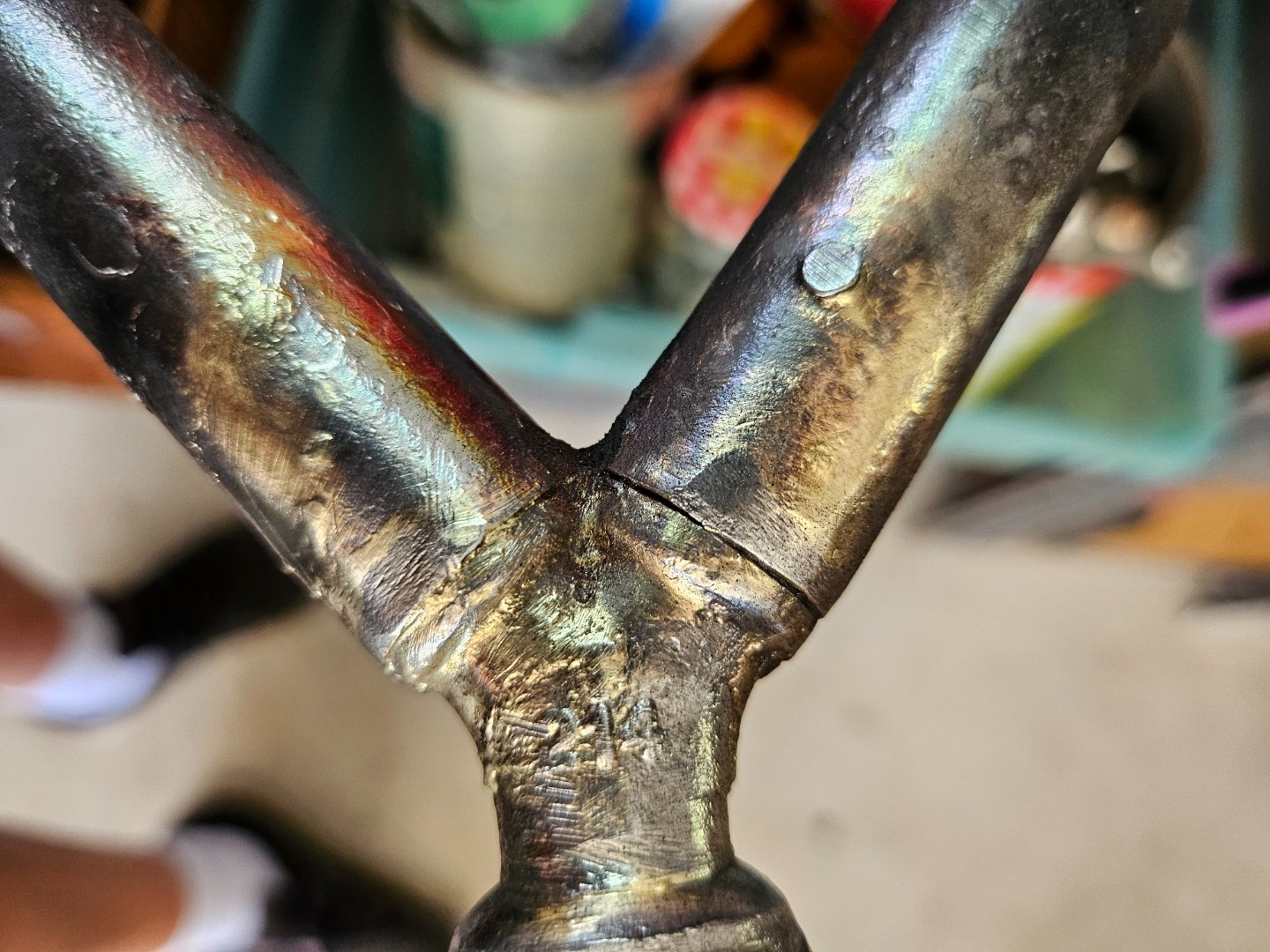

Having pulled the rod I could inspect more closely...some surprises...
The ball itself is badly worn....
Top to bottom flattened, micked at 1 1/16". Right to left, it micked out at 1 11/32".
The wear pattern was obviously more vertical vs horizontal, but also reflected a lot of fore/aft forces where the forward portion of the ball was wearing conical.
This wear pattern fore/aft was also evident in the socket, as can be seen on the lower aft portion of the socket. But with that much forward wear on the ball, I also expected to see a significant ridge developed on the forward face of the socket...while there is some, it's minor, not like I expected... It also appears in the last pic there was an indent on the pan drivers side...major bump/minor accident?
Topic author - Posts: 378
- First Name: Kurt
- Last Name: Andersson
Re: Worn radius rod ball......suggestions?
So...thinking why so much fore/aft tension...which...is to be expected, but still....
Beyond the dent in the pan, yet more evidence of some mishap in her life....
The radius rod ends are seriously bent.... Also, not sure if this amount of brazing up the shaft was factory normal, but....the ball shank and rod shaft were pinned on one side....so obviously a broke rod repaired back in the day...
The T archeological dig continues...

I wouldn't be so sure that the wishbone ends are bent, as in "damaged". There are some angles built into them that control your caster angle. What does appear to be the case, is that the stud ends are worn to a taper. When the studs fit into the spring perches they are supposed to be a snug fit. If they are sloppy loose, then the studs are worn and most likely, the holes in the perches as well. For safety and steering control, it is essential that these fits be snug.

Which begs the question, if there is a built in curve, how much is it/where/radius?
Anyone have a pic of a good early rod for comparison??
Mine has a significant difference one side vs the other, as well as a torsional difference in relative angles of the pins to each other, as well as with the rods. The worst bent side also appears as if the pin was thrust at the rod end...visible flare... Thinking this rod has some serious issues...
- Posts: 4169
That's a better perspective. I'd say that wishbone is done for.Daisy Mae wrote: ↑Sun Jul 28, 2024 6:02 pmWhich begs the question, if there is a built in curve, how much is it/where/radius?

Here's a pic of what is should look like. (Been saving parts for a spare front end ) I have one on a terrible front end I found in the wild I just want the bracket off it the one leg of the bone is bent but the ball seems decent and the nuts are still on it it could be forsale if you need it I attached pics of bothDaisy Mae wrote: ↑Sun Jul 28, 2024 6:02 pmWhich begs the question, if there is a built in curve, how much is it/where/radius?

Thanks Karl. I was able to secure one.Karl Von Neumann wrote: ↑Wed Jul 31, 2024 11:56 amHere's a pic of what is should look like. (Been saving parts for a spare front end ) I have one on a terrible front end I found in the wild I just want the bracket off it the one leg of the bone is bent but the ball seems decent and the nuts are still on it it could be forsale if you need it I attached pics of bothDaisy Mae wrote: ↑Sun Jul 28, 2024 6:02 pmWhich begs the question, if there is a built in curve, how much is it/where/radius?
I would have loved to have had that original double wishbone setup had it been in good shape

Yup, that ultimately was going to be my route, if it wasn't for my rods being bent.
- Posts: 4482
Can the wishbone be straightened? Is there evidence FOR SURE that it has a built in slight off set or whatever? Or is it just conjecture. The later ones were straight and why should the earlier ones be any different if the later would work if you replaced the perches. But maybe earlier perches allowed for an offset?

If a guy had the bracket a guy could make the pipes I have a good one on my car. Really that's why I grabbed that axle was for the bracket
- Posts: 6785
True, the later ones were straight. However, the cant provided by the built in angle on the forged ends of the over-axle wishbone still needs to be in the later ones. It is provided for by the set angle on the forged ends which are held in place by the under-axle perch nut. Both rods need the cant to set caster.It is just achieved by slightly different means.
They rods can be bent, right at the axle, and the good book says it can/needs to be done to reset the caster. However, the bend required to adjust the caster is not likely noticeable to the naked eye
