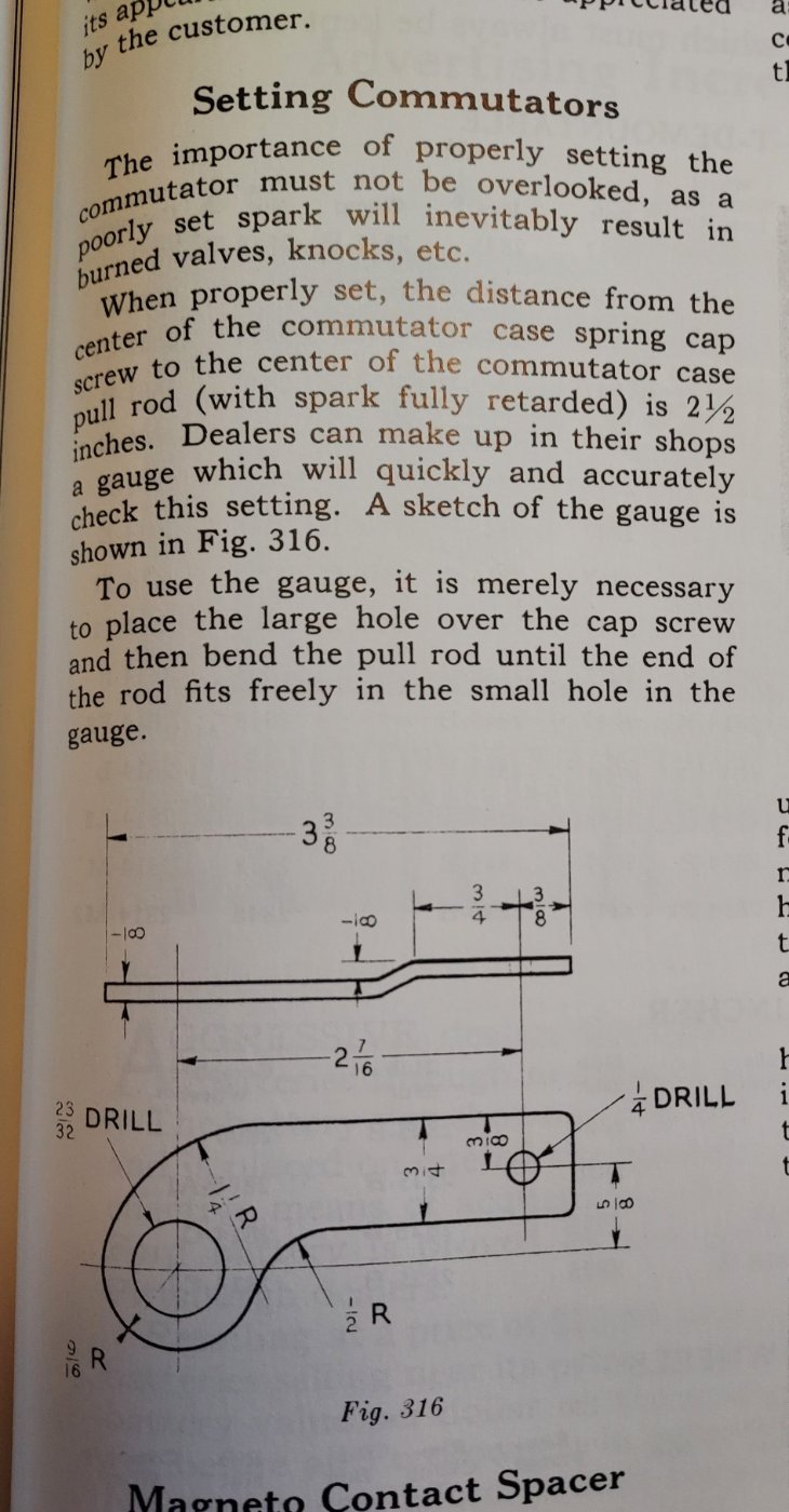

Looking at Tinkering Tips 2 I was reading about Ford timers on page 62. It says on making the gauge to set a Ford timer to have the holes 2 1/4 inches apart center to center. Looking at the picture included it shows 2 1/2 inches center to center. Interesting. That 1/4 inch could be a broken wrist or arm.

Typographical error .... Most references puts the center to center measurement at 2.5 inches. Could be best to ask the vendors if their Ford style commutators are made to actual Ford factory specifications .

Here is what the Ford Service Bulletins has for a timer gauge.

Tinkering Tips info may be subject to how to tinker for sure.
A good Ford source of the day was Murray Fahnestock, writer for Ford Owner magazines and respected then a good source.
His topic stated Ford standardized the distance from the short bent end of the timer rod that engages the timer shell lug, to the head of the bolt that holds the timer spring. That std. center to center distance is 2 1/2". He stated older Fords with magneto only ignition, the distance was 2 5/8". The change in distance was from the addition of electric start to protect the Bendix from backfiring.
As mentioned, std. distance is only for Ford original style timers.
