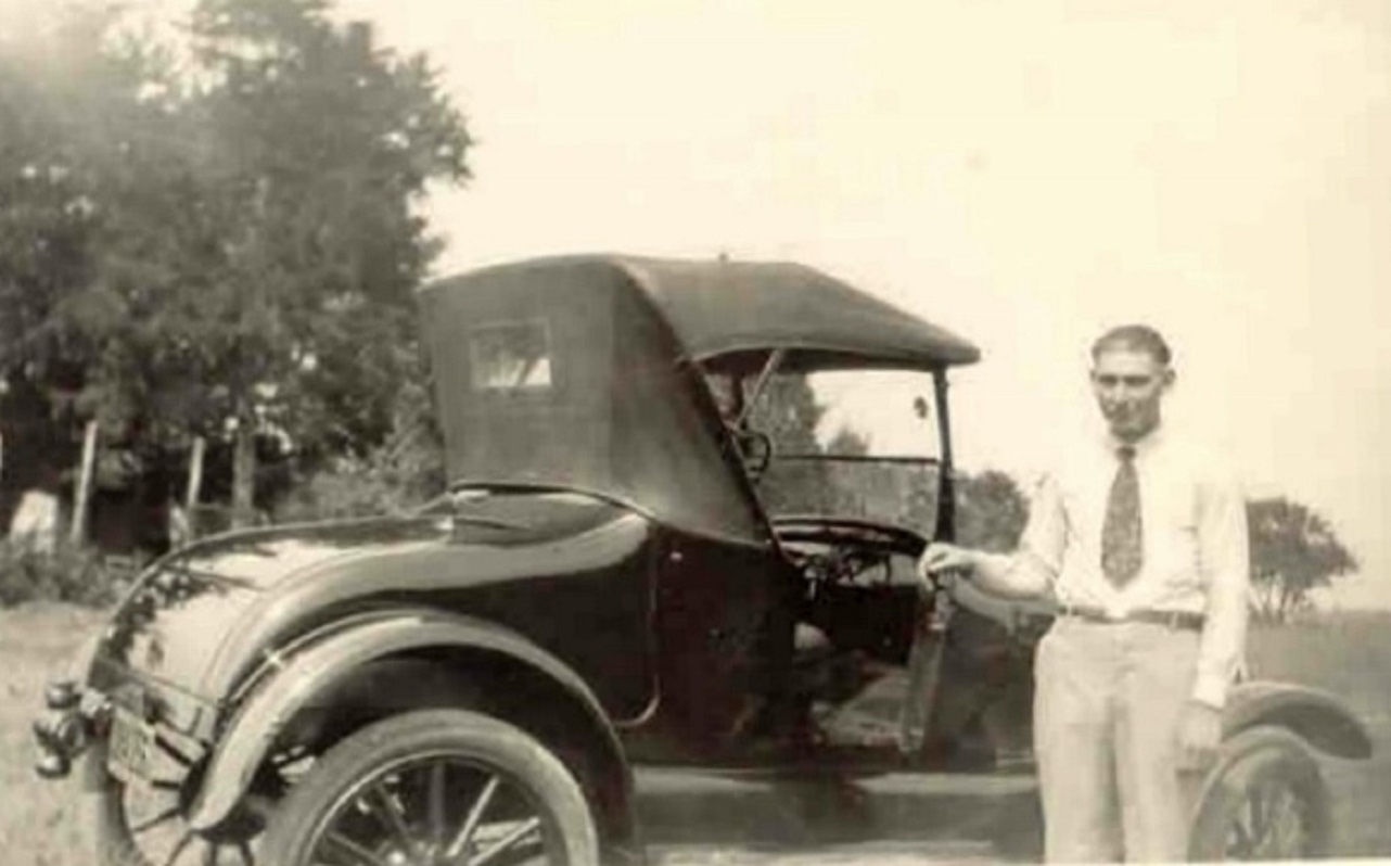

Determining if an original T or one from parts can be done with keen, knowledable inspection of body parts, assembly, engine number matching frame number (if made before late Dec. 1925), wear of chassis parts, and condition.Rayboy wrote: ↑Mon Aug 26, 2024 8:18 pmAn accqantance has a 26 T touring with black radiator shell, cowl lamps, wood wheels, no bumbers etc. I’ve heard of these as having been purchased by religious people who had problems with modern conveniences and showy chrome. Does anyone know more about the history of these cars? How many were made? How do I tell if this is an original car or one that was put together from parts? Any info would be helpful. Thanks. Rayboy
Early 1926 touring could be bought without electric so they came with kerosene cowl lamps, and non-demountable 30x 3 1/2" clincher tire wheels. These were the plain jane version, low price entry. As for cultural affinity, the plain Ford, in black was perhaps preferred, low price vehicle.
As for rarity, in 1925, 10% of tourings cars were sold as plain jane versions. So, likely same in 1926, 10% would be about 36,000 Model Ts, similar to this runabout below, plain non-demountable wheels, no rear spare rim or tire, black, and note the kerosene tail lamp, indicating without that new fangled electric starter and electric light equipment.

The photo isn't a "plain Ford" loss leader because they were rare and thus rarely photographed. Neat photo anyway.

It was my understanding that non electric T's, as discussed had kerosene side lamps as standard equipment. I have seen them on such an original "economy" roadster.
The period roadster photo doesn't have the sidelights I would expect. Could the owner have removed them for a more modern look? Everything else fits. Even no top saddles. Holes plugged.

John, maybe they removed the cowl lights to mount the wind wings?

The first picture of the non electric T was what I was referring to missing cowl lights.
