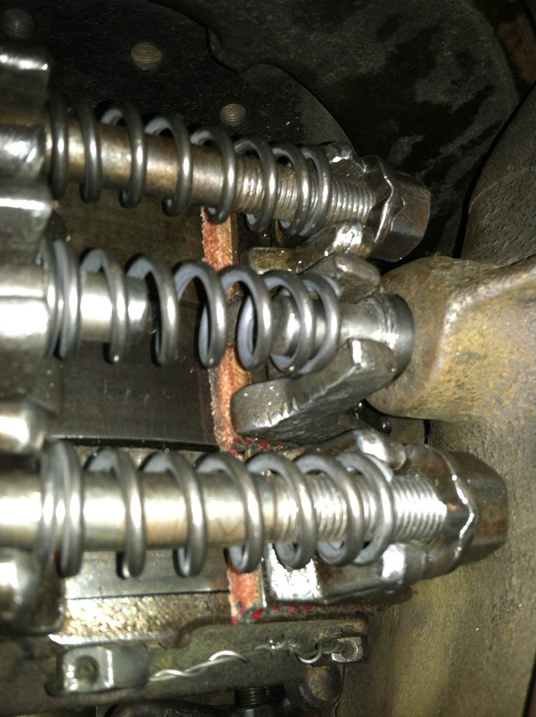

With the red and green edging, that one looks to be an original Montgomery Wards band liner. Had a set of them on my Speedster and liked how they felt. Same story though; the brake band wore much faster that the low or reverse. You can see the colored edging in the attached photo I took right after I installed them.

The cotton band lining in my car is similar to what Dave has in his car.  After about 800 miles of break in, the bands only occasionally need to be adjusted.  They now have over 3000 miles and doing well.  I have only one more spare set of cotton linings, which should take me to the end of my driving, unless I really get lucky.
