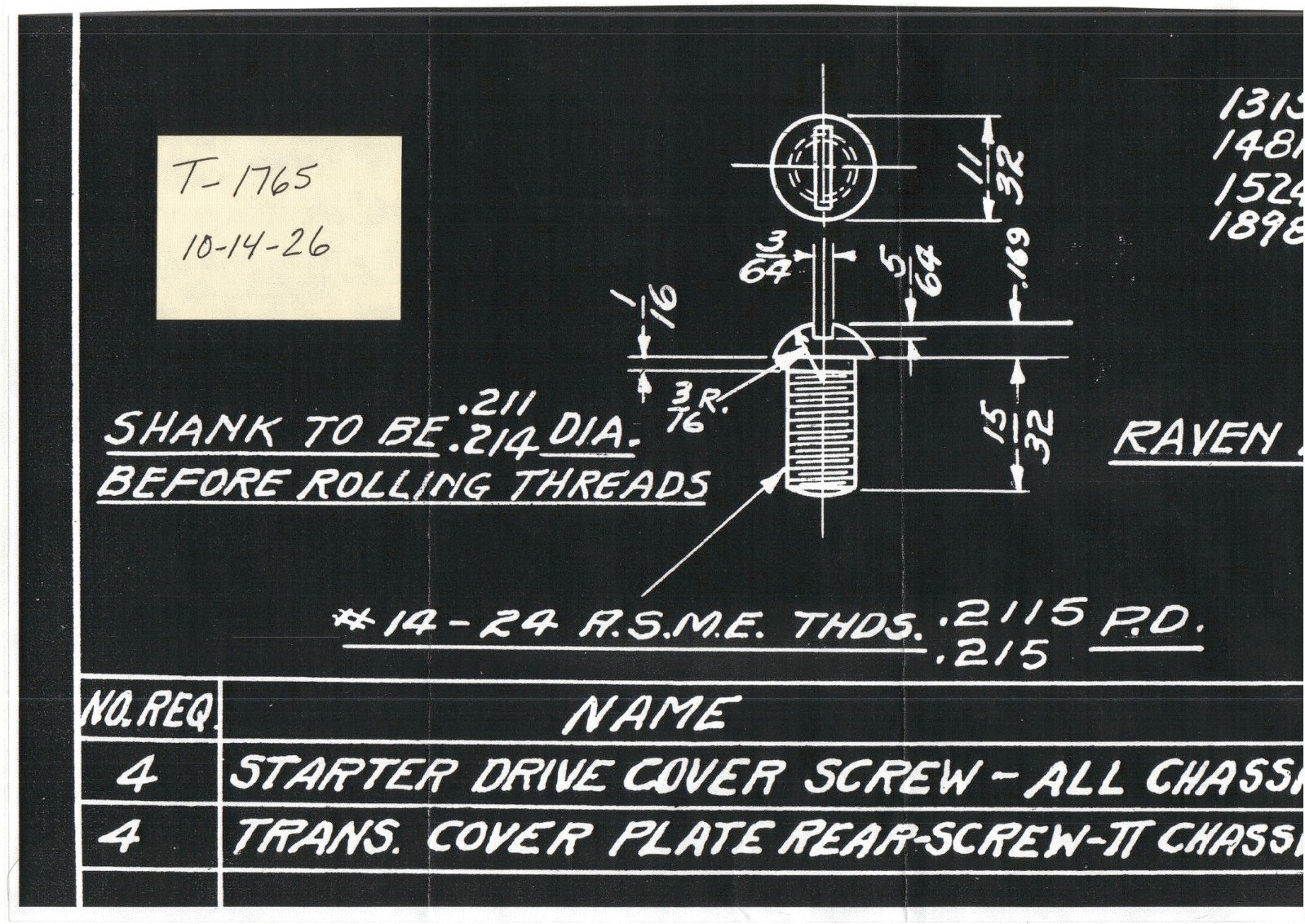

Here is the proof of the correect size.
Ron Patterson
Re: 1/4-24 x 1/2 in. starter end cap screw?
Post by Ron Patterson » Sat Aug 31, 2024 3:44 pm
As you can see Bendix cover screws are NOT Metric!

Those 14 X 24 Screws are used in several places.
The original starter ring gears used 14 X 24 brass screws.
I was told they are now being made in China with 1/4 X 24, due to an error translation there that leaving out the / was an American mistake.
The Mag Terminal screws on the earlier transmission covers are also 14 X 24, if I recall correctly.

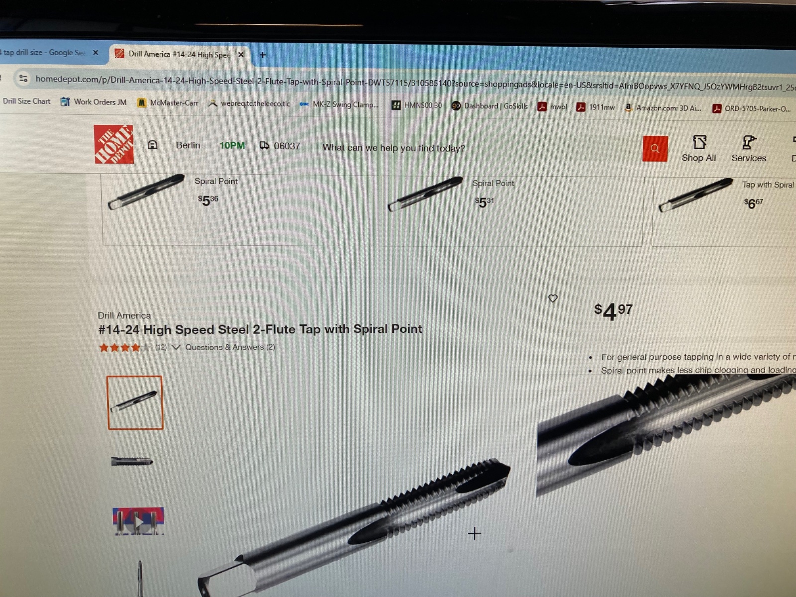

Post a link to that tap at HD

See pic. There is a self drilling sheetmetal screw of the same size and pitch, could be why they sell the tap. The thread percentage of the threaded hh hole may be greater than the standard H3, so I wouldnt run a tap in the hole unless needed as that would result in a sloppy thread. The hh casting holes are blind and just deep enough to accept the standard screw and washer. For chasing the thead, one may have to grind down the point a little to get the bottom threads cleaned.
Posts: 4458
Post by Jerry VanOoteghem » Tue Sep 10, 2024 9:26 am
RecklessKelly wrote:
Tue Sep 10, 2024 8:39 am
You're overthinking this. H3 is a standard thread clearance. It will be fine. The only possible issue is if whoever rammed in the wrong screws also damaged the HH threads. (They obviously did, or you wouldn't need to chase the threads. Just hoping the damage isn't too great.) Yes, if you can't buy a bottoming tap, then grind off the point, or maybe even just a bit more.

No. Ford used 14-24 screws because that was a standard thread size back then. They were available from many sources.
George Mills
Posts: 646
Last Name: Mills
Post by George Mills » Sat Sep 28, 2024 6:51 pm
As Jerry points out...#14 was a standard size when the Model T was designed. (There were further # sizes even higher but for some reason it appears that Ford chose to use the emerging SAE system for his bigger ones and thus the crossover). While SAE did exist and Ford was even an officer in the era before the T...personalities must of clashed as there is a whole lot of Ford practices that never made it into the SAE system by the time SAE was considered 'mature' about 1921or so.
As to the wives tail that the Chinese got confused and misread and used 1/4-24 and screwed up the whole thing in the first place? That's actually a tongue in cheek deflection that gained traction. For the first 20 years or so of mainland Chinese making product exclusive for export to USA in the Imperial measuring system, all of the companies that held export licenses had the standing rules and expectations right at quote time that the American buyer was to supply all actual tooling with the order so that the Chinese would NOT make a mistake in systems translation...changing OD and ID to metric is a slam dunk in either direction...Drills and taps and hydraulic fittings? Oh my... :roll:
