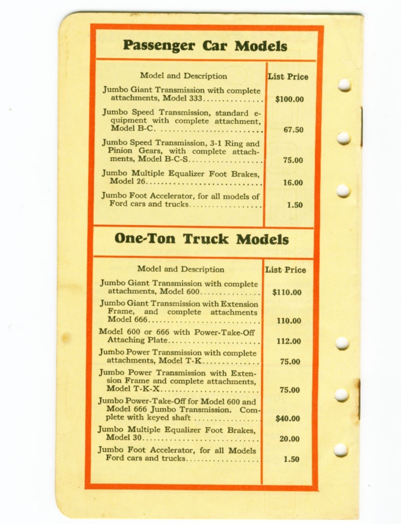

Decent auxiliary transmission. I don’t know the fill level for a Jumbo but with a Muncie or original Warford about 1/3 of the case with 85-140 is what I’ve seen. I’ve also seen the results of over filling sloshing out of the relief orifice. I’d encourage you to use a climbing oil product in addition. “ In 1923 the Price-Hollister company in Illinois began building the Jumbo transmission. Like the Muncie, this was a selective sliding gear transmission and in conjunction with the Model T Ford transmission, also produced 7 forward speeds and five reverse. Transmissions were provided for both the car and truck market, but in 1924, the company began producing the Jumbo Giant. This was basically a "beefed" up version of the Jumbo transmission, specifically built for the truck owner.” Attached is information you may need for you friend courtesy of Frank Brandi

Difference is the Giant version (333) of the Jumbo has 3 speeds. The Jumbo (B-C) only 2 speeds.

What is the value of a Jumbo Giant trans? I need to go look @ one for a friend & make recommendations, are they worth more or less than a
Muncie or a Warford? Sorry for the interruption.

As far as value. The same price range as I see for warfords or muncies, but they are less common.
I have paid $50 to $300 depending on the all important condition of all the gears & completeness.
