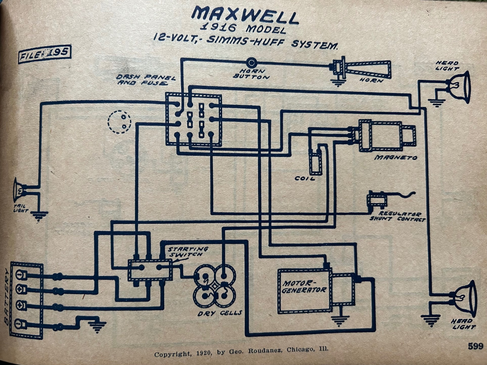

Here are some wiring diagrams that might help some, both the distributor and mag systems for same Maxwell.

Not sure if the coil and dry cells are needed once the engine starts? I think they are disengaged when the starter pedal is released. I will have to do more research on that…
