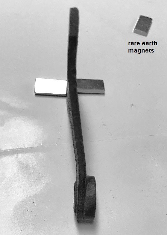

I just bought a Barn Load of part & just happened to remove two of those brackets off a rusty frame (may be different 2holes not 3) . Also the slider, washer that fits inside the slide groove & knurled knobs. The knobs may need some help.
I found on of the brakets & a knurled knob. These may be different than what you need as the shape of the bracket looks a bit different. It is not flat by any means as you can see in the photo. The 3 holes- the two outer holes were rivets and the center hole is for a screw

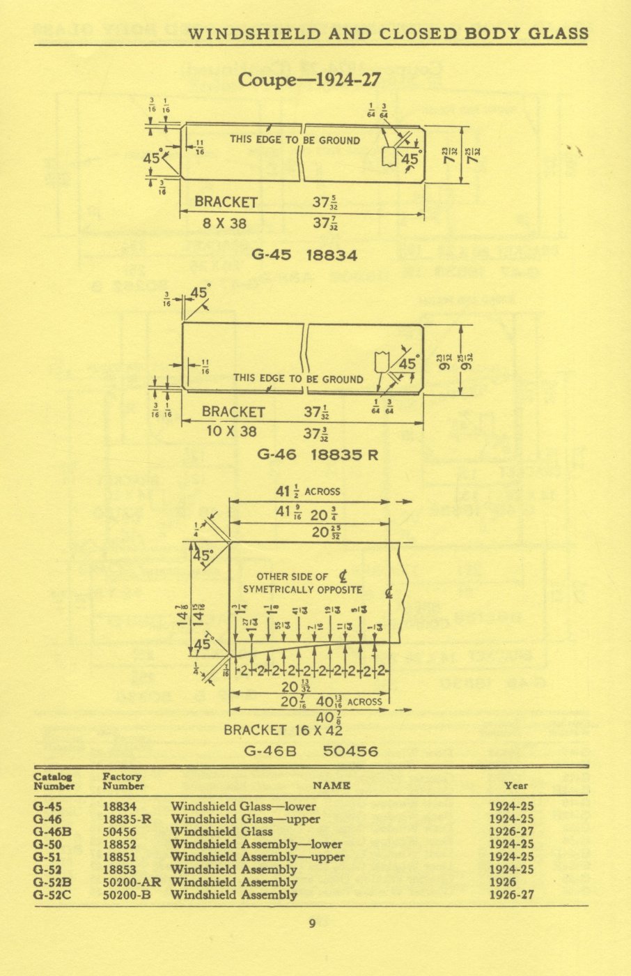

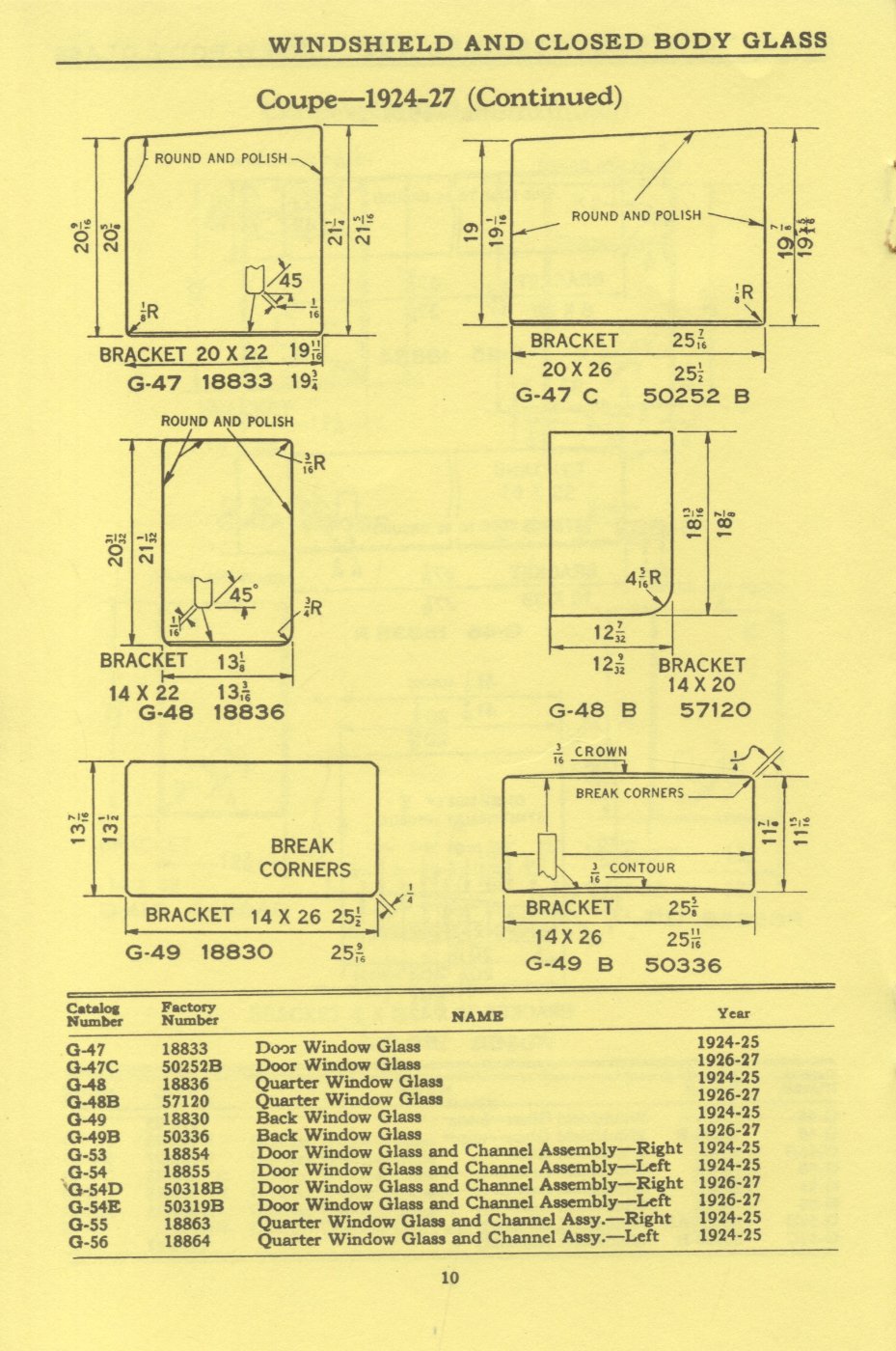

Here are the dimensions of the glass when you get to that point. The original glass was plate glass, but you'll want to use laminated (safety) glass, of course. :)

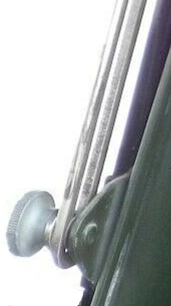

Thanks, but that bracket is for a different car, 3 holes not inline, stud too far away (sad face).
I have two sliders, beat up, but I can flatten them and paint black, maybe.
Mark, that image is better than the one I've got. I wasn't going to ask about glass yet but Haro Glass cut my rear windshield and side fixed windows in the coupe, wonderful job. They only ask that I bring them a cardboard template. Once my front windshield frame arrives in the mail, I'll make a template and compare to the official measurements. Do you run a bead of silicone within the frame for the glass?
Thanks to the ghost that PM'd me, but my CAD and geo-code days are over.
As far as the bracket, I see the knob and some other hardware pieces available at the vendors. Not sure which pieces to get but I do have a pic.

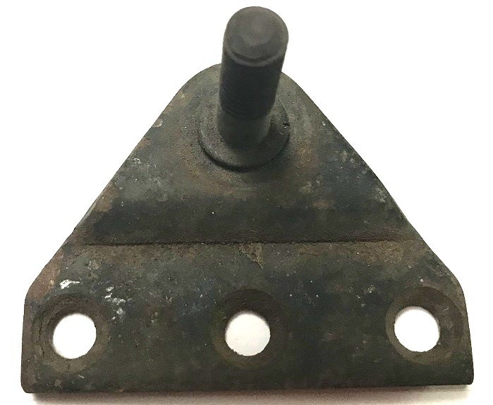

Found a photo from the back side of the bracket.
Found a piece of steel .116" thick (between 7/64 and 1/8").
Measured the screw holes on the A-Pillar and included a sketch of what I think the dimensions are.

James and all - I measured the screw holes on the A-Pillar and compared to the photos to guess (with a ruler) the other measurements, which is what I have been doing for years on our T. Amazed it's only 1/16" off. Right, the longer distance may also mean that the sliders may not fold all the way straight up in the closed position, while a shorter distance to the stud may prevent the windshield from sealing at all.
Here is a sketch the edge of the bracket.
I got the windshield frame in the mail centered it left - right measuring 9/32" average between frame and pillar.
The windshield frame, slider bracket has a 3/32" thickness until it gets to the slider which means the total offset should be (12/32" or) 3/8".
Subtracting the 1/8" washer at the base means maybe this particular fabrication should only have 1/4" offset (1/8" thick plus 1/8" bend). So use a combination of the two top views.

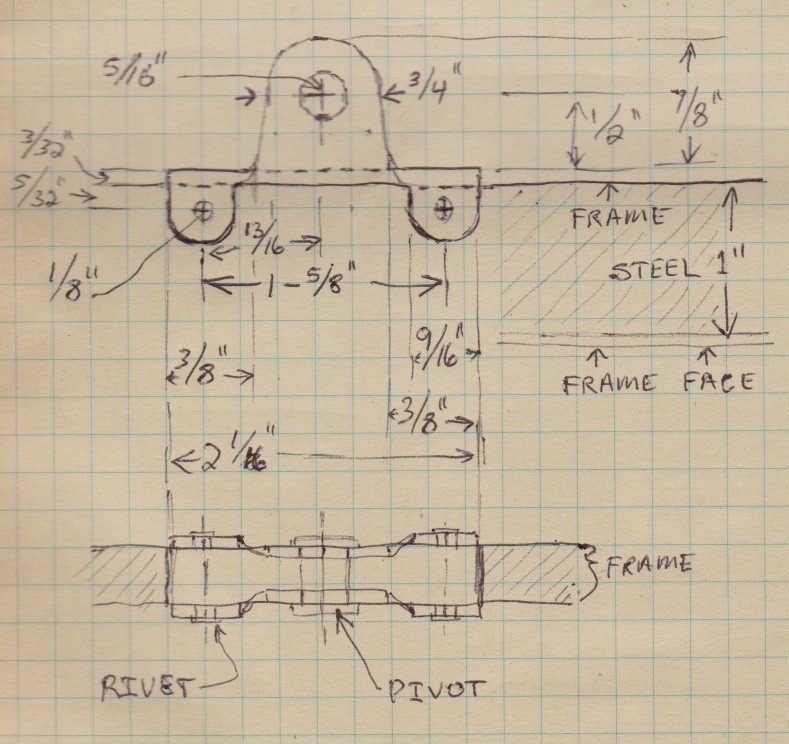

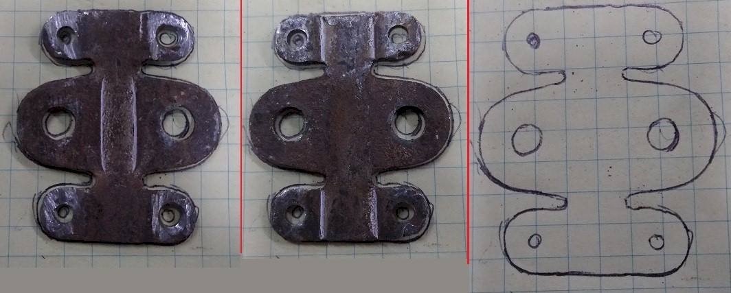

Instead of starting a separate thread for the windshield side brackets which mate up with the A-pillar brackets, I've included it here:
The Windshield frame brackets seem to be made of unobtainium for the '26-7 Coupe, even though new examples exist for the Model A. I didn't see any listed anywhere and the two on the rusted steel frame are "untrustworthy". But one is good enough for a pattern. Time to make them.
Option 1) Slit and fold a piece of sheet metal 3/32" thick over a steel 3/8" bar, held in a vice and fold the four outer tabs down around the outside of the bar. Then fold the two middle tabs up, flush within the outside edge. Finally drill the holes and trim to measurements.
Option 2) Create a flat pattern, do the machine work, stamp creases, and fold into position. (This is the way its done in real life if you make molds and jigs in a machine shop for mass production.)

Here's a sketch of the other bracket before I flattened it.
Unfortunately, the steel frame is 1" from back side of the face to the mounting surface of the bracket but the aluminum one is one 3/4". This means the slider (swing arm) connecting the windshield frame to the A-pillar won't fold up, unless this second bracket is modified. I guess I cannot use the old rusted out ones anyway.

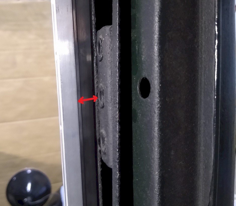

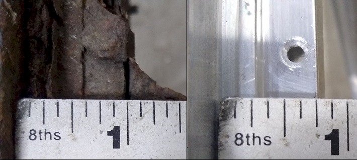

Post by varmint » Fri Oct 04, 2024 8:57 pm
Time for adjustments. Old and new. I was told that this is all I needed for both sides. Correct parts are not available and the old ones are too far gone.
Aligning the slider/swing arm and the aluminum frame with the camera, evidently, the 1/4" offset from A-pillar due to the bracket is still too much for this project. The official washer cup and rubber grommet will have to be replaced with a 5/16" thin washer to move the slider to the right about 3/32". In, a strange way, one cup washer per side is necessary.
The aluminum frame is at it's low position (not raised by 3/8" to the lowered hinge at the header). Also, I noted that the top hole of each bracket align. A-Pillar garnish moldings are not here yet but that won't change the design of bracket #2.
The aluminum frame is spaced away from the A-pillar to account for the rubber and yet the bracket, yet to be made, only needs to have 1/32" more center lobe by the sketch, even though the steel frame is clearly 1/4" deeper. I conclude that the rusty frame is incorrect.
Gonna make it long and trim later. Use the new pivots and the guide for hole size. Metal is 3/32" thick. Time to find a 3/8" bar.

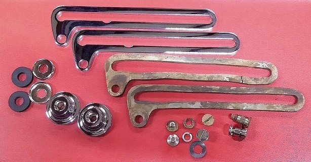

Well as I was sorting out parts from a recent Barn Find, this was in the bottom with some different style wing nuts, knobs etc
