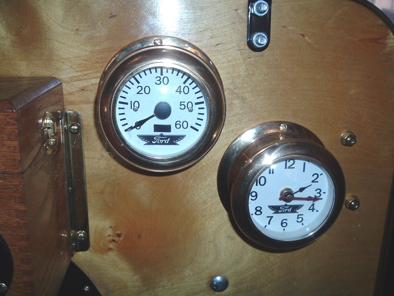

Latest project finished, started with repro brass ship's clock housings and transplanted the guts out of a 60 MPH GPS speedo, made matching faces on the computer and voila - expensive(?) looking gauges. Good enough for me.

They look great. Where did you put the GPS antenna?

Thats clever. Good to have for tuning purposes and speed bragging rights. In my town, hitting the upper limit of T speed will bring blue lights to your rearview mirror.

On the other side of the firewall under the hood former.

Real good job, Mark. I’d steal this but I decided that in my speedster a Speedo in front of my wife was a bad idea.

Very well done! Don't know what they cost, but could be a great side hustle.

Do they make this sort of ship's clock housing in smaller sizes? I'm thinking that an ammeter in such a housing might be a good project.

What the mag? What does it do to the GPS?

Distributor and coil and the metal former are not interfering with the GPS. No magnets on flywheel.
