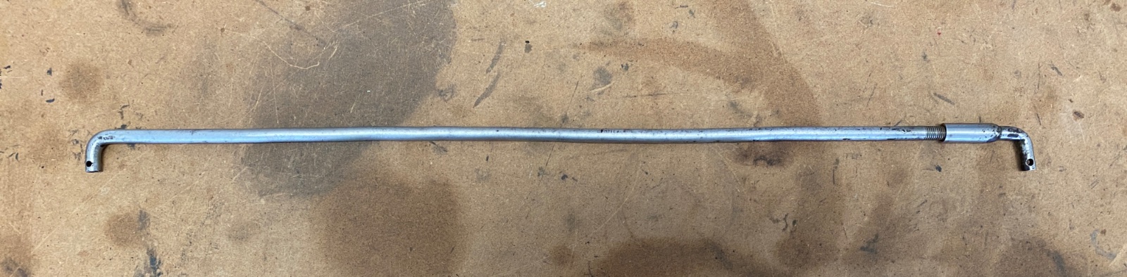

The original rod and adjustable end on my car had no traces of paint when I got them, and were a bright finished metal once cleaned. They seem consistent with the unpainted steering shaft. Wondering about the commutator rod now.
The adjustable end 3538 looks like it was phased out late 15- early 16. Exactly when I don't know. It's listed in 1916 parts list, but with a note to use the new one-piece 3535 rod instead.

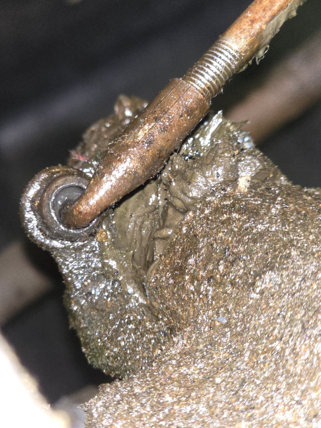

Pictures of the throttle rod and spark rod adjustable ends on my unrestored 1915 Touring, no. 679,2xx. Adjustable ends are at the steering column side. The rods appear to be bare steel and there are no jamb nuts. There are two different adjustable swivels - the timer rod has a ball joint with a nut affixing it to the steering column lever where the carburetor rod does not. It is held by a cotter pin. It is possible that the adjustable ends may have been black painted, but I would need to clean the goop off to be sure. You can really see it on the carburetor end, under there layer of grease. I will try to clean them later today to confirm. There are no adjustable ends at the timer side or the carburetor.

Interesting info. I thought the adjustable swivel on the carburetor rod was where it fed into the carburetor shaft.
Is what I read true for 1912 cars?
