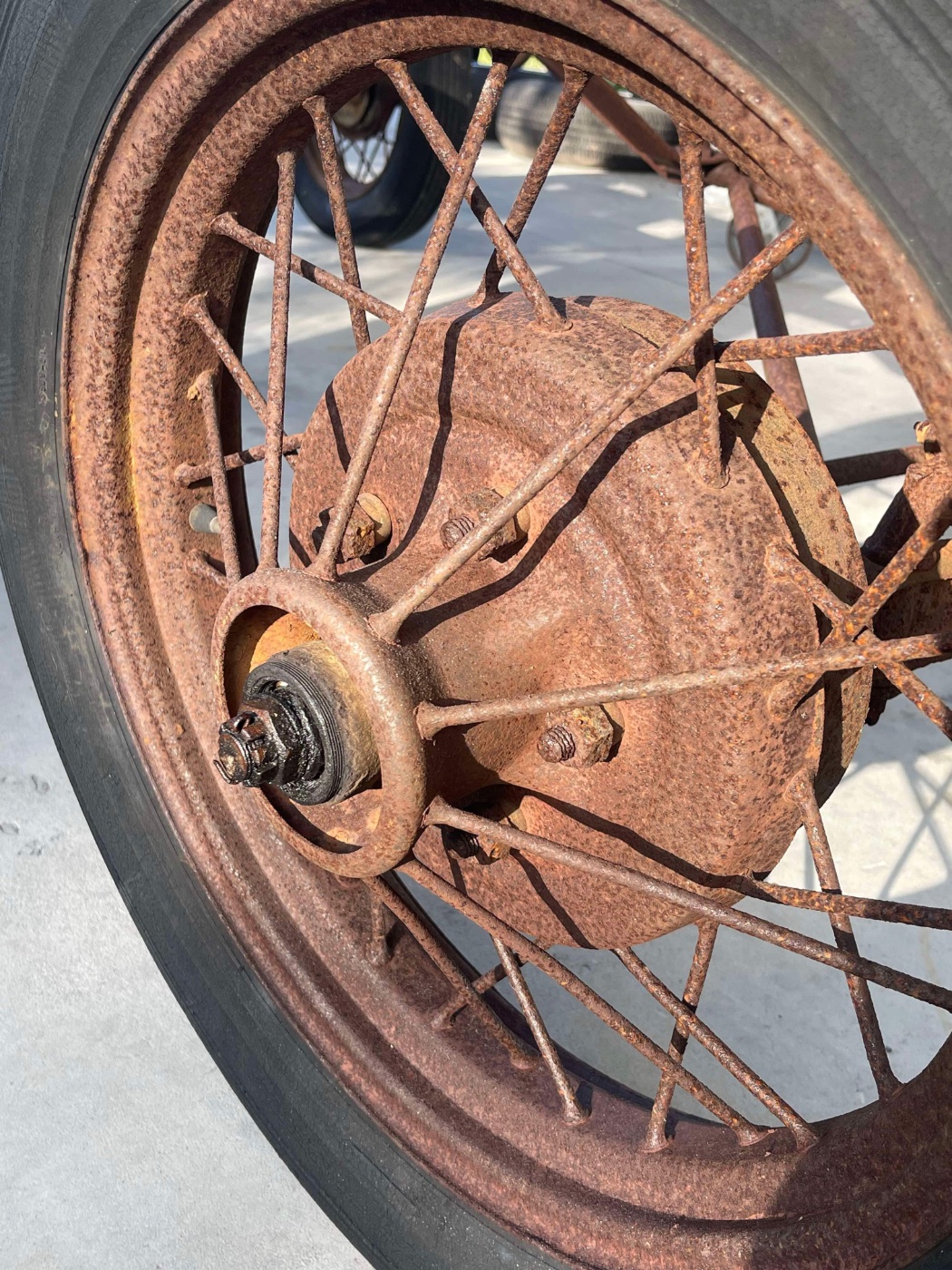

Those appear to be 19" A model wheels, so just undo the nuts and take the wheels off. It should have a set of A ti T wheel adaptors you could on-sell.
Getting the front and rear axle assemblies off the frame is easy enough if the cotter pins and nuts co-operate. With a good ring spanner, you can even shear off a stubborn cotter pin winding off the nut.
Penetrant will help. So will a decent lever to break the springs out of the frame cross members. Then just load it up.

Probably wouldn’t hurt to keep the frame in good shape during the tare down. I can’t tell if the frame is an earlier frame or a later frame that’s had the running board brackets removed. Looks like the wheels are usable to for a speedster with Model A wheels. Most of the other parts look good and remember that one man’s junk is another man’s treasure.

Ok better pictures on the Wheels. I assume from the comments that these are Model A wheels and hubs based on the photos. Hoping the will be easier to remove.
- Posts: 6581
Re: Frame and Axle Disassembly
Easy way to tell Model A wheels: They have strengthening ribs between the bolt holes

Indeed they are A model wheels, the later 19" ones going by the edges of the rim. Gone is the rounded edge so familiar with T model wire wheels, and the 21" A wheels. I couldn't see that detail in the first photos, but they did look to have the larger hole for the hubcap used on the 19" wheels.
