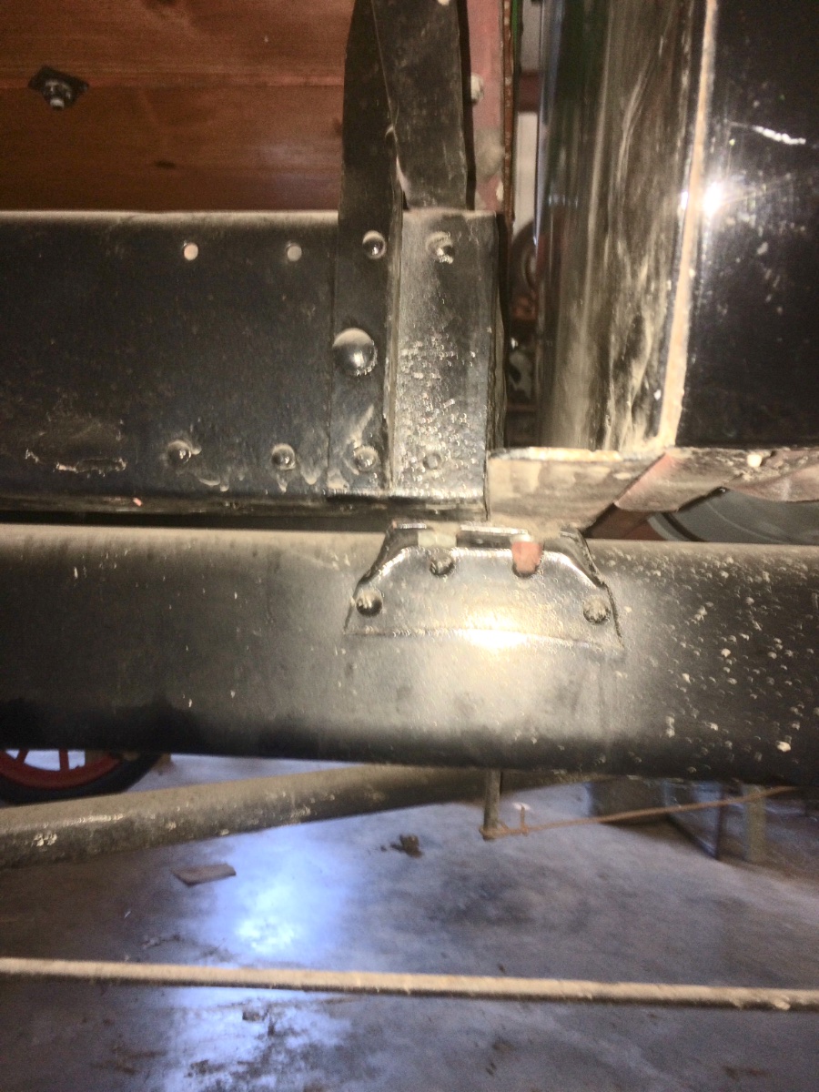

Well, now I got my old butt on the creeper and rolled under the C Cab. Understand that only 5 % of TTs were sold with Ford Cabs - either C Cab or Enclosed Cabs. They’ll have the frame-to-body brackets like my attached picture. However, if you have the car body-to-frame brackets, yours was one of the 95 % that was sold as a chassis to have made locally a custom wood cab. There are two peculiar and different brackets. A metal working fabricator could probably reproduce these. All 3 pictures taken from the right side.The first 2 pictures are of the rear bracket. The red oxide painted bolt/nut fastens the body. The other fastens the bed. The last pic is the front bracket from below. If you don’t have a Ford Cab; all you need is the car body-to-frame brackets. Good luck

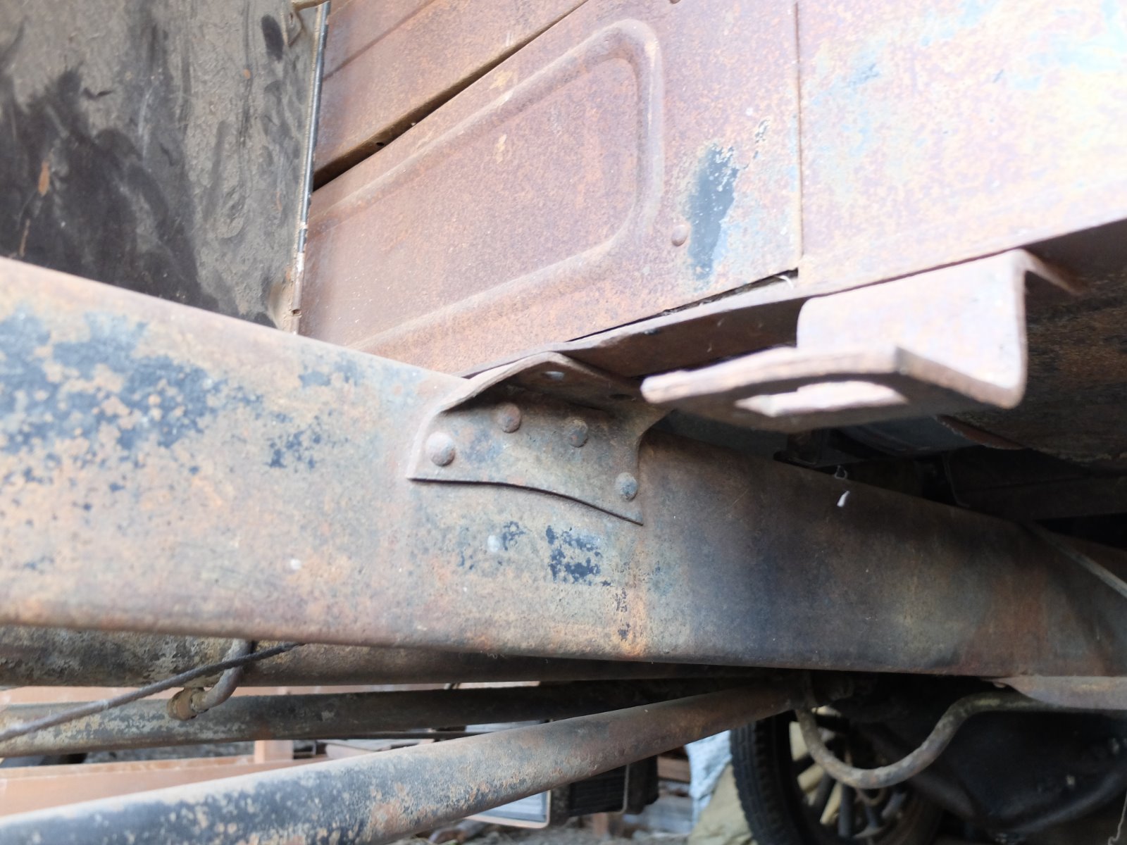

Re: Need TT bed info
George, mine is a factory closed cab truck. It has the same bracket at the back of the body as yours, but only uses the rear hole for the body and whatever bracket for the bed there was. This tells me that the C cab must have been slightly shorter since it used the front hole. The pics below show my bracket from below and above. Any idea what the second bracket you see in the second picture was for?

Ralph, I sure don’t know what that offset bracket w/ 3 rivets and rectangular opening ....is for. Have had 3 Enclosed Cab TTs and never saw that.
Ralph,
Take a look at this thread: http://www.mtfca.com/discus/messages/29 ... 1199242983
It shows the differences in cab mounts. You're picture seems to show the earlier single hole rear cab mount prior to them going to the dual hole rear cab mount. I believe that my TT has the front of the bed fastened in the second rear most hole in the picture. I'll take a look today and see if I can get some pictures. I've got a later Ford bed on the 27 TT and I have the original Ford Truck bed from my 26 TT. I'll see if I can get some measurements from it as well. - Matt
