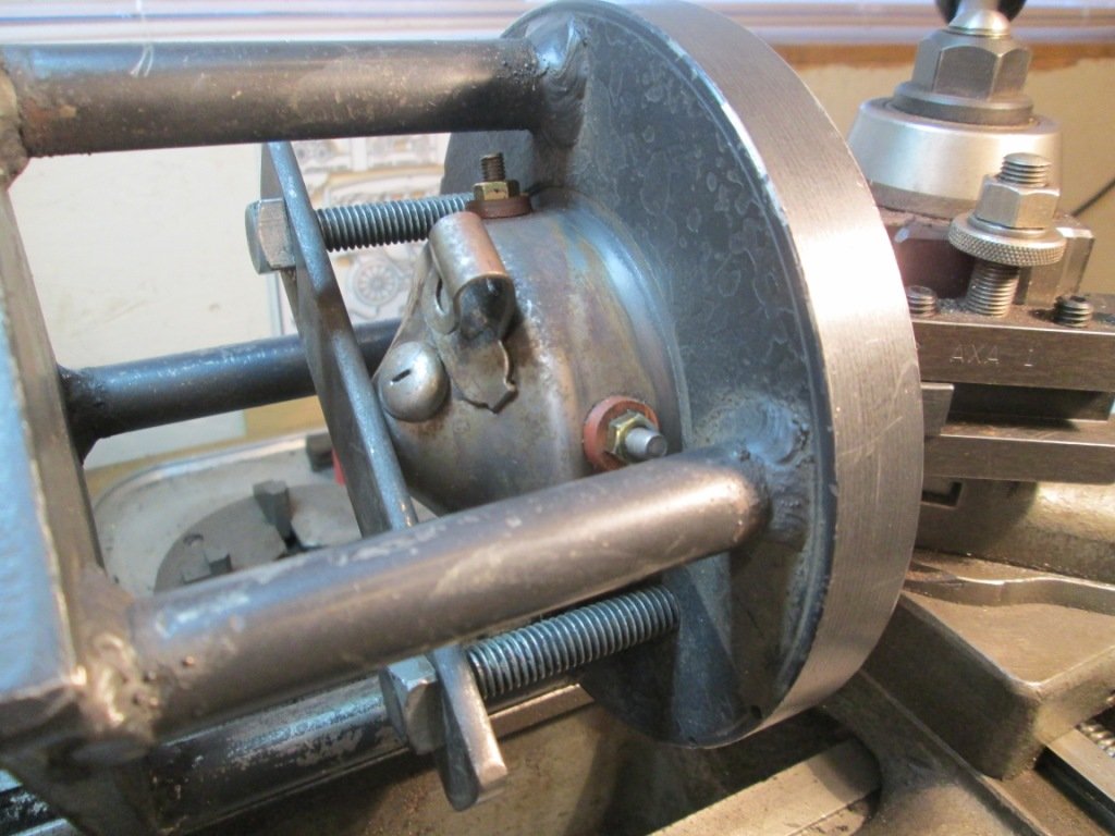

I can imagine it was running quite rough with all that bouncing around - if you were closer, I'd turn it out in my timer fixture.

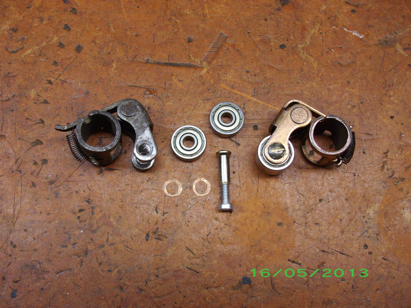

To clean the timer I use the following :
And for the roller I use two ball bearings ,till now it works for me

This is the best solution I've seen, did you make this jig yourself for your lathe? If so, you could probably make a bit of cash making them, they'd be a hit I reckon!
If I had access to a lathe, I'd definitely buy one from you.

Toon, how are the bearings holding up with the balls and races being part of the electrical circuit? I tried using those and they didn’t last very long…
