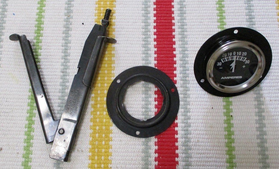

Use a different ammeter with an ammeter adapter.
This is one I did for a 12 Volt Alternator.
This is the tool.
This is the tool.
