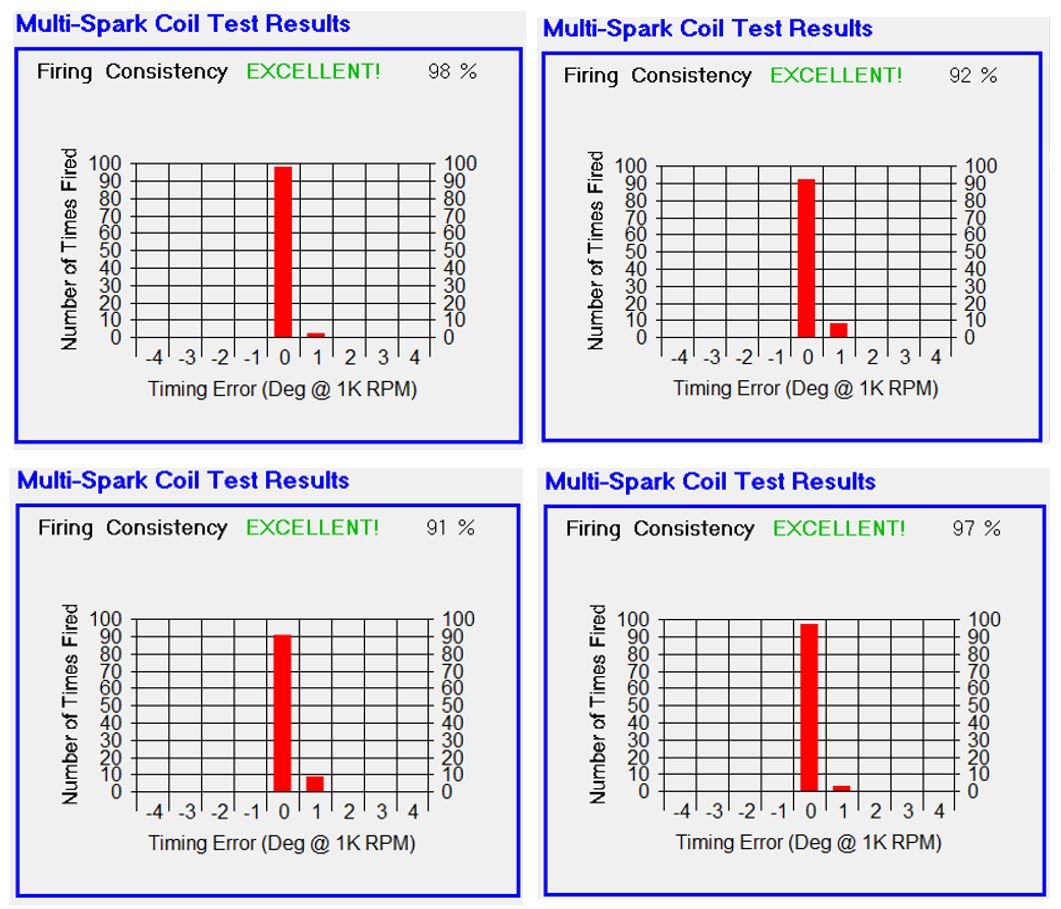

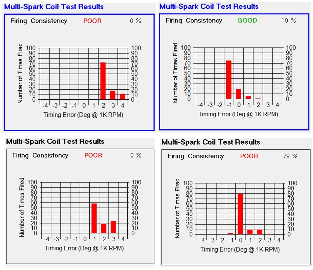

Comparing ECCT test results on any other coil testers is like comparing Apples to Watermelons. The ECCT coil test measures the time the coil takes to charge up and fire the very first spark responsible for engine combustion. All other Model T coil testers measure average coil current as an indirect approximation of firing time. For example, the HCCT measures and displays the average coil current of hundreds of sparks. The best way to test how well your ECCT tuned coils perform compared to other coil test methods is in your car on the road.
ECCT tuned coils for equal and consistent firing Time will result in optimal engine performance provided all other ignition variables are in good working order (ie Timer, spark plugs, wires, battery/magneto, carburetor, valves, compression, etc.)
More information on this topic can be found here: https://modeltecct.com/faqs

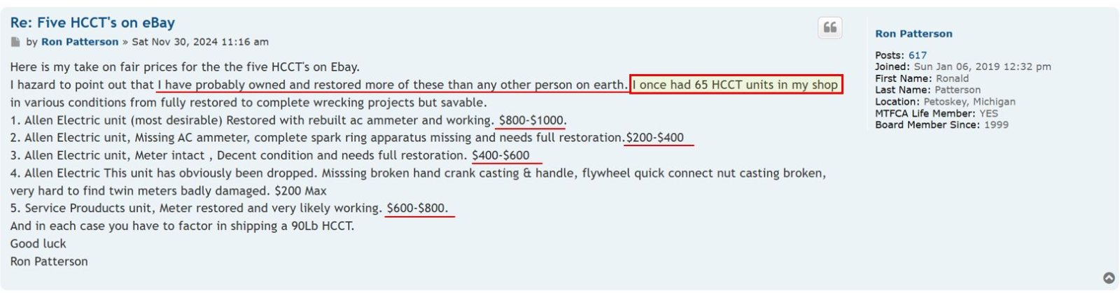

David, thank you the courage to share your experience with the ECCT and the engine performance using ECCT adjusted coils tuned for equal and consistent firing time. Unfortunately, that makes you a target of Ron’s snide comments which deter others from sharing their similar experiences here. No one should have to defend or justify sharing their honest experience that others may find of interest or benefit from.
Ron, has long rejected the merits of the ECCT as a useful and effective Model T tool capable of improving the experience and enjoyment of the Model T enthusiast. Despite sound engineering principals it was developed and consistently positive reports it receives such as yours. 10 years of sowing discord challenging posted praise, dismissed as hype, branding discussion as advertising and marketing infomercials, dissuading its use and even efforts to ban ECCT discussion on this Forum. I never understood the vitriol and often pondered Why? Then I read his recent post below and suddenly, it all seems to make perfect sense and far simpler than you give credit.
https://mtfca.com/phpBB3/viewtopic.php? ... 53#p350201
I think its past time Ron cease the charade and the snide comments whenever someone dares share their ECCT experience here others may find of interest or benefit from. A despicable disservice to the hobby and the Forum all these years that has nothing to do with merit.

Re: A question for the experts
Here are typical Multi-Spark firing consistency results of 4 properly adjusted coils using a HCCT by an experienced HCCT user. 100 sparks are fired at the rate of 2000 RPM. The computer keeps track of the time each spark fires and plotted on graph for each coil. The firing distribution results may vary a fair amount each time the test is repeated for each coil.
If your coils test similar to these on the ECCT, they were very likely tuned using a HCCT
Shown below are typical Multi-Spark firing consistency test results of 4 properly adjusted coils using a ECCT by a typical user. A nice attribute of the ECCT adjusted coils very repeatable results. If your coils test similar to these on the ECCT, they were very likely tuned using a ECCT.
If your 4 coils test similar to these and told they were adjusted using a HCCT, you are almost certainly being deceived.
These are results and observations in my experience and consistent with other users. Hopefully Dave and the others can openly share their own experiences, lessons learned and tips going forward without scorn. The best way to judge how well your adjusted coils perform is in your car on the road. If they perform to your satisfaction, coil tuning objective achieved.
In some instances, no difference in engine performance may be noted between various coil adjusting methods. In such cases, the variation in coil to coil firing time may not be the sole or primary performance limiting issue. Timer, spark plug, wires, coil box, Low cylinder compression and carburetor/fuel issues could be present and of equal or greater factor in limiting engine performance. It is, after all, a spark ignition system.
