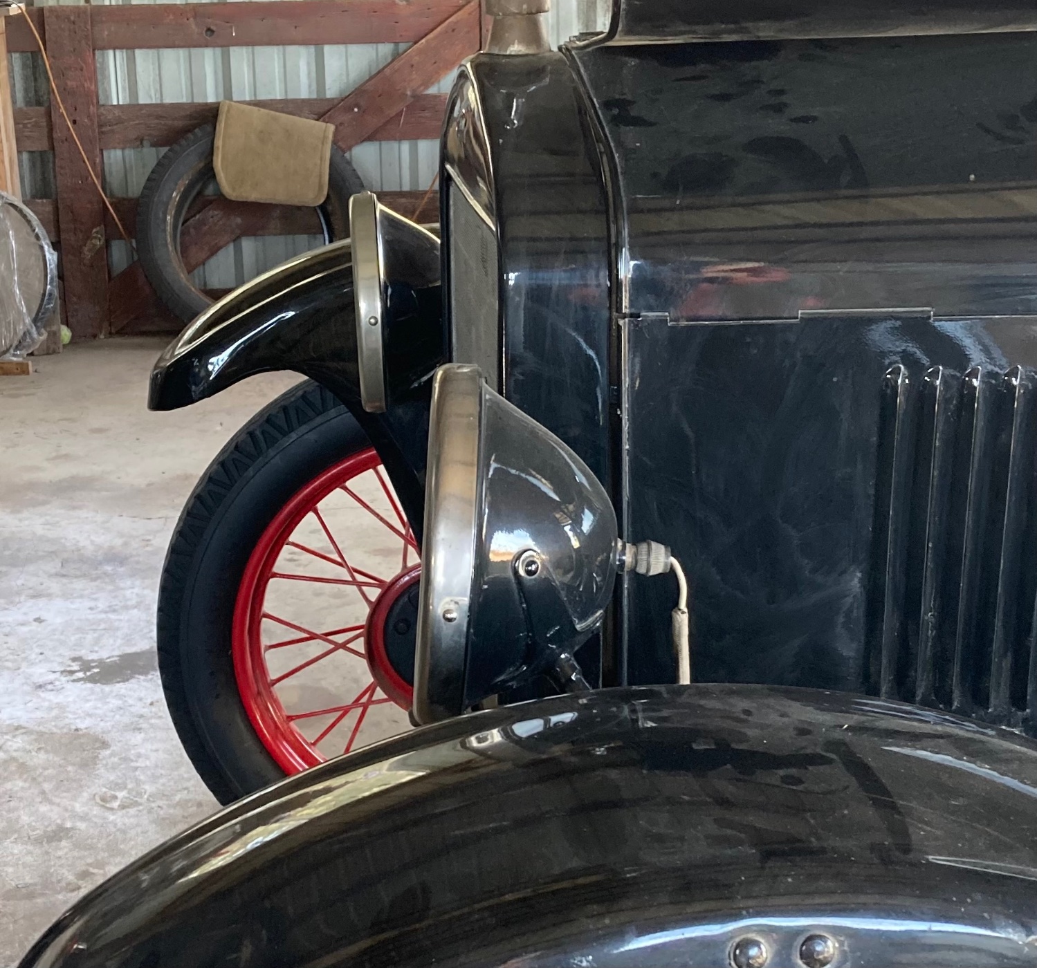

… or advice to make one. Somewhere in my over half century of fooling with Model Ts, I either read about or heard about there being some kind of era tool to adjust the ‘stature’(?) of a headlight’s direction. See by my photo that my ‘26 roadster’s left headlamp is canted too high.
I’d like to correct this without having to remove it and impact the sheet metal fender. Are there any ideas ?

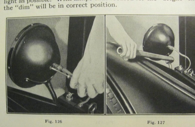

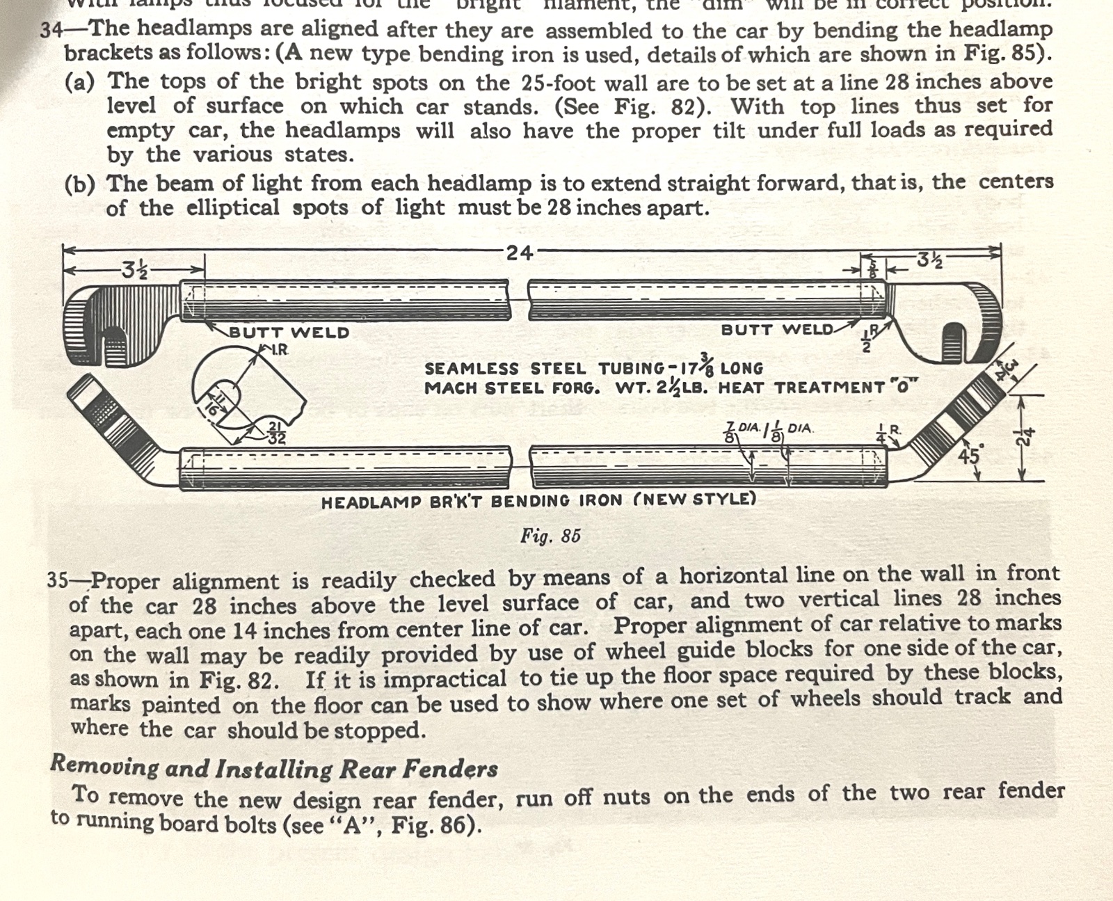

I've used a pipe wrench, jaw fastened to the stem. That wrench had a slotted opening on the end of the handle, so place a beefy socket extension rod into the wrench handle for more leverage and pulled the lamp down to proper shape with the other.
The tool is shown in this photo, but Ford said to use the tool or a wrench.
This is the Improved Car tool for the headlamp on fender mount, note the length is about 2'

George, The particular headlights you have will need to be taken off, bent, put back on, repeat, until you get them aimed right.
For those who don’t notice or don’t know; Those are very early ‘26 fender mounted lights. They are not mounted to the iron down by the frame, but to the fender sheet metal skirt and stamped steel “fender iron” up on the skirt of the fender. They are not mounted on a bar as in the rest of ‘26-‘27 production.
An attempt to aim those with a bending iron puts strain on the fender.

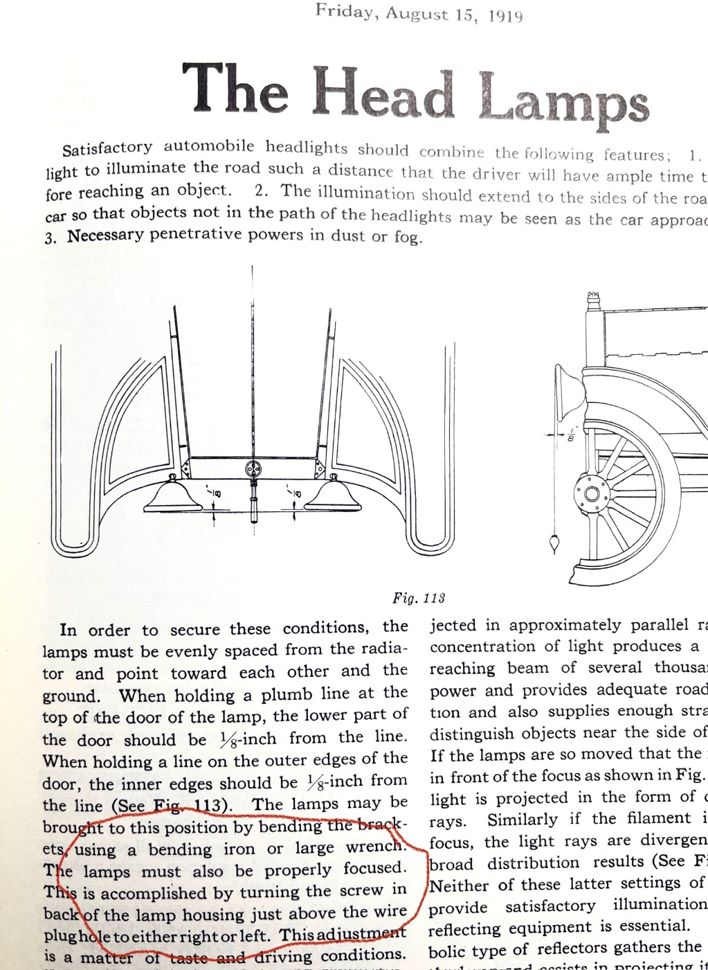

Good advice all ! I shall follow it. Thanks especially to Dan Treace for the 1/8” plumb line info when a string is placed at the upper headlight rim and the 1/8” distance that string should be from the lower headlight rim. ..
I did not know that
I did not know that
- Posts: 4471
Re: Headlight Adjusting Tool needed…
Dan has all the best info, and the period documents to back it up!George House wrote: ↑Thu Jan 16, 2025 2:36 pmGood advice all ! I shall follow it. Thanks especially to Dan Treace for the 1/8” plumb line info when a string is placed at the upper headlight rim and the 1/8” distance that string should be from the lower headlight rim. ..
I did not know that![]()

The 1926 (early) headlight stalk is not vertical. It slants in toward the radiator shell. I'd be very cautious about bending the stem with the lights mounted on a car with nice paint on very straight fenders. The lights and fenders on my car are like the ones in the photo George posted. I added a later 1927 headlight bar to my car. It doesn't fit just right, but adding 1/2" spacers under the "foot" on the earlier style headlight stems allows bolting them to the later type brace with longer bolts thru the fender and stamped fender brace. While not an exact fit, it does brace the fenders solidly and it keeps the fenders and lights steadier. The bar I used is the stamped steel type that uses the headlight buckets with a ball and socket type attachment/adjustment. On my installation, the "sockets" are left empty, and adjustments would have to be made by bending the stalks, or it could be done by filing or grinding the spacers I used at a slight angle.

Mine on the same side is bent the same way. I rarely drive at night, so will just leave it as is.
