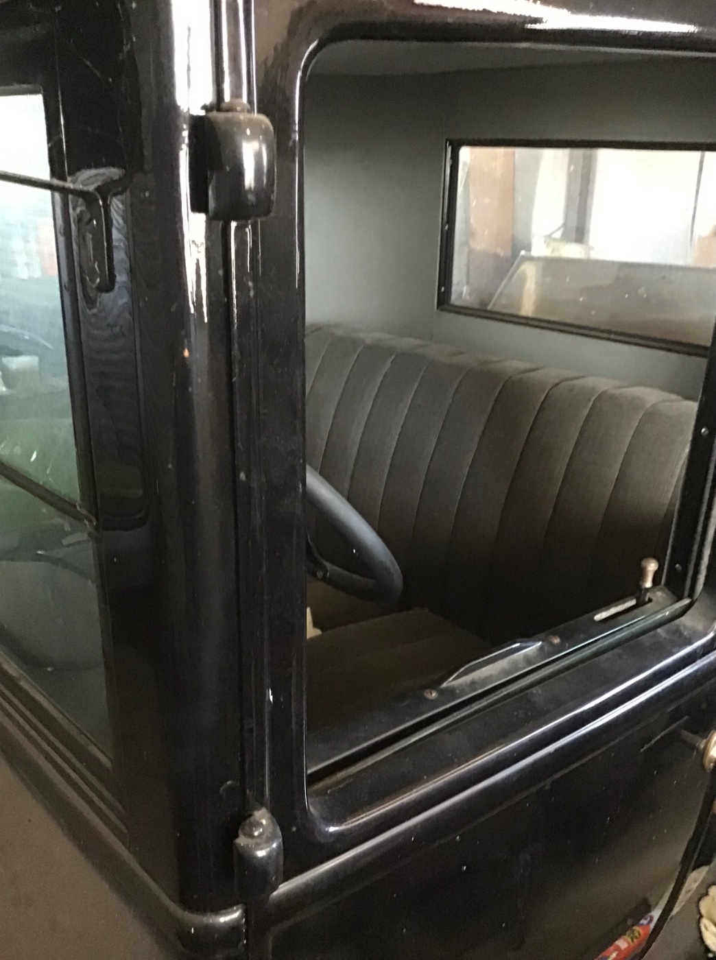

Here are some pics of my 24 Coupe that can help in telling the differences in the late 23, 24 and 25.   As Wayne stated the late 23’s are the 24’s that were introduced in late 23.
The 24-25 Coupe doors are hinged at the front and they have the cowl vent. The earlier Coupes didn’t.
Shown is the clip and where it’s attached to install the backrest. When installing the backrest you raise up the backrest and clip it to the catch that is screwed on the package tray. The backrest wood frame has 3 wood ( clips ) that slide into the bottom of the seat frame. I don’t know if the earlier Coupe has the same back rest clip or not. Others might know. The Ford body parts books don’t list any metal backrest clips that I’ve found. All it says is backrest assembly.
I’m pretty sure this is the way it came from the factory. When I restored the car several years ago the inside of the car hadn’t been changed other than the tacked on seat cover my Grandfather covered it with in the 1940’s.
