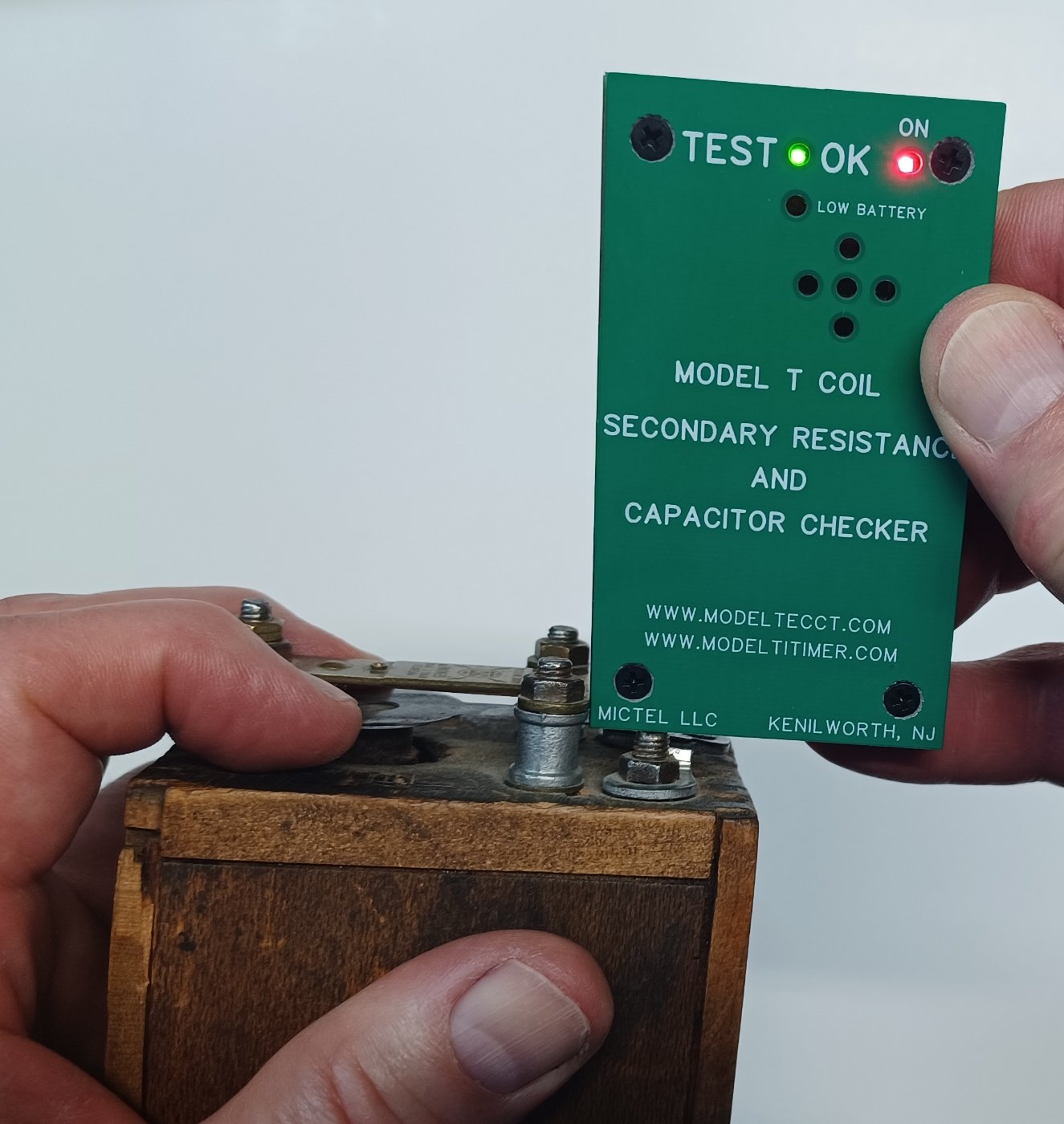

Just finished building the prototype Model T Coil RC Tester. First pass success!
The circuit simulation software really is that good in helping to get it right the first time.
Only problem is.... the tiny beeper that fits in the compact case puts out a tiny sound that you can hardly hear.
Question: Do you think the Beep is really necessary?
The Green LED tells you all you need to know and does so without broadcasting what you just learned about a perspective coil.
Coil Secondary Winding Resistance Check: 1850 to 3840 Ohms = OK
Capacitor Value Check: 0.47uF +/- 20% = OK
Inside Voice: "Humm, That's a great coil for $10..." OK, I'll take a chance on it for $10

Update: prototype circuit boards are due in this week. I was able to incorporate most of the great suggestions made here.
If all goes well, should have a production run made late May or early April.
Thank you for all the great comments and suggestions.

Mike sent me one of his testers. It’s well thought out and very portable.
Thanks to Mike for getting a reliable tester back on the market!
Definitely a welcome addition to the hobby!
Brent Mize
The Coil Doctor

Pocket Coil Checker - Update
Several design revisions were made thanks to great feedback from folks here and the Model T FB groups.
The new Digital Version is the same business card size but has significantly fewer components and more features:
1. Power turns on automatically when secondary resistance measurement is detected
2. Power ON indicator
3. Checks Model T coil secondary resistance is within its nominal range (2200 to 3800 Ohms)
4. Checks Model T capacitor value is within its nominal range ( 0.47uF +/- 20%)
5. The TEST OK beep can easily be turned off (or on) based on user preference
6. Low battery alert is signaled by 4 short beeps at power up and flashing Low Battery LED
Thank you for the helpful suggestions to make a Model T tool with feature folks need and want.
A few more bugs to workout so if there is a feature missing let me know soon! Should have them available by June.
The Pocket Coil Checker instruction manual can be viewed here: https://img1.wsimg.com/blobby/go/f76807 ... 6840302570
