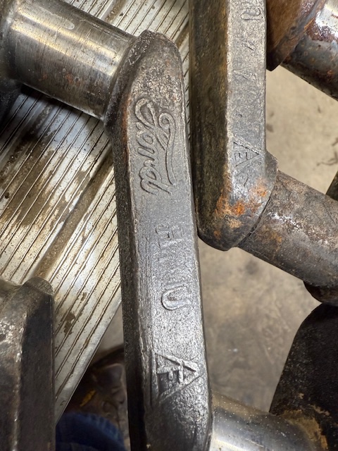

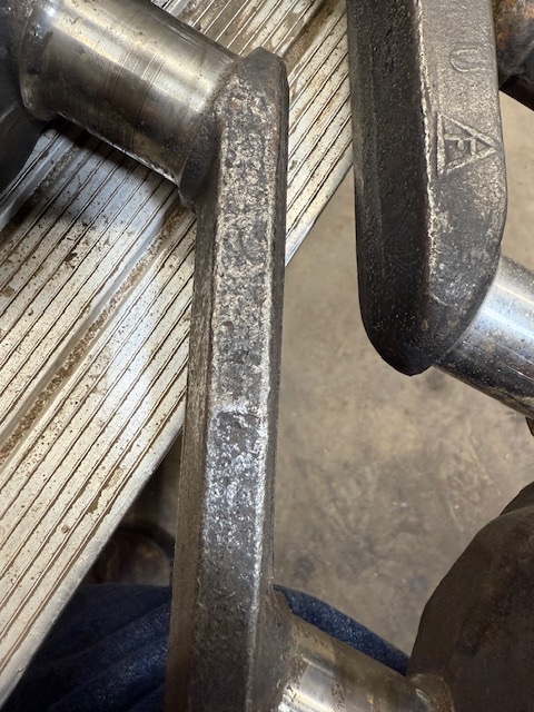

Going to take a few crankshafts to the grinder.
Lining them up I see difference in web thickness, any advantage to either. None are marked EE that I can see, I’ll be cleaning them up and taking some measurements to see if they are worth grinding. Have a need for 2 of them now and a spare is always good.

Post by RajoRacer » Sat Feb 08, 2025 7:26 pm
I'd spend my regrind $'s on the straight web '26 - '27 design.

Have you had any of them magna-fluxed? That would be my first step.

Plan to after I get them cleaned up. Need to brush them with some solvent, wire wheel some rust off.

Post by Erik Barrett » Sat Feb 08, 2025 10:10 pm
Two of them are 26/27 cranks. Magnaflux those and have them ground if they pass. The rest are earlier. They are like a hand grenade with the pin pulled. Sooner or later…. I do not use them. In fact l have scrapped so many of them over the years I could have made a neat picket fence if I had saved them all. I have not been buying crank cores in the last few years as I have a couple dozen ground late cranks ready to go and about half of my customers are using new cranks anyway. Even when I was looking it was tough to find cranks that I could send to my grinder. Early ones I don’t look at. Late ones are often cracked or worn below .020” undersize. EE cranks are tougher but the steel formula is softer and they wear faster so I often find them with the rear journal already .030” under. So I don’t even look at cranks at swap meets anymore. Scat cranks have supply issues and are getting real spendy with a long waiting list but there is an alternative available and in stock right now. I had one at Turlock and I expect the manufacturer to bring some to Bakersfield/Porterville.

Post by Craig Leach » Sun Feb 09, 2025 12:00 am
I was told that Henry only made to cranks for Model T's those that have broke & those that will! Personally I think alignment is more important
than we are willing to achieve & the older these cranks get the more important it is.

Post by Joe Bell » Sun Feb 09, 2025 7:54 am
If you are in a pinch the AA crank is next one down from the EE they have less chromiun in them, stay away from any crank that have been ground off on the throws some are really thin from balancing at factory, more chances of breaking there, I am with Eric the 26-7 is my choice of cranks with the thicker throws.
