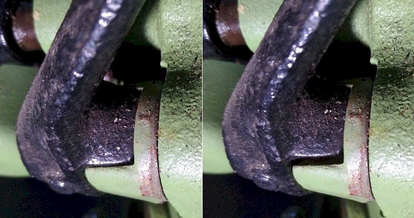

It's more stuck than anything. I replaced the three pedal return springs and tested the brakes (stopped the wheels from turning) but it stayed.
1) Pedal is wedged against the hogshead.
2) Back and forth play in the pedal.
3) Gap in the brake pedal.
So, how to fix?

I think that your band is probably not tight enough.
Do you put on new pedal cams while you had it apart?

From your 3 descriptions & the last pix I have to ask: Are you aware the brake pedal shaft pulls the band tighter as the pedal gets up on the cam?
The pedal pushes away from the HH base cam thus pulling the band ears closer together. None of your pix show the movement of the pedal outward activating the brake band.
Or is it possible the pedal shaft fit is too tight to freely return back to its neutral position?
I notice the cams look dry. Put some oil on the faces. without lubrication, cam faces will Gall & bind up to the extent full leg pressure wont activate the brake. I have experienced this myself with well sealed (leak-less) pedal shafts. Sealed shafts must have the cams manually lubricated.

Yes, I'm aware that the pedal lever needs to contact the cam before the pedal is forced to the left.
Pressing the brake does stop the wheels.
The shaft moves freely...until it contacts the hogshead.
I know that there is some lubrication, because I have oil leaking out there.
Here is a close up to show that the pedal does push left a bit and that it hits the hogshead.

The pedal motion to the left appears to be fairly minimal, given that the pedal is now fully depressed. If you had more travel to the left, your pedal wouldn't hit the hogshead so soon. It makes your pedal cam & pedal* suspect for too much wear.
*A new cam is only 1/2 of the equation. Wear in cam surface of the pedal will also limit motion. It's not much good to replace one and not the other.

Be very cautious about adjusting the brake band some more to correct the problem. The adjustment should be made under road conditions. Adjust only enough to make the brakes work as they need to.
As others have said, replace the ramp with a new one, and rebuild the ramp on the pedal. There should be little play between those two components. The moment you press the pedal, it should immediately ramp up.
