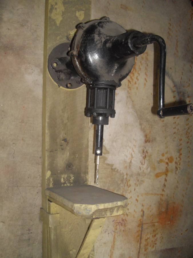

Have not seen this style of drill press before.

Two thoughts come to mind:
- How is it lowered? Perhaps the lower platform raises up.
- I wonder if it needs thrust washers.

You were deceived by the incorrect fixture in the chuck........it should be a paddle. World's first model T milkshake machine..........

WOW! At my old age in the late 70's, and with my interest in Model T's & Model A's since I was a kid, I thought I'd seen just about every way possible to adapt Model T components to some other use other than automotive, but that drill press is a new one for me! I also had that same initial thought, as to how one would "press" the drill bit into the work, and then in thinking about it, the thought occurred to me; you don't necessarily have to press the drill bit into the work,....you can always press "the work" into the drill bit. I think a fellow clever enough to devise this Model T rear end "drill press" would certainly be smart enough to devise a drill press TABLE that would press "the work" into the drill bit! Maybe we're only seeing half of this unknown fellows creation,....maybe he used automotive jacks, or screw device(s) to push the table & work piece up into the drill! (???) At any rate, a very, very interesting adaptation of Model T rear end to some other purpose,...thanks so much for posting,.....harold

There must be some form of "lifter" to bring the work up to the drill as is evident on the retaining straps and the discoloration on the back piece.

Whoever made the drill press was really pretty smart. Old blacksmith hand operated drill presses were sort of the same design. My Grandfather had a blacksmith shop and we still have some of his shop equipment. People would use old differentials for stalk cutters, rotarty cutters and etc. I have been to many farm auctions and seen pieces and parts of T’s made into lots of of things but this is the first wall mounted drill press I’ve seen.

You can see that the mounting of the table allows for motion. Additionally there are rub marks on the back showing the travel of the table. It looks like a few inches.
I would imagine that the table was on some leg operated lever allowing for lots of "pressing" force. The drill would turn at a rather slow speed, great for large holes/drills.
I wouldn't mind having it in my blacksmithing shop. Where is it located?

It’s in Michigan’s upper peninsula. I was searching for T parts there since I’ll be up that way in a few weeks. I think he was asking $125
