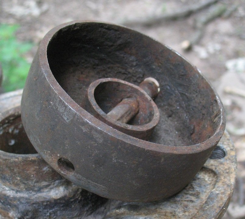

Post by Steve Jelf » Sun Jun 23, 2019 11:04 am
This is not in great condition, but it shows how the pin goes. The pulley has a small hole on one side to drive out the pin with a drift, and a larger opposite hole for the pin to pass through. The end of the pin near the larger hole gets a cotter pin, not a roll pin, to keep it in.
