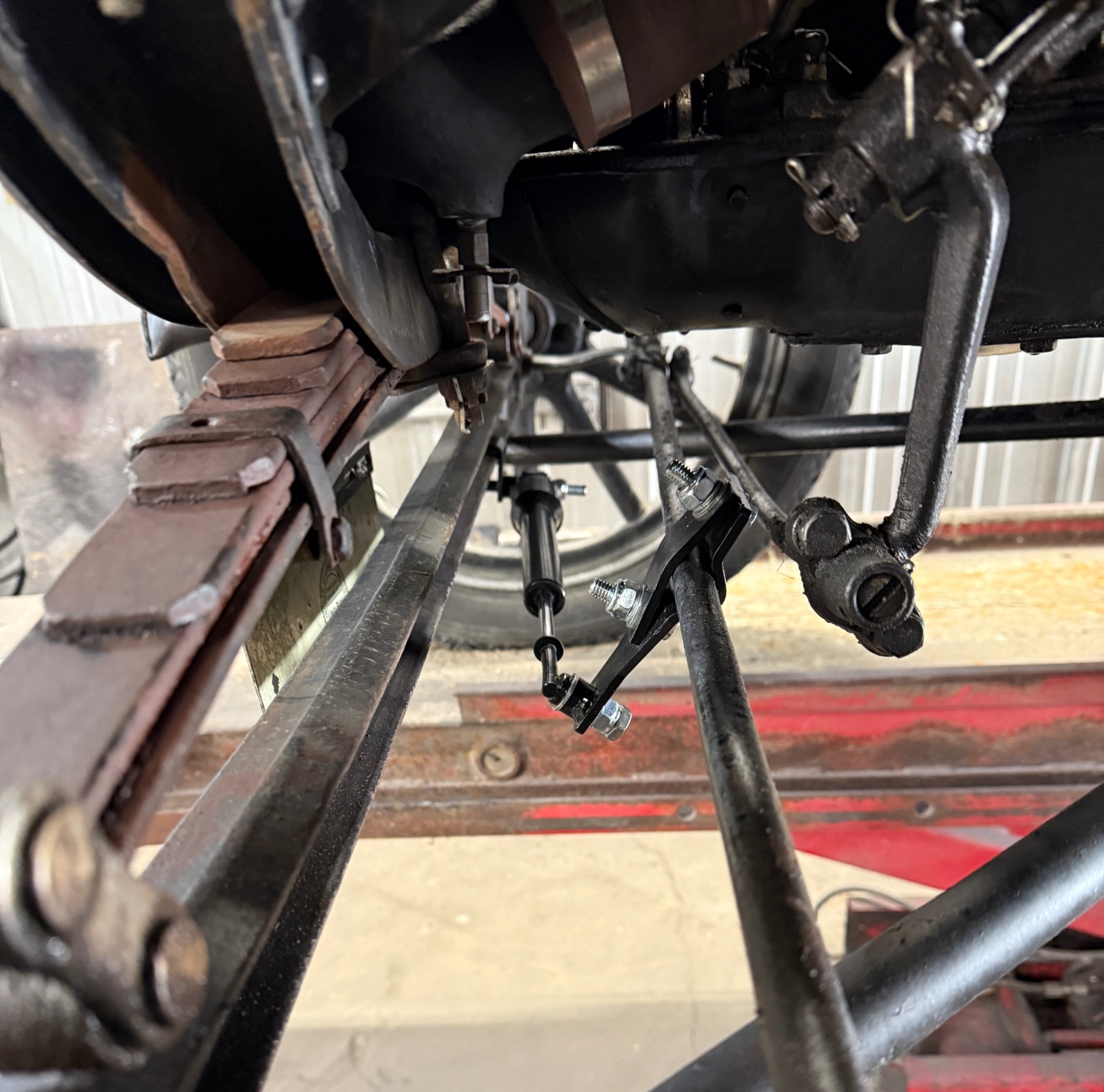

Finally got a break from other work and decided that the fix for my front end shimmy was to add the steering stabilizer. I also put the step plate on. i wanted to get the holes drilled before I decide that I will finally start doing some needed body repairs. I also installed a fan hub with the sealed bearing .

I'm glad you have the shimmy fixed, maybe you can drive that or the 27 runabout in the forest this summer? See you soon.

Yeah, I was at my wits end with the shimmy. I’ve been through the front end top to bottom and cannot for the life of me figure it out. This was my last ditch effort to solve it. I’m not a fan of it so much, but it has to be better than what I (we) experienced on the fall tour through St. Charles on the brick streets. The only way I could control it was to come to a complete stop and then start rolling again. The first time it happened was on the St. James overnight tour, that scared me being 100 miles from home. It sent me down the rabbit hole of new parts. I saw several cars struggling with the shimmy last year on the Trails Less Traveled tour in San Diego as well. It was pointed out to me that I will need to keep an eye on it, since it does add a stress point that the steering was not designed for. (Thanks Scott C). I gave it a lot of thought and decided that it was worth the risk. I’ll see how it does at the St Paddy’s day parade next week. I hope to see you there.

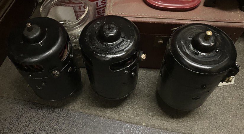

I rebuilt four generators for my cars. I didn't rebuild a fifth or more because I only had a 1919 brush plate and I ran out of parts. I replaced the 1919 insulators on the plate but am inclined to leave it on my shelf as a conversation piece. Generator #1 is already installed.
My job before retirement taught me the value of traceability so each rebuild is stamped on the pole screw with a number that's visible when it's installed. I created a spreadsheet that details the bearings, insulators, fields, and whether the armature was professionally checked.
