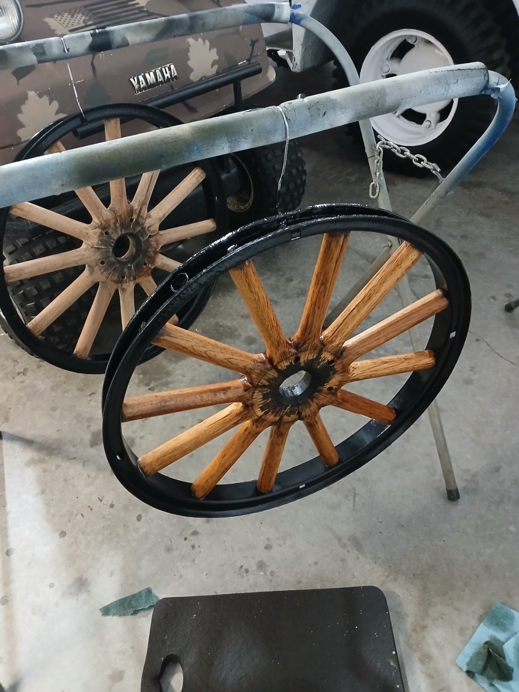

I painted my rims twice, with just a brush, and they turned out pretty well. After the paint dried, I started working on the staining. I decided to use watco teak oil and rustoleum/varathane varnish to protect them from the UV. I brushed on 3 coats of the teak oil with a bristle brush, being careful to avoid bubbles. I let them dry between coats for about a day. Before I started on the clear coat, I let the wheels dry for about 3 days. This cures the teak oil.
I brushed a total of 3 coats on the spokes of the clear polyurethane.
At this point visually, all 4 wheels were done, however I didnt feel comfortable with the left front wheel. I had noticed when I first took the wheels off that 2 tennons on the front wheel were starting to deteriorate. I was hoping the paint and stain would help rejuvenate the wood and harden it up to a useable spoke. For a week or two I was trying to lie to myself that it would be okay. I almost kept it the way it was but I just kept thinking about it and I decided that it was best to just replace those two spokes. They were a little bit loose and shrunk in the fellows so I would have had to do something anyway but I feel better that I decided to replace them. I was worried that two different spokes might make the wheel out of round or make it crooked or wobbly. I first tried to find a couple of good used original Spokes in some of my grandpa's old stuff. I found one that cleaned up quite nicely but the tapered end was cut on an angle and sat crooked. I was hoping that the old spokes would help blend in and not be noticeable, because I was trying to go for a medium finish without completely taking out 100% of the imperfections in the wheel. I worked on the two spokes for a week or two before I decided I better just buy a couple new ones. I'm glad I did I feel a lot better about it in hindsight.

Once I got my new spokes I sanded them and varnished them with the teak oil and clearcoat. I drilled the holes for the hub bolts and installed the hubs. I am happy with how the wheels turned out and unless you look close the two new spokes look pretty much like the old spokes. I should add that I decided to buy another can of teak oil mixed with stain to help blend in the new spokes with the old. It worked out relatively well. Around the time I was waiting for all of the finishing to dry I cleaned the outside of my demountable rims and brushed two coats of aluminum infused paint on the rims. They turned out well and look pretty nice in my opinion. I cleaned off a little bit of the paint that got on the tires with a dab of brake cleaner. I also added discs on the rear wheels in replacement of the drum because I am adding disc brakes on my car. I torqued all of the Hub bolts to roughly 45 lb. I mounted my tires on the wheels and did a couple of small things like experimenting with polishing a few of my hubcaps and called it good at that.

Aside from a few smaller things, my wheels are done and ready to roll. :roll: I enjoyed the process and found it challenging and a good learning experience and I learned a lot. I encourage anyone else who is not trying to build a professional restored car to give it a go. I was quite intimidated by the idea at first especially when I took out the hubs, but I feel better about doing it again. I have mounted both of my front wheels and installed new bearings they are whisper quiet and roll as straight as a Model T wheel can roll. With with all of my supplies, teak oil, polyurethane, brushes, paint, hardener, and paint prep I had a little over $100 invested in my wheels. If I would have had to buy new hubs that would have up-ed the price but I was fortunate enough to acquire a few used hubs. It took more time than anything but hopefully now they will be good for another 30 years. I have yet to drive a foot with the new wheels and it will be interesting to see how they age, I won't promise anyone that this is a tried and true way of doing it but at least it gives you some ideas if you decide to do it for yourself.
