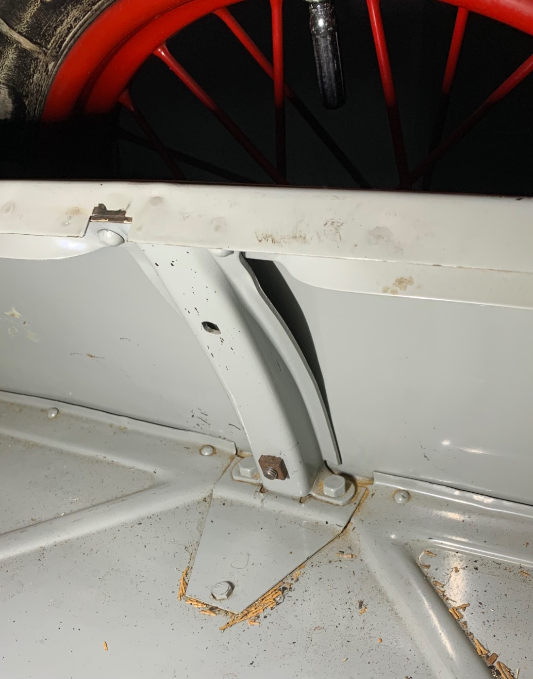

Re: 1926-'27 Roadster Spare Tire Mount (Ford Wire Wheel)
Good friend from another state sent me a picture of the inside top attachment of that spare tire carrier. He did not have picture of the lower attachment but I'm sure it's very similar with the thick rectangular block, lock washer and nut to secure the bolt.

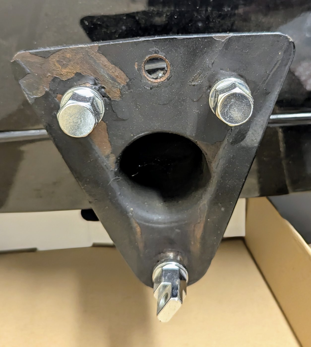

Just to pile on, this is what my ‘27 Runabout spare tire mount bolts look like.

- Posts: 5470
Great photos, Eric !
Here is what I have on my 26 it is a three holer with a brace on the inside and one under the floor attached to the framework. Jim

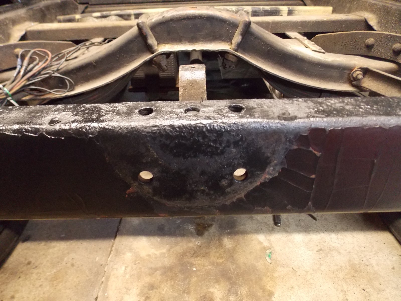

Pat the body had 3 hole mount we filled them I didn't want a spare tire mount on the car for the Montana 500. Here is a picture of the body in the body shop.I carried the spare in the trunk.
