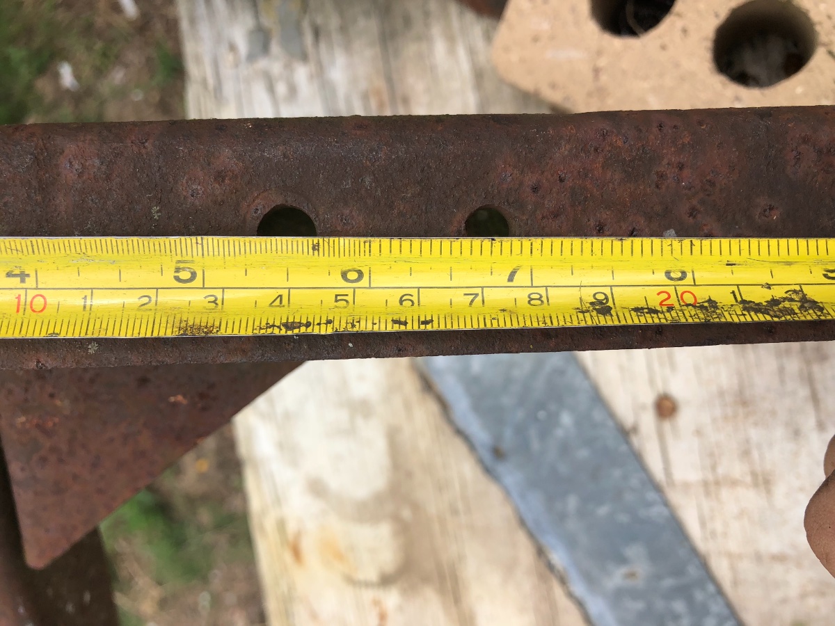

Re: 14 Help Please, Radiator/Fenders don't align
Here’s an early frame I have and the holes for the bolt and hood hook are 5 1/2” then 6 3/4” from the front.
Ben Umberger
Topic author - Posts: 35
- Joined: Sun Jan 06, 2019 12:43 pm
- First Name: Ben
- Last Name: Umberger
- * REQUIRED* Type and Year of Model Ts owned: 14 Touring, 20 Touring, 16 Depot Hack, 17 Roadster 27 Touring
- Location: Clearwater, FL
Corey,
That helps, my frame holes match your measurement. Note My hood shelf is 3/4" behind the radiator, that must be a clue.
