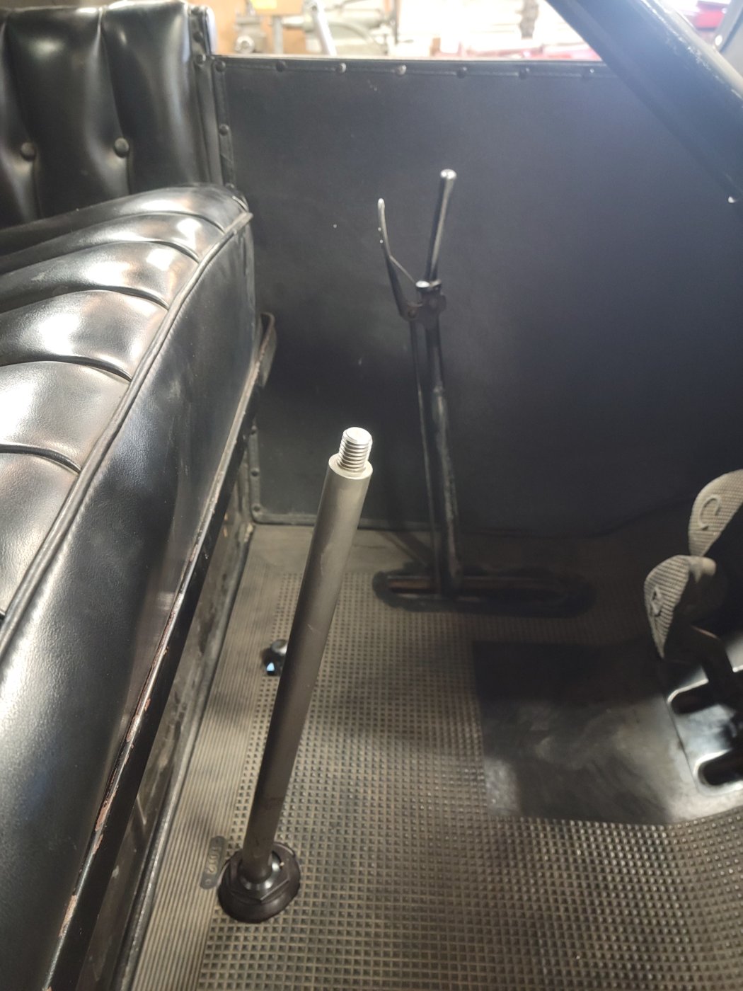

I'd like to fabricate a shift handle from a Model T part. I need idea's!! I don't want something to big a clumsy. Lamp part, trans part, carb part, anything.

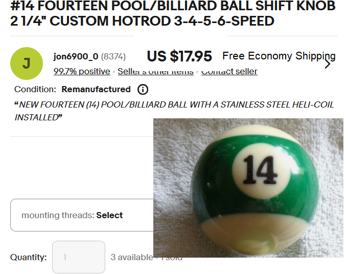

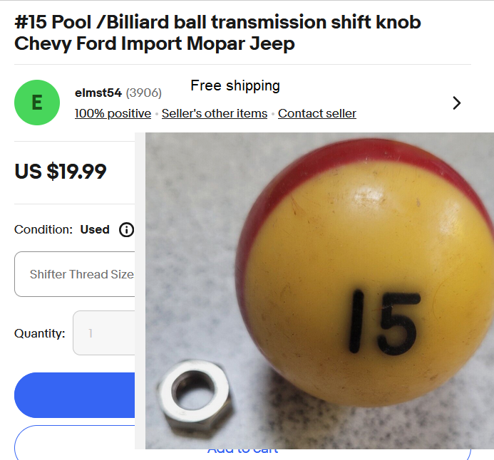

Used in all my daily drivers since 1965. If you decide to use something that needs to be filled and tapped... Get a nut that fits the shift shaft & fill with Durhams Rock Hard Putty. You might press a bolt (wrapped with Teflon tape) with the nut into the putty and remove the bolt when putty hardens.
Could use Bondo too but the putty flows more easily

What year is it for - see eBay

I choose Noel's idea. I did like the walking stick handle with a Liberty dollar also, just not a T part.
