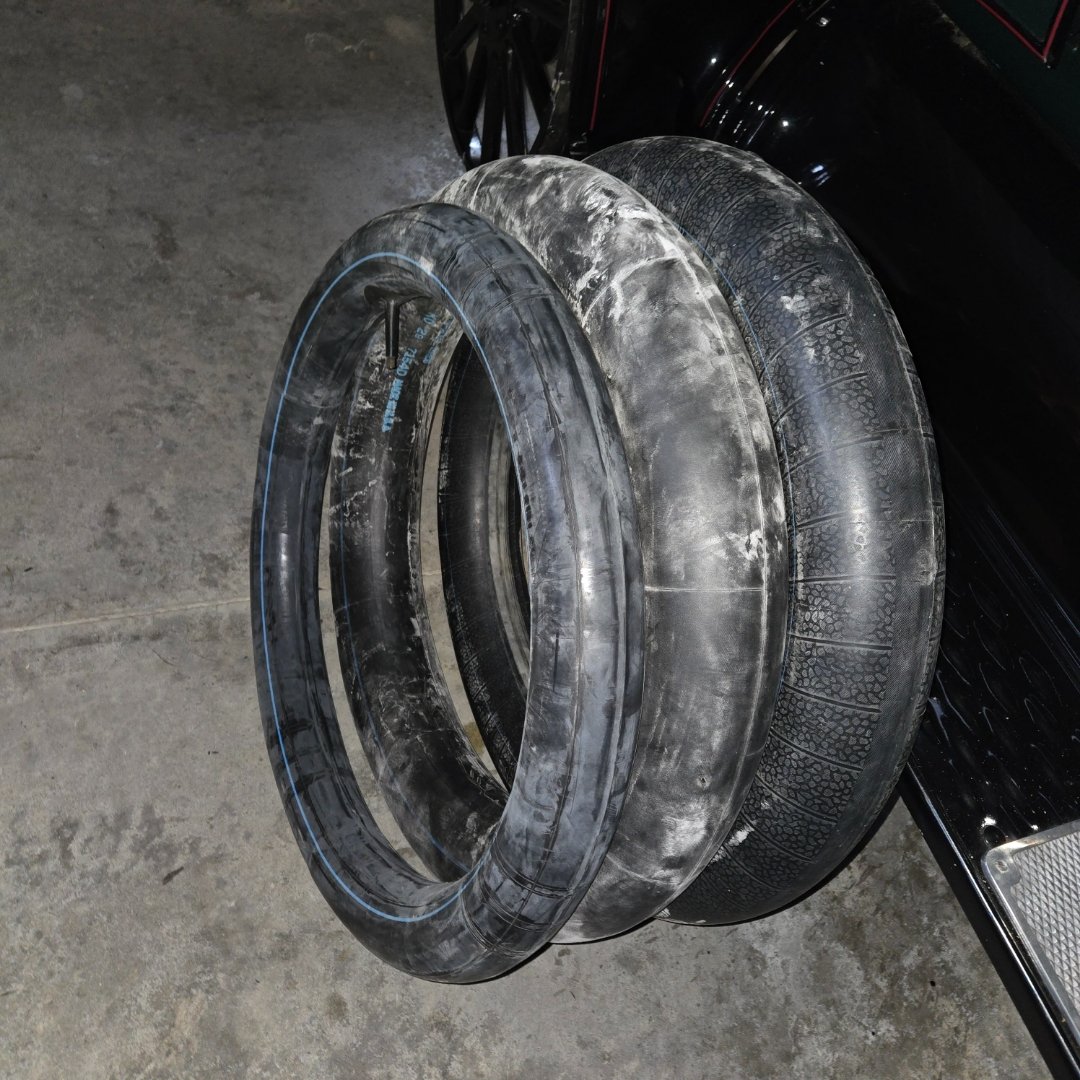

Recently purchased from vendors. All marked 440/450-21. Same air pressure on all. All different. Am amazed at the disparity.

Hard to tell in the photos. But the seam patterns and rubber texture seem to be different on all three. They could still be from the same supplier, and even the same manufacturer. (Maybe?) However almost certainly from different batch runs.
Innertubes without a tire to restrain them, air pressure doesn't mean much. The rubber stretches at a very low pressure, and different qualities of the rubber have some stretching a lot more than other.
Folds in the innertubes exposed to the air often crack around the outer edges of the fold (due to atmospheric contamination, and exposure to UV). I have seen new innertubes go bad in less than two years while sitting in the dark back clean area of the shop. It is caused by the stretched outer edge of the fold stretching the rubber and making it more vulnerable to the air contaminants. For that reason, I usually keep spare innertubes aired up to prevent folding. Spare innertubes kept that way in the dark makes them last longer. Inside a spare tire is even better.
The point of that previous paragraph is that the innertube rubber stretches easily, and a lot. A given "pressure" of air inside will make some innertubes stretch to a very large size, and the same pressure in a different innertube likely stretch only a very little.
For many years, I had a spare innertube that I aired up for storage. Three quarters of the way around the tube hardly stretched at all. To make the tube barely firm on that three quarters (barely four inches diameter), the small amount of pressure required had the other quarter stretched out to about ten inches diameter. The stretching quality of the rubber in the one innertube varied that much!

Before I pumped in 5 psi, the tubes were similarly disparate in physical size when recently received new out of the package.

I'd say this is a perfect indication of the quality control exercised in the production of tyres and tubes today, if these are the same brand from the same supplier,{not the vendor] Would these be acceptable to motorcyclists? I think not.

What are the brands of the tubes?

No brand markings just the size marking. These were purchased recently from current Model T vendors who are not at fault for the disparity. I suspect the tubes are foreign made. I have used Hartford tubes, very good quality.

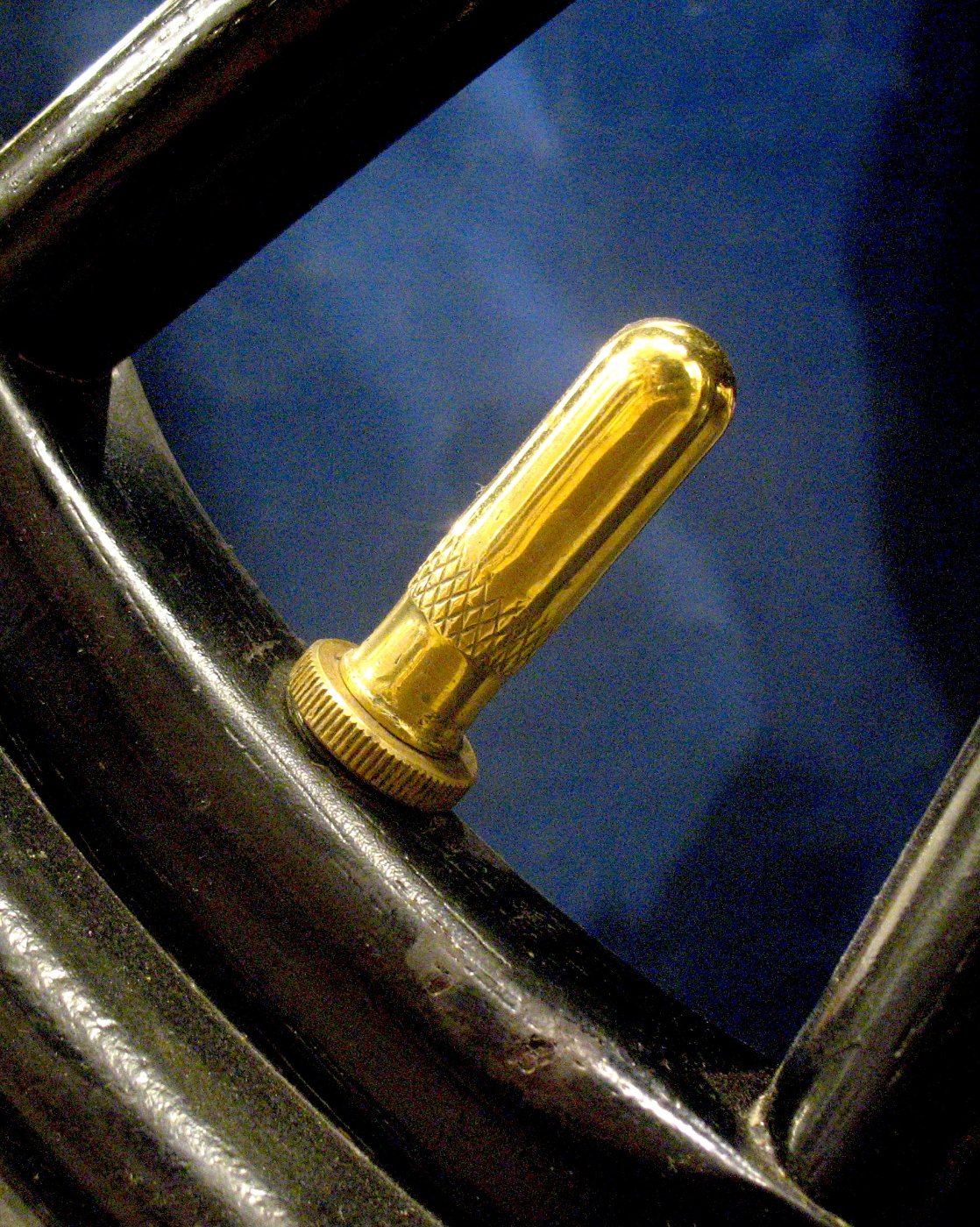

As far as I know all tubes sold with metal stems these days have the "wrong" size stems, which are larger than the ones Ford used on the Model T. I don't see that as a big problem because so many of the available covers and nuts, original or new, fit them just fine. Yes, the stems and covers on my car are "too big". I lie awake all night worrying about that.
