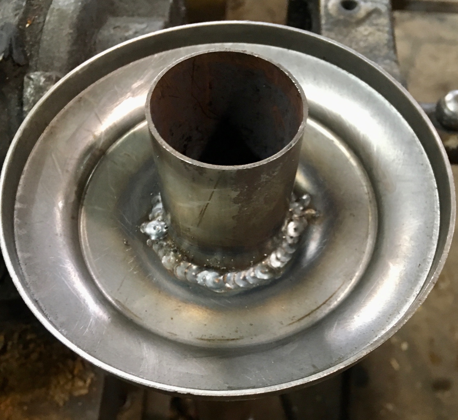

Because inquiring minds want to know. Here we go.
repo muffler broken down.
engine side muffler end needs the ID shrunken to accommodate the original pipe bead because it is designed to be a slip over. Just flip the inner pipe around backwards.
weld it.
cut the excess off.
nice and flush and smooth.

It may not be the way FORD did it, originally, but you seemed to have made it work.

Great job!
Posts: 7279
Re: Original exhaust pipe?
Post by Allan » Mon May 05, 2025 9:42 pm
Neat work Bryant. Your short length of pipe in the front cover allows it to mount exactly like Ford did it. You should use a heavy, slightly dished washer on the back end when assembling the muffler. This will spread the load over the whole inner "bump" on the end.
To my eye the materials used in the making of the end covers and the mounting bracket at the rear are lighter weight than the originals. Am I correct in this? Some original ends I have discovered seem to be pressed using TWO thicknesses of lighter material. Is this another example of Henry using scrap from other areas of manufacture?
The scoring marks around the outer flange on the ends indicates that they are pressings. i have mine made by a metal spinner using heavier material. The brackets are heavier too. On Canadian mufflers there is a deflector to direct gasses to the ground in front of the rear axle. This deflector is of lighter construction.
