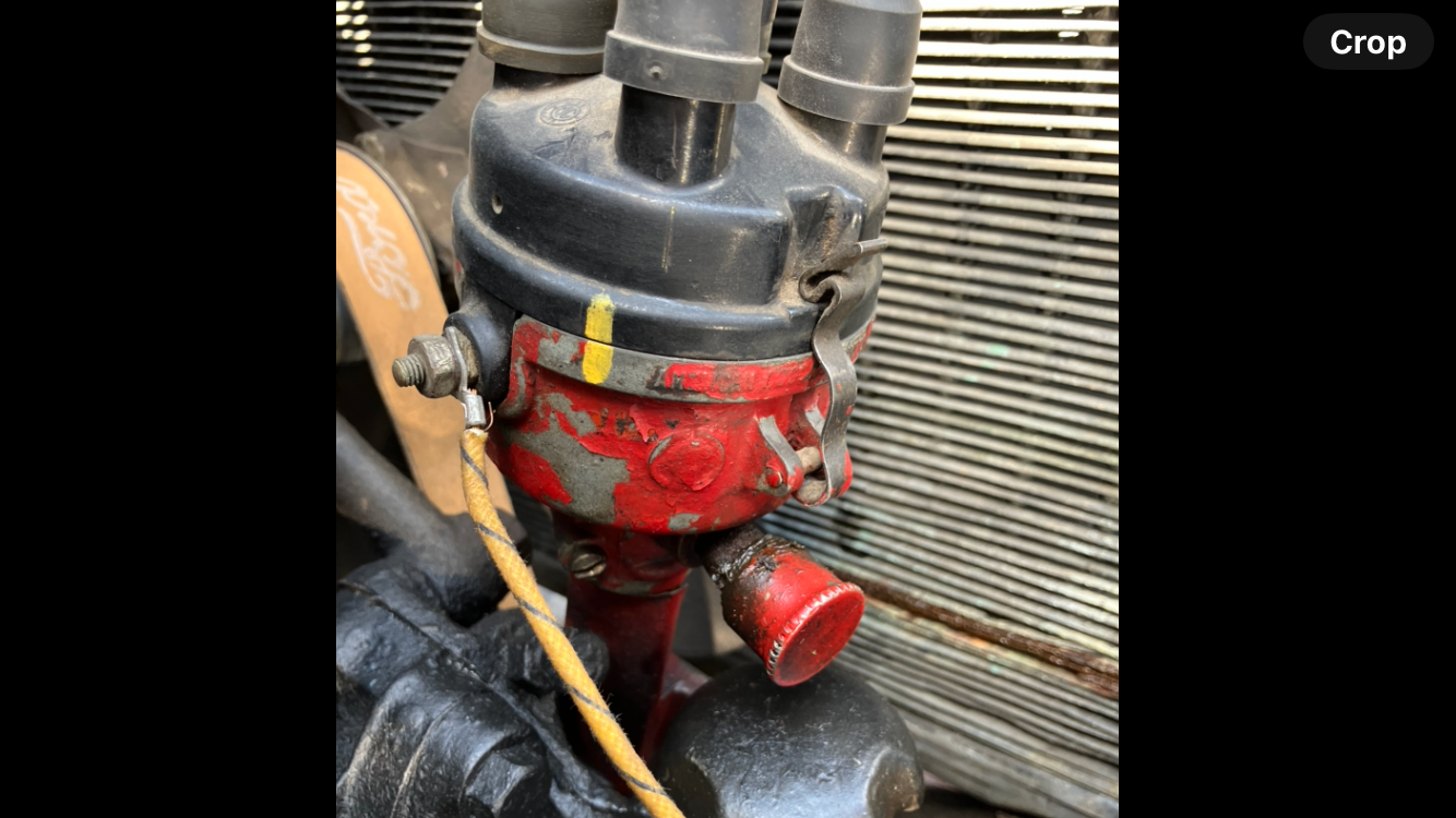

What distributor do I have?
Post by Modeltmike » Wed May 14, 2025 7:27 pm
Just bought a car with a distributor. Not sure who made this one. It is not connected to the timing lever. Should it be or does it have weights? Are tune up parts available? Thanks

Bosch. At least the cap. I bet the whole deal.

American Bosch Magneto Corporation. If you scrape the paint off the logo below the Magneto Corpn lettering in the last photo that's the Bosch Red Devil/Camille Jenatzy logo.

Take the cap off and try and move the rotor by hand see if it springs back or if it is solid. If it springs back it has weights and advances.

That is a 600 series Bosch distributor. Search https://www.mtfca.com/discus/messages/1 ... 1283107846 & you will get most
all the info you will need. They where the standard for distributors in the day. New parts are not available but the originals are pretty durable
Most are centrifugal advance & some centrifugal advance have a arm on them for additional retard when starting. The three issues most found
are lack of lubrication @ the shaft & contact rubbing block & miss aligned gears. If the shaft is loose but otherwise in good shape the body can
be bushed. If the contact rubbing block is worn to far to set the points the adjuster can be machined to get the needed gap. There is a article
on installing Pertronix electronic ignition in the forum. According to the info a model T coil can be used but I have not tried that yet.
If repairing the mag is not in the near future then running a distributor or the T coils on battery is the go to solution.

It appears to be an American Bosh 600 but not sure which version. Both had centrifugal advance. The distributor cap does NOT appear to be an original cap but my guess it works. The original had a tab on the bottom of the cap to index it properly. Yours appears to have yellow markings. In any case Distributor Caps for the American Bosch 600 are in demand and a "will fit" would be of interest to users as well as the rotor being used. Can you see if there is a part number on cap & rotor also pictures of the what is on the plate inside the head. NOTE VW Bosch parts will not fit
A bit of Google search shows a American Bosch 600 with a Magneto Corporation distributor cap with number 65942 on the top and 47-5 on the inside. Now a new search begins
